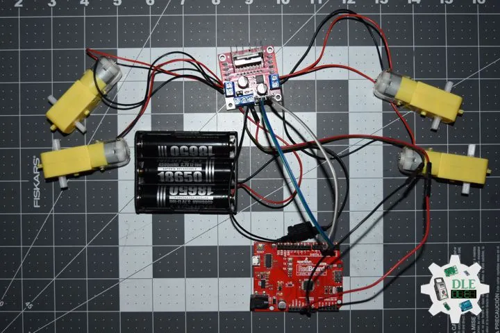

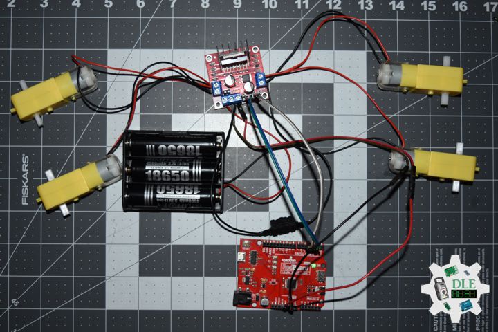

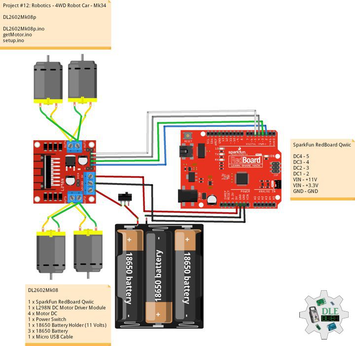

4WD Robot Car uses SparkFun RedBoard Qwiic as the main control board and is combined with L298N motor drive board, forming a powerful intelligent mobile device. As for L298N motor drive board, since it provides stable power output and flexible steering control, it is responsible for driving wheels.
DL2602Mk08
1 x SparkFun RedBoard Qwiic
1 x L298N DC Motor Driver Module
4 x Motor DC
1 x Power Switch
1 x 18650 Battery Holder (11 Volts)
3 x 18650 Battery
1 x Micro USB Cable
