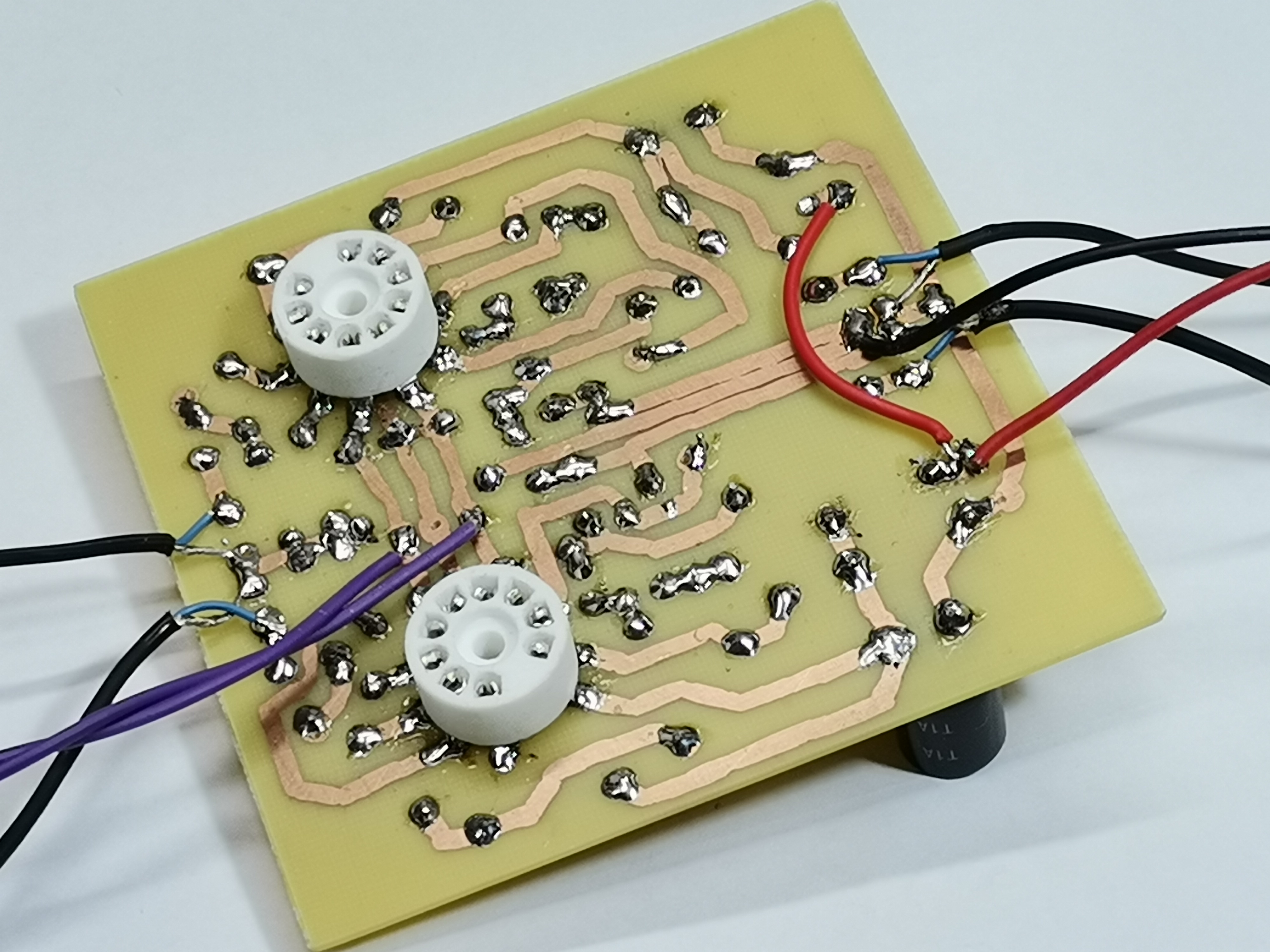

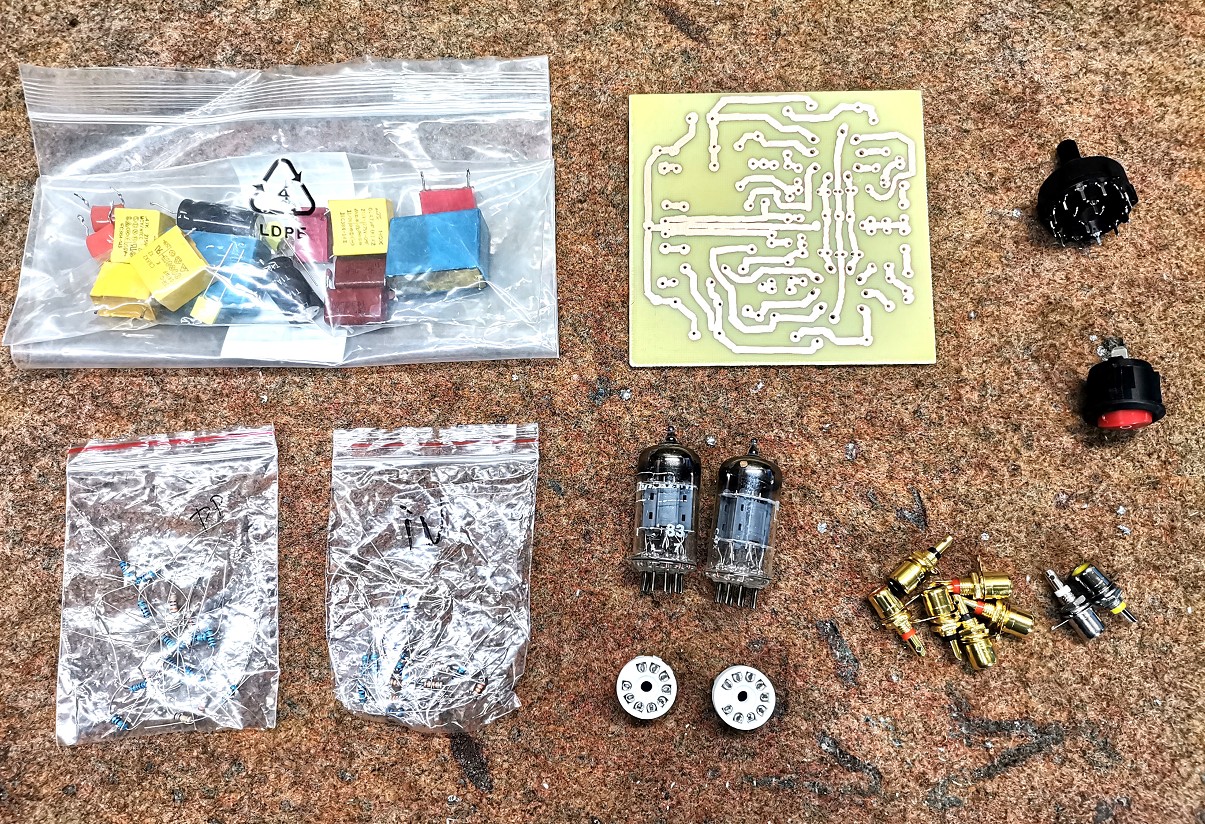

The original project contains a number of characteristic elements that are relatively difficult to obtain, but I tried to replace them with standard available components without major losses in quality. At the end of the text, the original circuit diagram for one channel is given, and the other channel is identical. I made the PCB for this prototype like in the old days by drawing with a permanent marker.

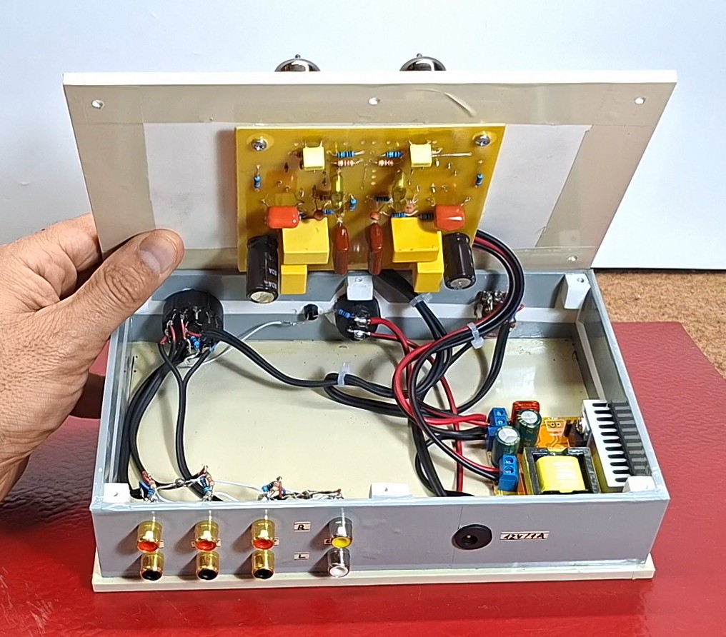

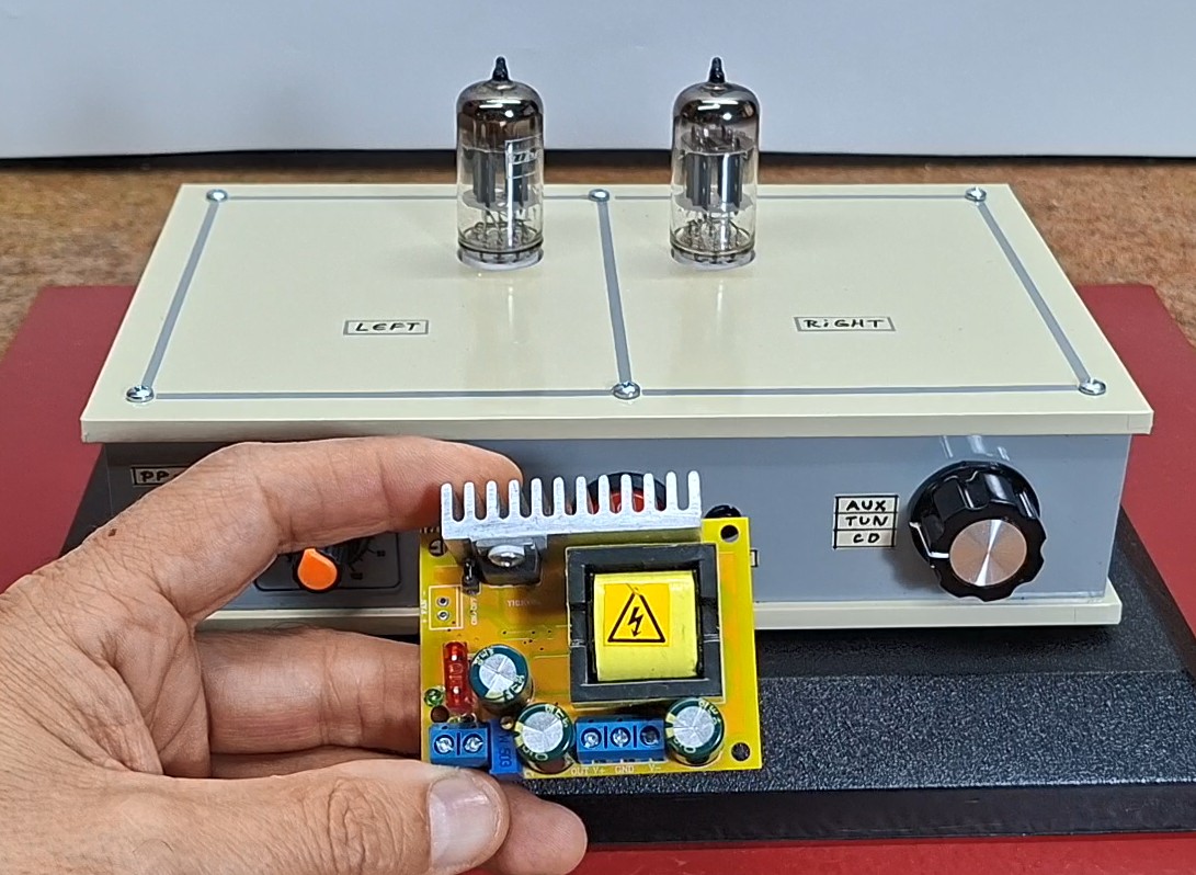

In almost all tube projects, the most difficult part to purchase and make is the power supply stage. This project in particular uses a 250V DC power supply plus 12V for heating the cathodes of the tubes. I solved this in a very easy and elegant way with the help of a cheap DC-DC boost converter.

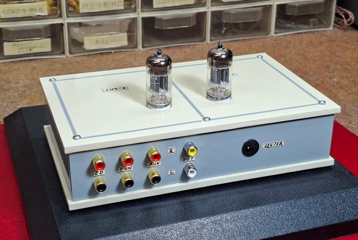

The coaxial cables used should be as high quality and short as possible. For the same reason the voltage dividers are made directly on the input connectors themselves. I use a 2x6 switch to select the inputs. The original project contains an attenuator instead of a potentiometer, but for the sake of economy and simplicity I decided to use a potentiometer.

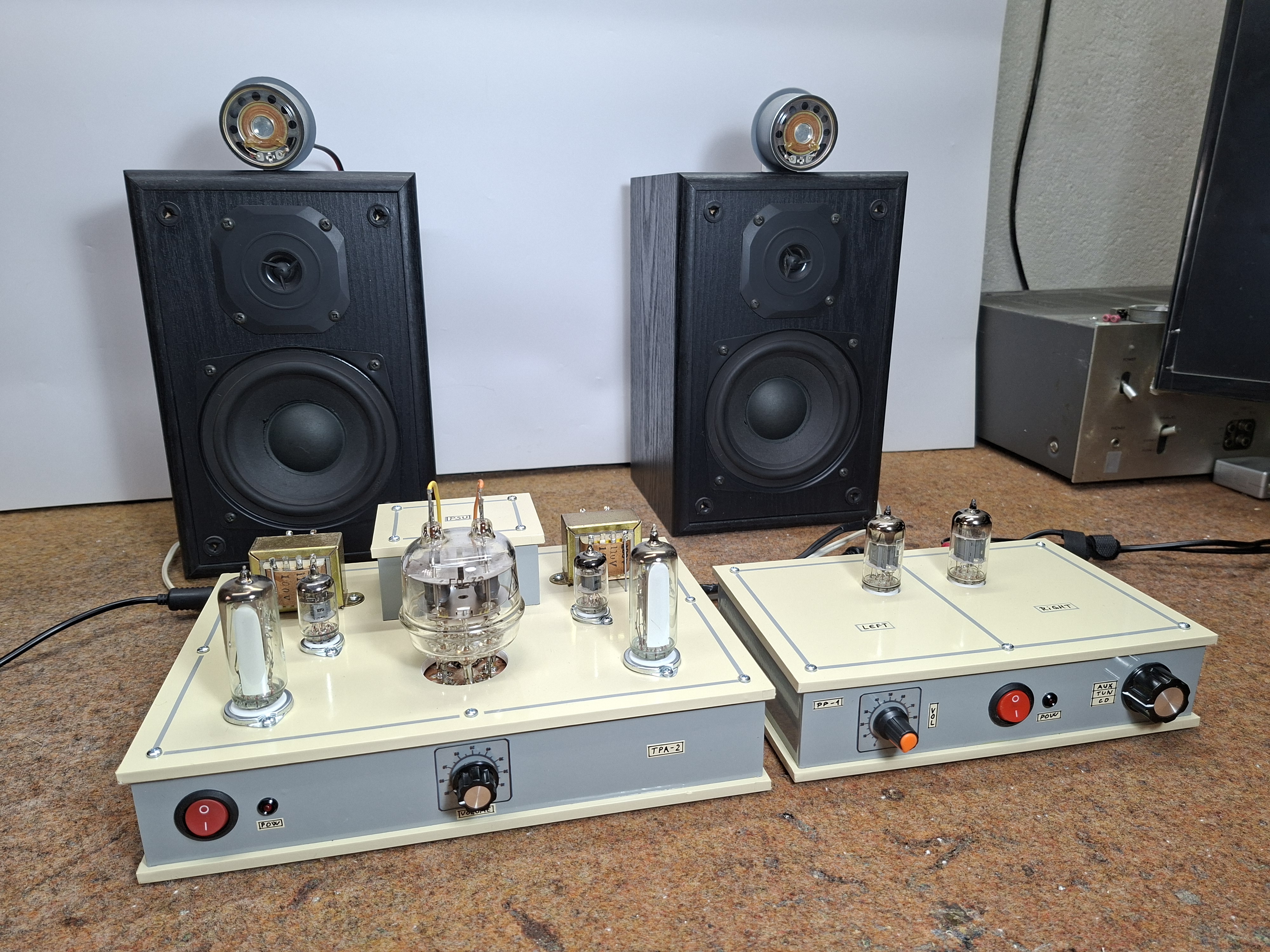

 In this presentation I use an output amplifier with a GU32 Tube, shown in one of my previous projects. The source of the audio signal is my PC. I must say that I am very pleasantly surprised by the difference in sound when I feed the signal from the PC directly to the Power Amplifier, and through this preamplifier. This is probably due to the adjusted impedances between the preamplifier and the output amplifier. Although I am not using quality audio grade capacitors for now, the sound is, in a word, wonderful and it is really worth your while to make this Preamplifier as part of your audio system. Here is really expressed that soft, pleasant sound characteristic of vacuum tube audio devices. I even tested it as a preamplifier stage of a modern integrated amplifier and I can conclude that it greatly colors the sound, bringing it closer to the Tube sound.
