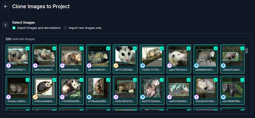

First is the object detection. I started off with a site called Roboflow. It had a nice dataset setup but seemed to want me to make calls online, which isn't much of an option over in the chicken coop far beyond the reach of our wifi. So, I opted to do the training locally. Turns out, that meant a week and a half of training each night. I may have gone overboard on the data augmentation... Either way, the model I trained is available within this project. It focuses on predators that I am confident are within my area. Unluckily, we moved to an area that has quite an extensive list in that regard. The model focuses on coyotes, foxes, hawks, opossums, raccoons, and snakes.

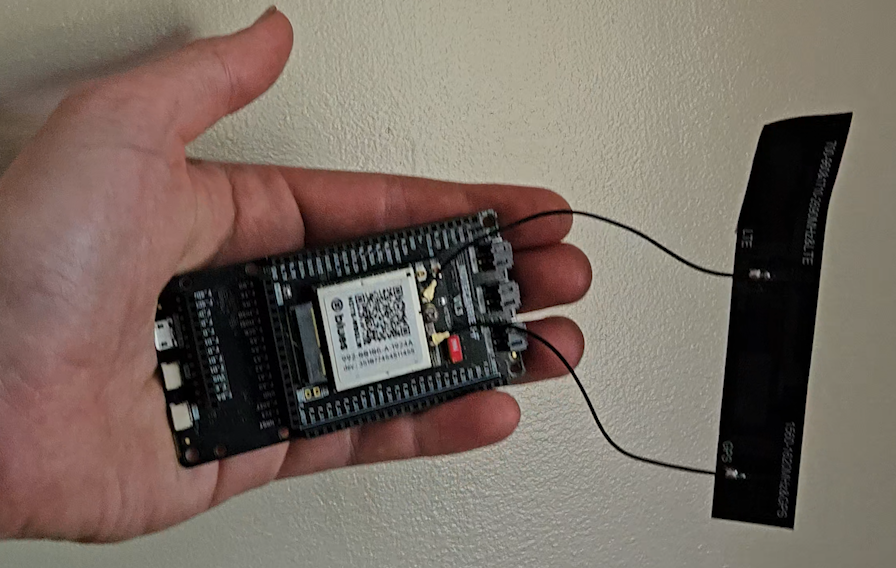

For running all the features we're putting together, we're using a raspberry pi from PCBWay. Part one, as discussed, is identifying the predator, so we have a very standard USB webcam for that. Next up is playing the audio, which just uses a USB speaker. After this, we get a bit fancier. To alert us of predators, we need to get data back to the house and to do something with it. For this, we're going to use Blues Wireless. I've been using a Notecarrier-F for some products that leverage Blues and I've grown quite comfortable with it, so that's what we're using here.
As far as hardware assembly goes, everything (including the Notecarrier-F) is plugged into the raspberry pi via usb. You'll notice that during the project development phase that means 3 usb devices plus a mouse and keyboard for a total of 5 with only 4 usb ports available on the Raspberry Pi, though. I just used a usb splitter for the mouse and keyboard and had no issues whatsoever.

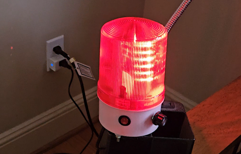

That takes care of our detection device, but as for how we communicate that there is a predator to those in the house, we sound a literal siren. The siren itself is very simple. It has an on/off switch and a volume knob. That doesn't do much for us, though, so to actually utilize it we're using a smart plug. As it turns out, some of these make life easy and others take a lot of effort as far as using them in this type of project goes. Of the ones I had around the house, the one that was easier to use was a TP-Link Kasa. It has a simple library I was able to leverage, which was so much easier than some of the other options I was looking into prior to finding it. With it, we can take our predator alert, turn on the smart plug (and therefore our siren) for a set amount of time before turning it back off. This gives us a very clear indication that a predator is attacking our chickens, all automatically.

With all the hardware in place, it's time to get into how it works. Thankfully, a lot of it is very intuitive based on what has been discussed so far. We have a YOLO detection model, and we use it to look for predators. I used YOLOv8, and all this training occurred on my PC. I did augment the data a bit, meaning that I included slightly altered versions of the training images to help improve the dataset. If I were to do this all again I probably would have skipped out on this; especially with blurring images (adding a bit of blur is an option when augmenting data, which made sense to me when factoring in movement and such). The end result I got has had some false positives for the brushtail possum, where it thinks blurs are an opossum. This can be rectified a bit by increasing confidence requirements for the brushtail possum in particular but, for anyone following along with the intention to train their own model, maybe train it without adding the blurrier images in the dataset. As far as training it goes, the dataset was well labelled from Roboflow including the bounding box for each animal, so all that was needed was to put a yaml file in the right spot so our training knew what data to process and where and to run the training.

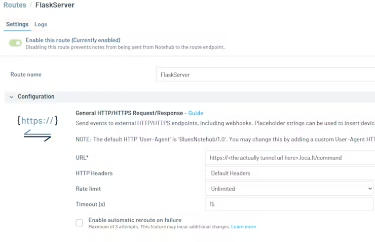

Step 4: Blues Wireless

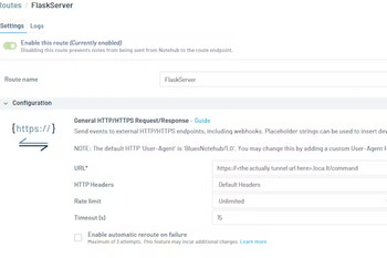

With Blues Wireless, you setup a route. I talk about this in the video, but one intuitive option for this particular project would be utilizing Twilio.
This is a texting service, which means that we could send an alert through Blues and receive a text saying that a predator has been detected. I did leverage this in one of my projects, but it requires a subscription and I have a more eccentric plan in mind.
I've been continuously adding to a custom Smart Home setup I've been putting together, so I'll be using that. Blues routes to our Smart Home, our Smart Home processes that a predator has been detected and does something with it.

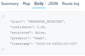

Of note, since the end goal for notifying us is with a siren, if I want to see the type of predator that has been detected I can easily check it out in the Smart Home logs or in the Blues Wireless logs.

Step 6: Activating the Siren
Once our Smart Home setup receives a predator alert, we turn on the siren. As noted, since the siren is a simple device, we use a Smart Plug to make this work with our Smart Home setup.

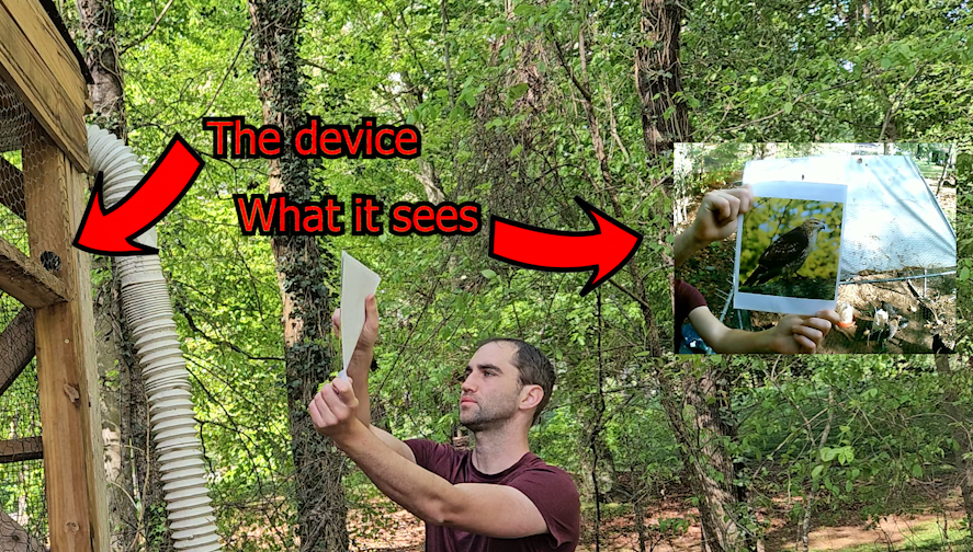

So, all that's left to do is put it out in the chicken coop and see if it can keep the chickens from harm!
I tested this out with a couple pictures of predators to see if it was all still working, and it was indeed. Unluckily, I did also end up with some false positives for the brushtail possum, as mentioned before, so I'll need to rectify that by increasing the confidence requirements for that animal in particular. That, or if I encounter other issues I may eventually retrain the model. As is, though, I'm pretty thrilled with how well it works.
