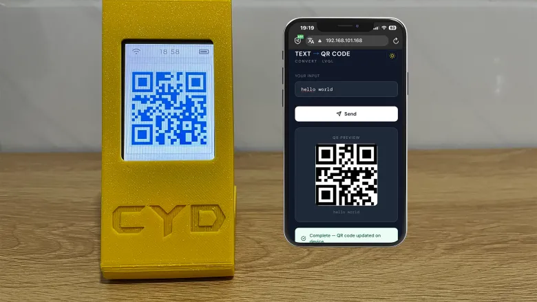

A practical reference project showcasing the integration of embedded UI, networking, and web interaction on the ESP32 platform.
Users configure WiFi directly from the touchscreen, while the device hosts its own web server accessible at esp32.local Or IP address. Any browser can push text or URLs to the device, and the ESP32 instantly generates and renders the corresponding QR code using LVGL all in real time.
Key Features
The home screen displays a live-generated QR code, a settings panel with brightness control, on-device WiFi scanning and selection, and a clean, responsive embedded interface built as a hands-on reference for developers exploring LVGL, async web serving, and ESP32 UI systems
