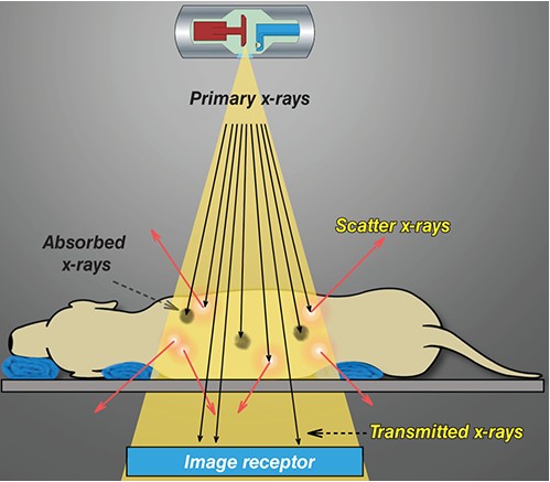

 An X-ray machine (or radiograph) is a quick, painless medical test that produces images of the structures inside your body—particularly your bones. It is one of the oldest and most frequently used forms of medical imaging. The process is based on a specific type of high-energy electromagnetic radiation. An X-ray machine produces a concentrated beam of X-ray photons. This beam is aimed at the specific part of the body being examined.
 As the rays pass through your body, different tissues absorb them at different rates depending on their density. On the other side of your body, there is a specialized film or a digital sensor. This detector captures the rays that managed to pass through you.

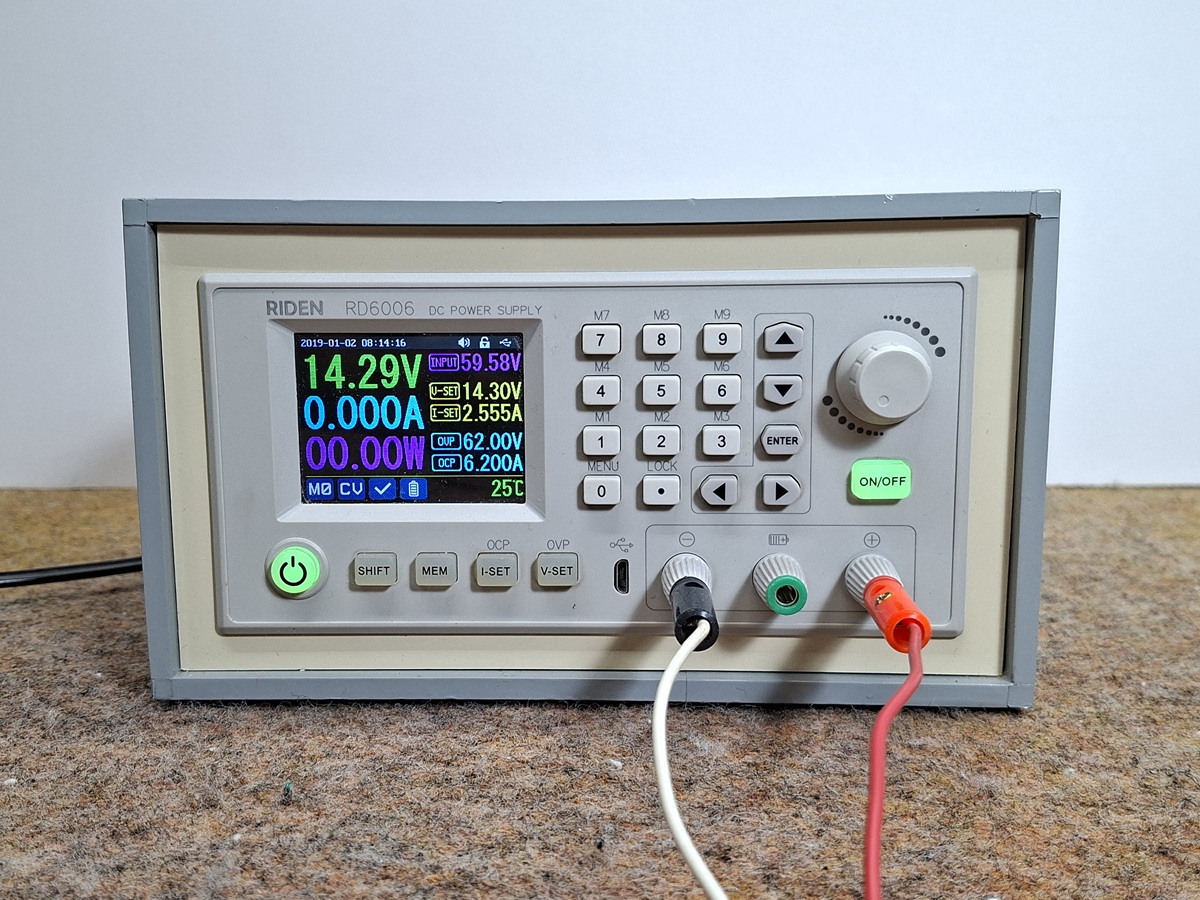

    - A source of low DC voltage, in my case a laboratory power supply, and a battery can also be used.

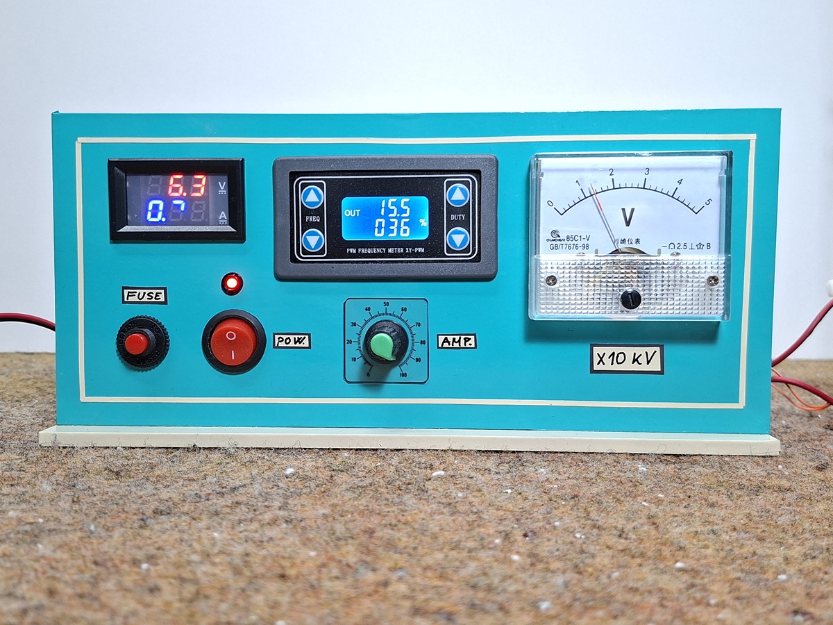

 - Then a high AC voltage generator, preferably with the ability to continuously regulate the voltage and current - specifically, I use this device from a previous project  of mine, which is ideally suited for this purpose.

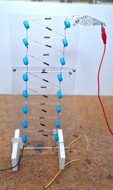

- Next is a Cockroft-Walton voltage multiplier, which rectifies and increases the input AC voltage from the line transformer. By the way, this multiplier is also from a previous project of mine.

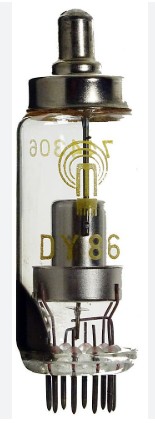

Тhe source of x-ray radiation, which in this case is a cheap DY86 rectifier vacuum tube from an old black-and-white TV.

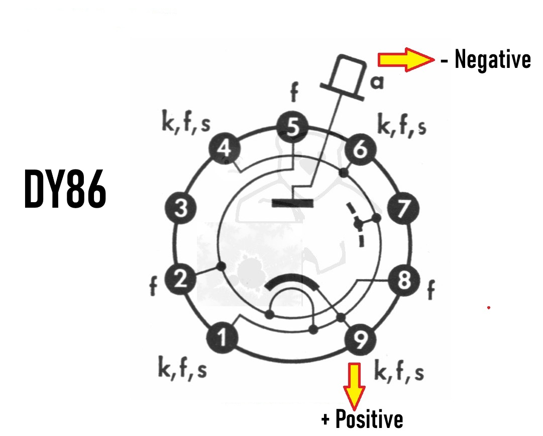

  In fact, this is the biggest advantage of this concept, since even the smallest dental x-ray tube costs several hundred dollars. The only downside is that the exposure has to last much longer due to the low radiation level, but in fact this is desirable in such dangerous DIY experiments. The DY86 tube is connected inversely, i.e. the cathode to plus and the anode to minus, which significantly increases its lifespan.
 Even when exposed lasts longer than 1 hour, the tube temperature does not exceed 30 degrees - that's why this is called a cold emission.
  - And finally, the medium on which the image is formed, specifically for that purpose I use dental film and appropriate chemicals for developing and fixing the image.

   My first goal was to make the DY86 tube start emitting x-rays. I had several flyback trafos from old CRT monitors at my disposal, which generate DC high voltage at the output. I also purchased 7pcs. DY86 tubes, 3 of which had lost their vacuum from standing for a long time. There is a trick to test the vacuum: with a plastic stick, we hit the glass of the tube, and if the sound is ringing, the tube has good vacuum, and if the sound is dull and muffled, that is a sure sign that the tube is unusable. Unfortunately, during the experiment I "managed" to destroy 3 Tubes and only with the last one did I reach the desired result. Namely, directly with a flyback transfo it is very difficult to make the tube emit X-Rays. In fact, at a certain point it may start emitting but soon after, due to the fact that the voltage in these transformers is too low, and the current is too high, the Anode quickly overheats and the lamp is then destroyed. The solution is a line-type HV transformer without a cascade that outputs AC voltage, to which a voltage multiplier is connected. In this way, very high voltages are obtained with low currents. Through experimentation, I found the "sweet spot" so that the highest radiation is obtained with relatively low consumption. This is very important considering that when forming the X-ray image, we have to expose the film for a very long time to these relatively weak X-rays.

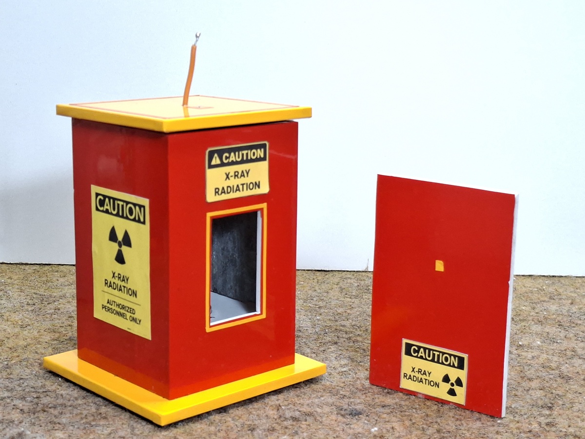

   And let me immediately mention that all protective measures should be taken because this is very dangerous invisible radiation that has very harmful consequences for human health. The tube should be surrounded by a lead plate with a thickness of 1mm or more with a opening on the side where the film will be located. We are also not allowed to stay in the room where the experiment is being performed. It is even preferable to turn the X-ray machine on and off remotely. Below you can see a short clip of the moment when X-rays begin to be emitted.
  Here is what the final version of the container that houses the X-ray generator, i.e. the DY87 tube, looks like.

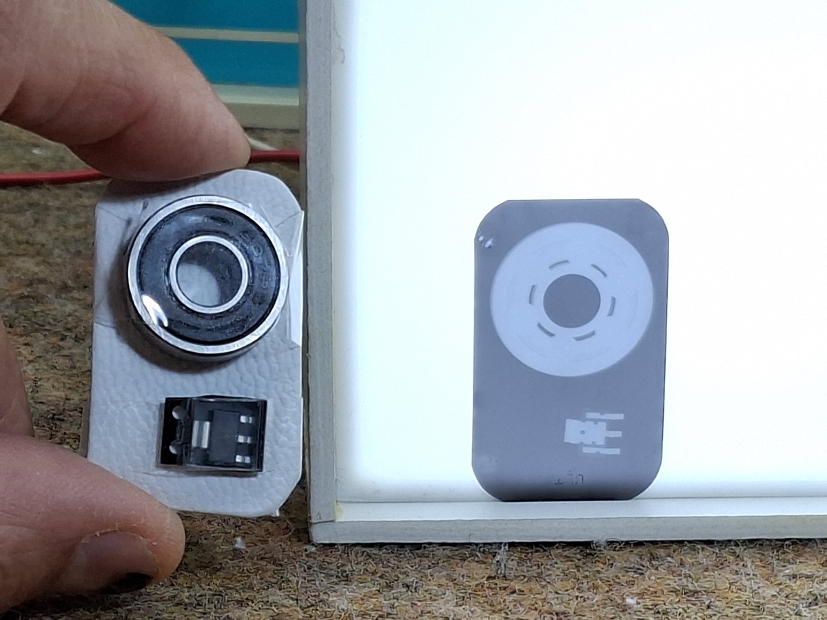

  On three sides there is a protective lead plate, and in front there is an opening of which the object that we are recording is placed. Since we are working with extremely high voltages, specially insulated wires are used, which also need to be spaced apart from each other, as well as from the shield. I place the object at a distance of 10 to 15 centimeters from the source and start the irradiation. The exposure time depends on the intensity of the x-rays and the distance from the source.
 Specifically, I get the best results with the following parameters:
     - Distance from the source 10cm (at that point the radiation has an intensity of about 200µSv)
     - and Exposure time from 30 to 60 min depending on the object we are imaging (for objects with thicker and more impermeable material the exposure is longer).

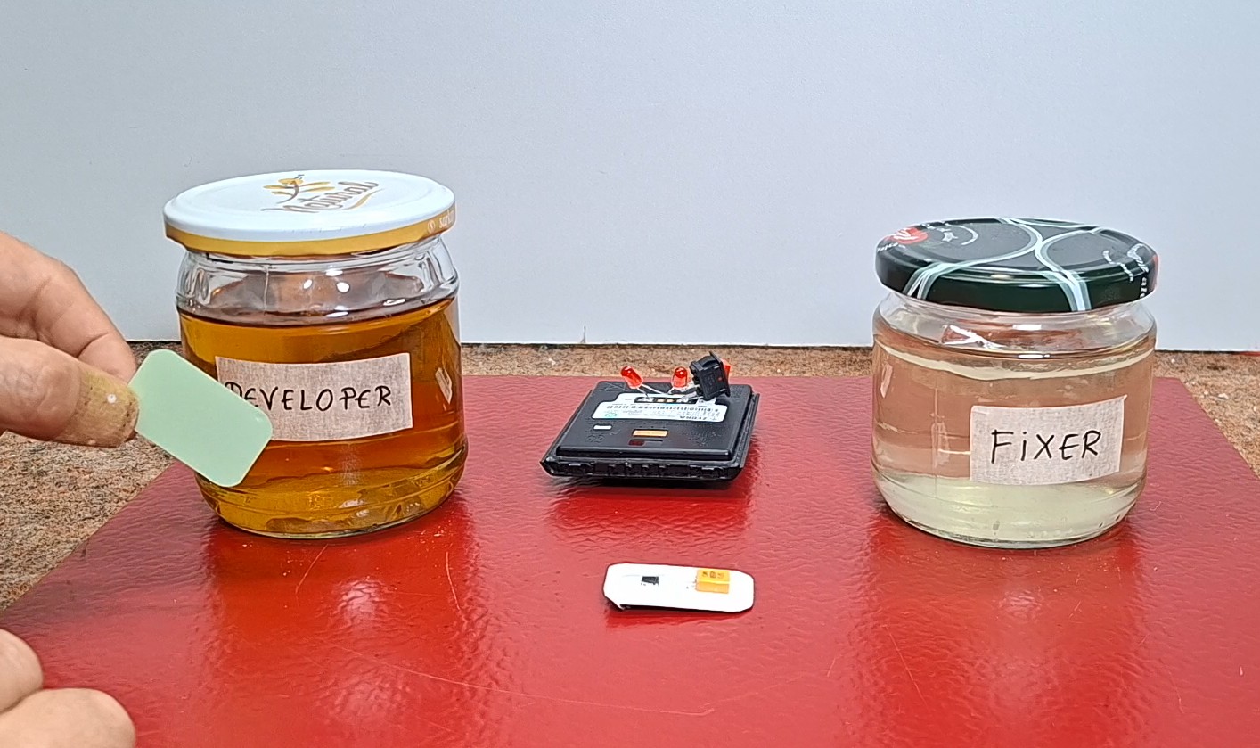

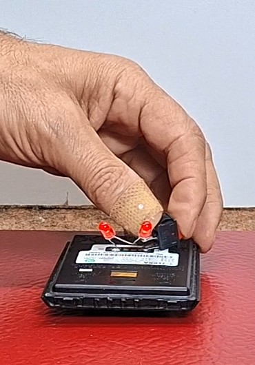

  When the exposure is over, we move on to film processing. This is done in a completely dark room, possibly slightly illuminated with a discreet red light source. For this purpose, I use 3 red 5mm LEDs.

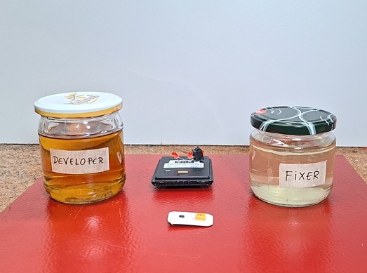

 I carefully open the film and immerse it in the developing solution for about 30-40 seconds. Then I wash it in water, then put it in a fixing solution for 2 to 3 minutes.

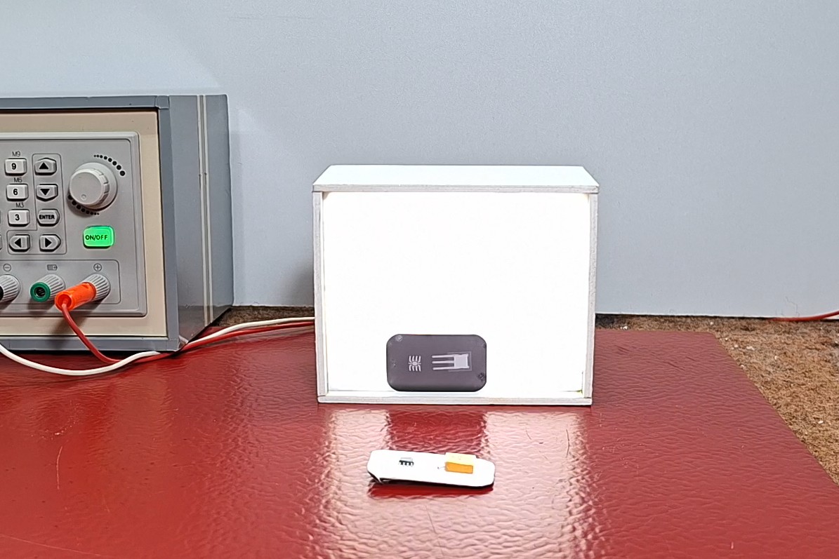

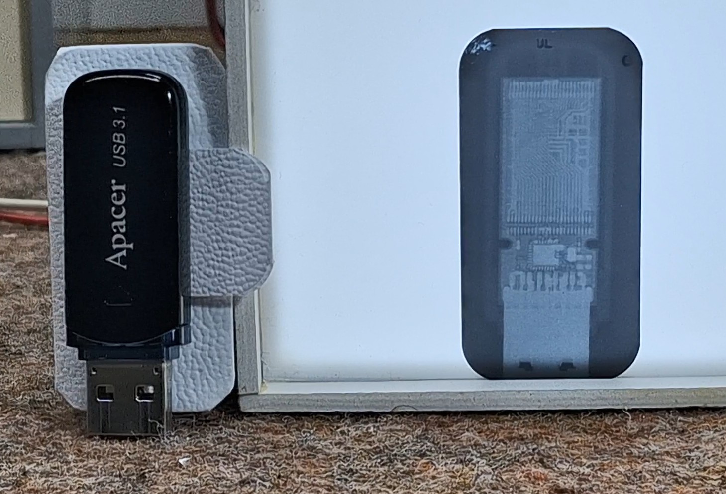

   After this, the film is no longer sensitive to white light and we can wash it well under a strong stream of water and let it dry. The processed films are best viewed when placed under intense white diffuse light. For this purpose I have made this small screen.

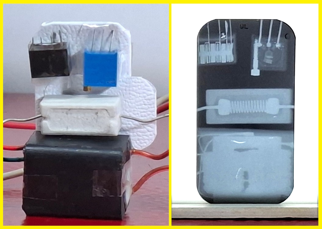

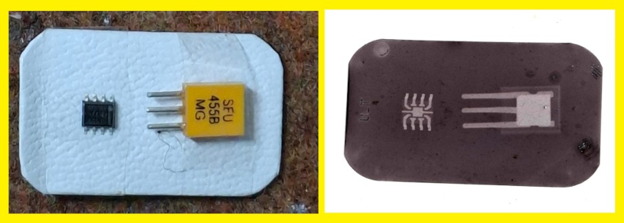

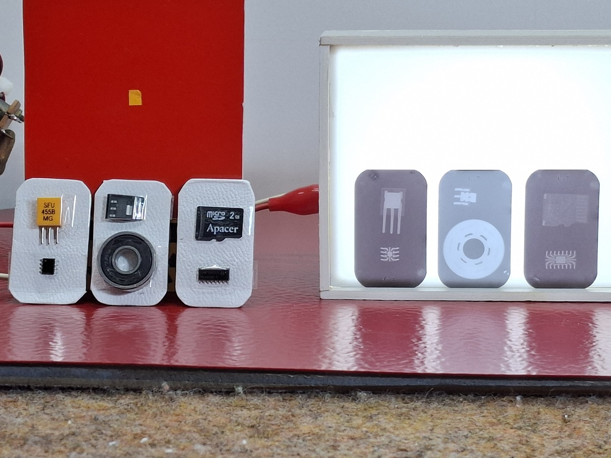

 Now you will see what some of the objects processed with this X-ray machine look like.
 And finally a short conclusion. This project successfully demonstrates how I build a low-cost, miniature DIY X-ray machine using a DY86 vacuum tube and a Cockcroft-Walton voltage multiplier.  By achieving precise control over high-voltage levels and radiation intensity, I can produce high-quality radiographs of electronic components using dental film.
