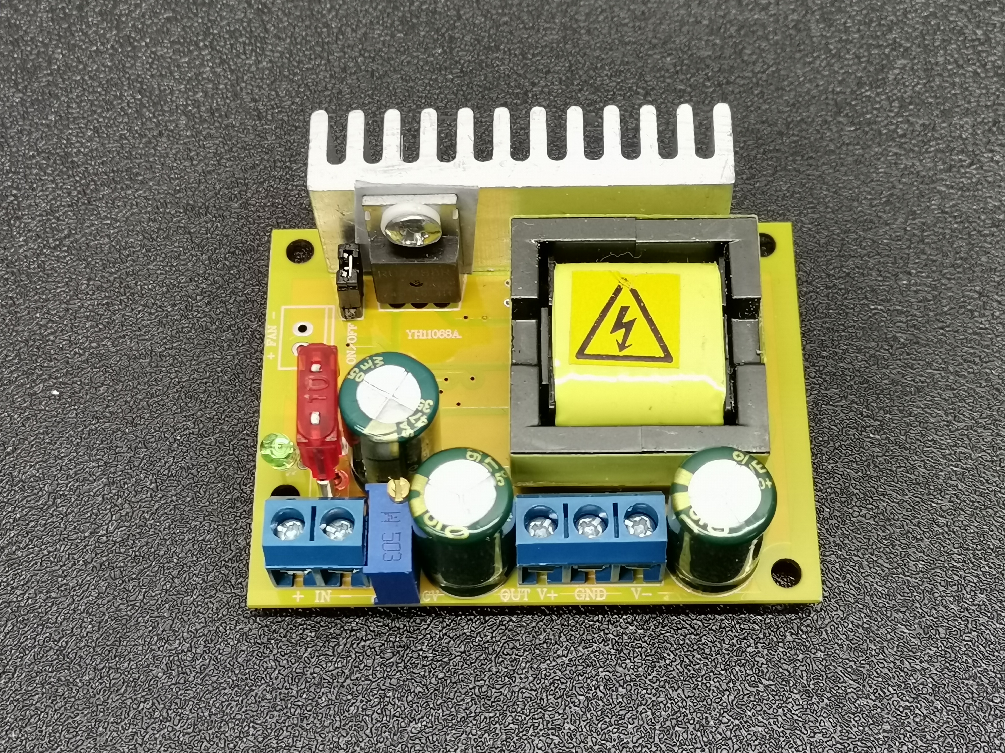

  First, let me describe the components used individually. The most specific component of these amplifiers is the mains transformer together with the rectifier. This time I use this cheap DC-DC converter that uses 12V input voltage and the output voltage can be adjusted from 40 to 700V.
   For the needs of this amplifier, the output voltage is set to 235V

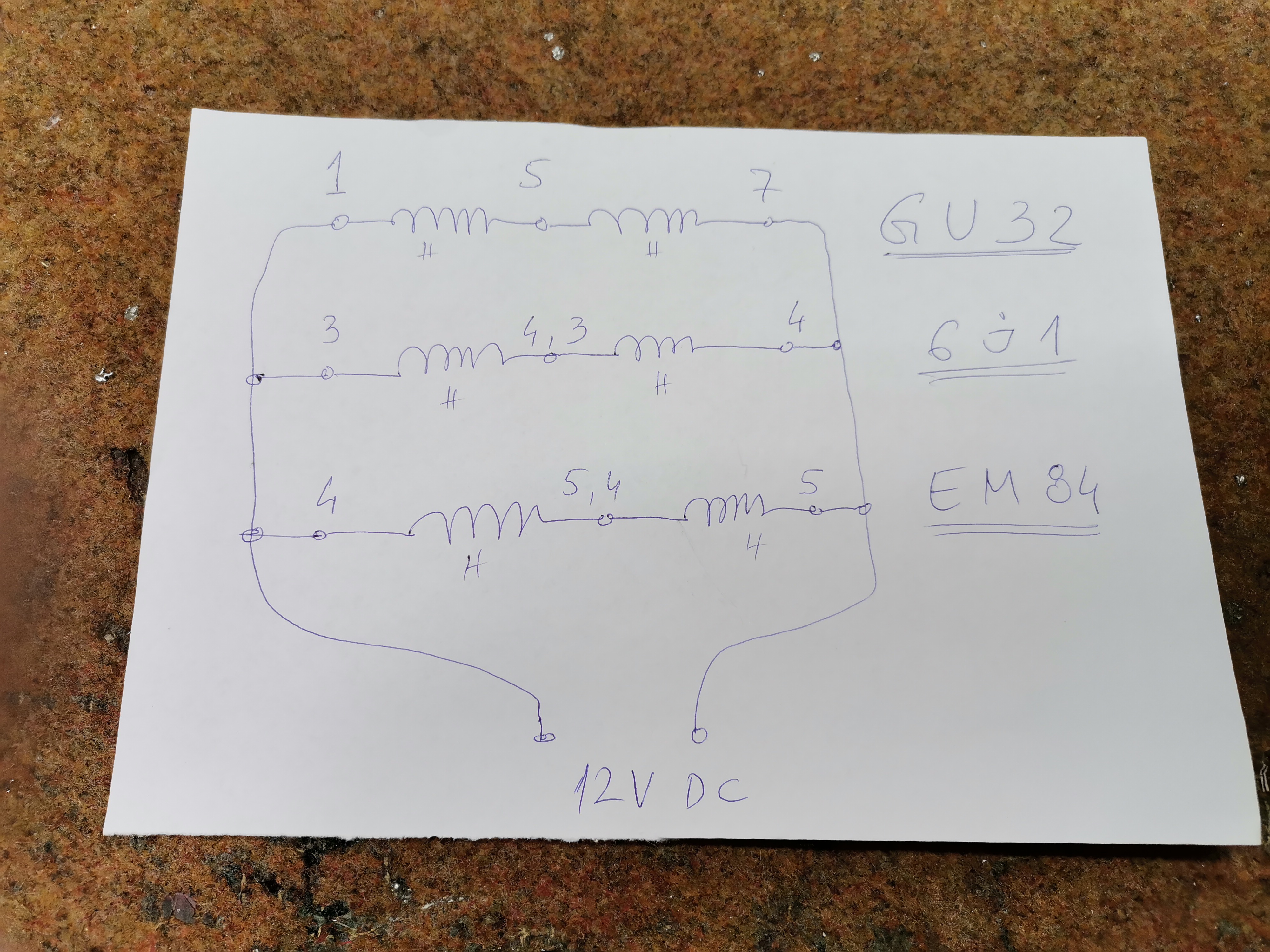

   I will use the input voltage also for heating the Tubes.
   For this purpose, the three series groups of tubes are connected in parallel to 12V as shown in the picture.

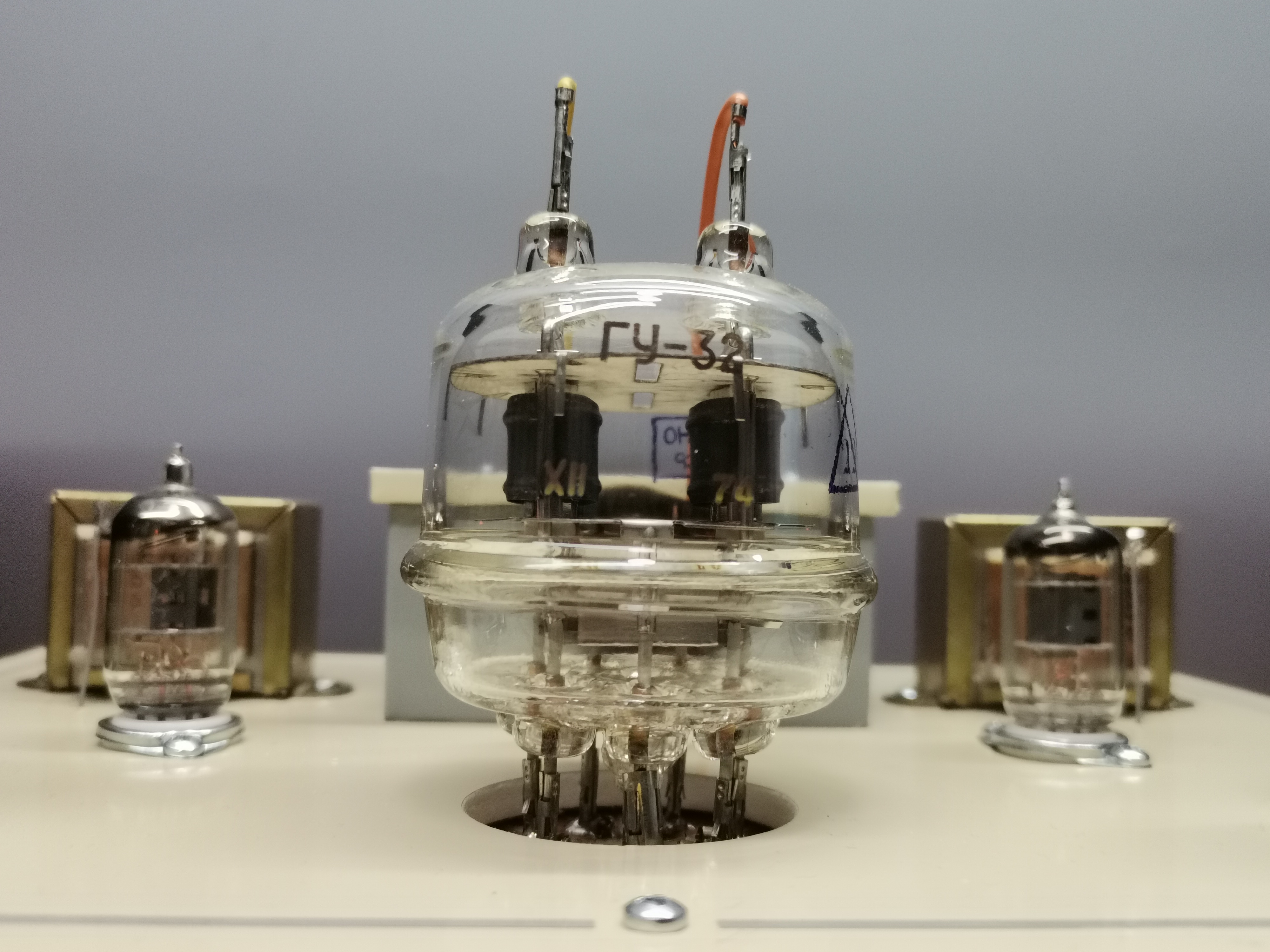

 In this way, the whole power supply part is solved very elegantly and simply. Instead of FU32 I use GU32 Tube which is 100% compatible.

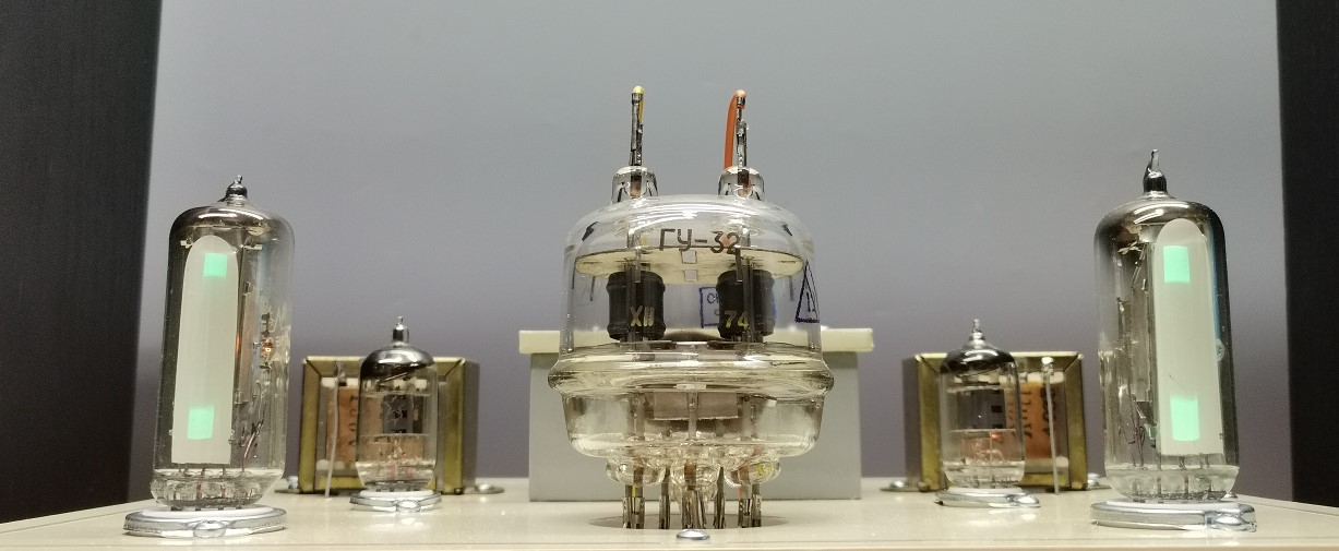

  Input tubes are 6Ј1, one for each channel. For a better visual impression, I also installed a retro VU meter with EM84 tubes, and I described its making in one of my previous videos .

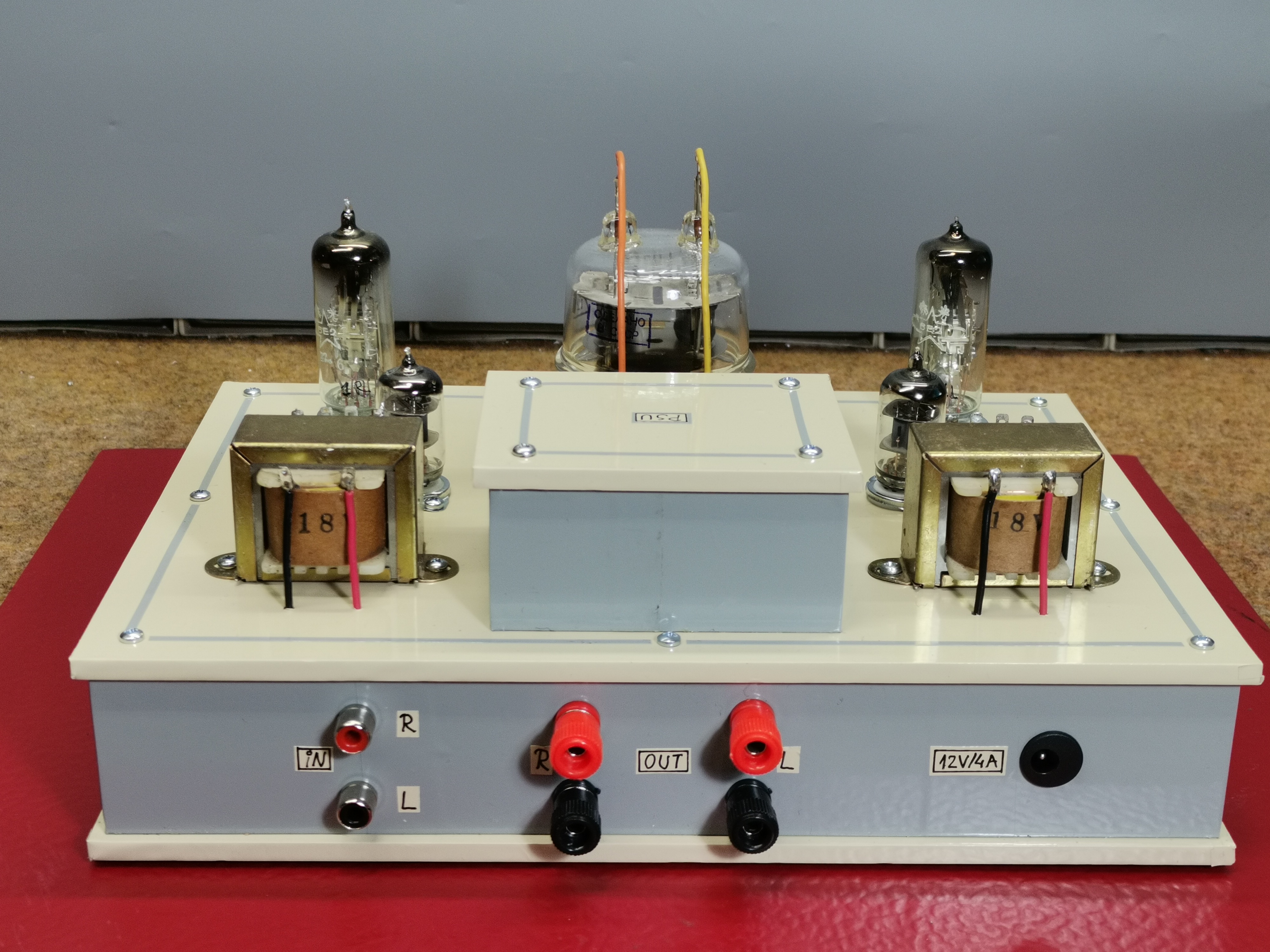

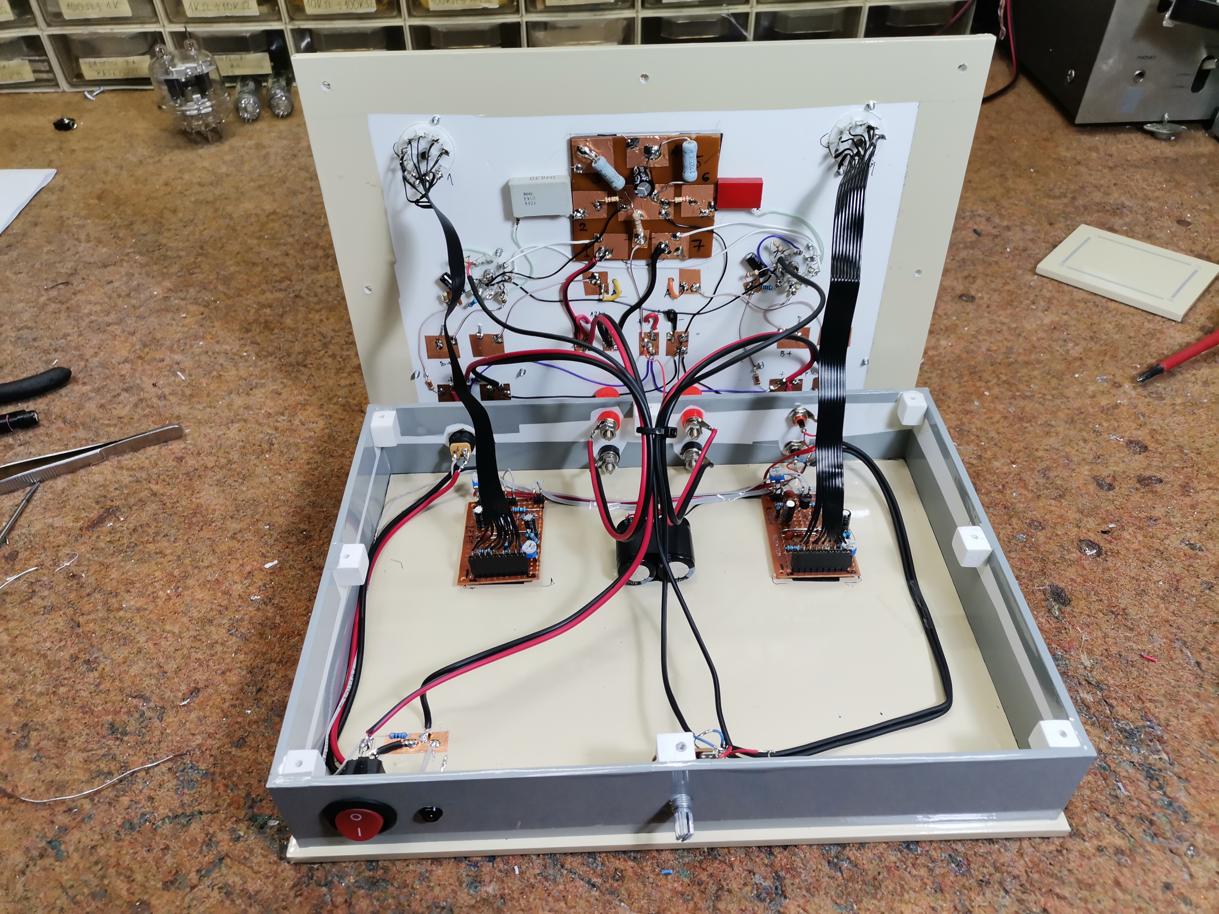

 Now let's take a look at what's inside the box.  In this small box is the power supply module that provides voltage for all parts of the device. Here is how the connection of the components looks like.
  In order to interconnect the components, I used segments of self-adhesive copper tape which really made it much easier for me to make. All connections are made with thin wire keeping in mind that very small currents flow through them. Only the heating lines and speakers connections are made with a thicker wire.

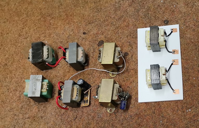

   It can be said that the most important part of these amplifiers is the output audio transformer. These transformers are made with a special way of winding, and the quality of the resulting sound, especially at low frequencies, largely depends on them. For simpler rough initial testing and modifications to the amp, I made the amplifier with ordinary mains transformers.
   I have four pairs of small mains transformers and by individual testing I chose these two which gave the best results. After several hearing tests, I chose transformers that have the best characteristics for this purpose.  Their characteristics are: Primary winding for 220V with ohmic resistance of 400 Ohms, secondary winding for 18V/ 0.5A. The primary windings are connected to the anodes of the tube, and the speakers are connected to the secondaries. Of course, I will replace these transformers with original Audio transformers when I receive them.
I have one audio transformer from an old broken tube radio so I could compare the sound with these mains transformers. The first note is that the sound is about 30% louder, and in terms of sound quality, there was much more pronounced lows and crystal clear highs.
