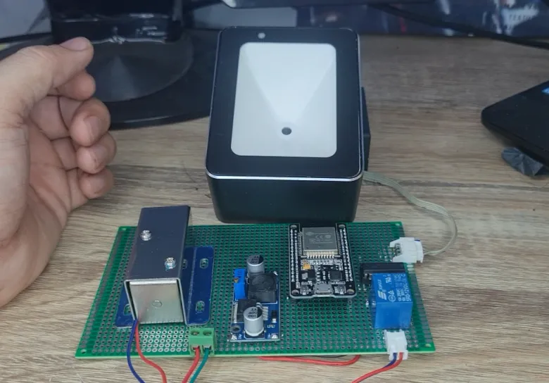

Because I've bought e-paper for many years,
I still don't know how to use it. Until a few days ago,
when I found it, it still showed the old message
that I had tried for a long time(5 year). So I came up with the idea of this project.

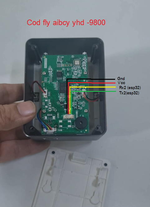

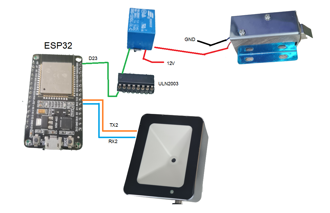

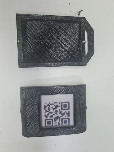

STEP1: E-pager Gen QR Code for Test
STEP2: Assembly board for Test
Because originally using ESP32CAM a problems with slow
reading In low light,Therefore finding a device
that can be used instead
