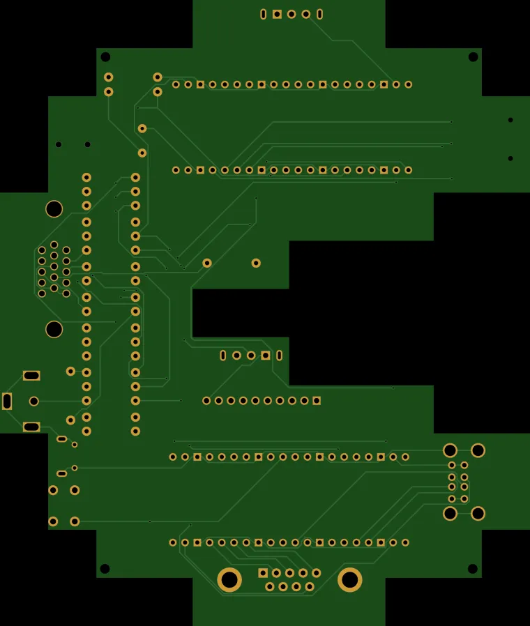

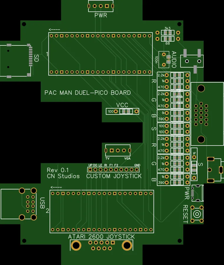

My idea is to create a Pico based computer with 2 Picos, 1 for video/audio output and game emulation, and the other one is used to decode all the user inputs such as USB or controller inputs.
The first revision of the PCB has been completed, but will not be printed until all the details are settled down.
Planned Features:
-Comes with different shapes(Only the PAC-MAN is designed at this stage)
-Very small(10cm*13cm)
-Audio output for speakers or headphones
-VGA and RCA video output(with a switch to switch modes)
-Micro SD card slot for storage
-9 pin ATARI 2600 joystick connector(DSUB-9)
-Reset button
-Power switch
-Can use surface-mount components(resistors, capacitors), or normal-sized components(Metal-Film resistors, PCB Mount Electrolytic Capacitors)

  • Something I reccomend, is that you upgrade to one RP2350A and one RP2350B, on a PCB. that way, you can get more PSRAM attcthed, and potentially get 8-biy 720kp30 and even 720kp60 if you overclock the pico. On my PCB version, I would include USB x2, Micro SD, HDMI, USB-C power, power button and LED, and some GPIO breakout. With the RP2350B, you can also make a built-in keyboard
