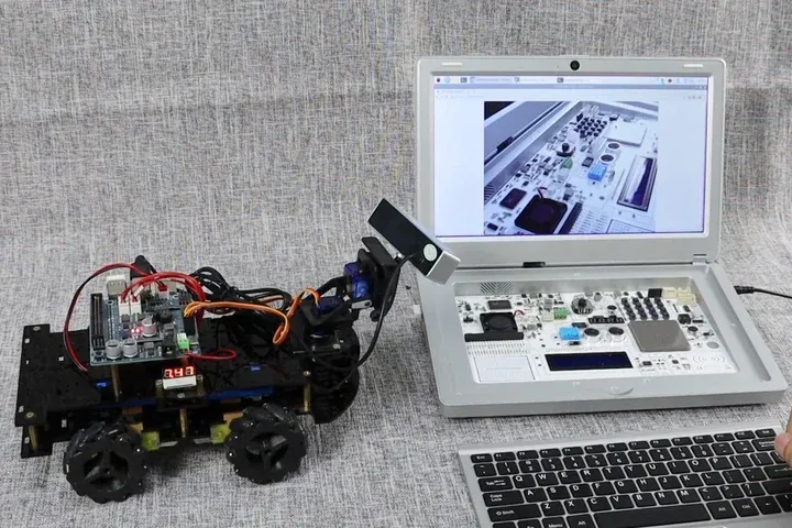

Create your mecanum exclusive smart video car with Raspberry pi and CrowPi2!
When I watched the Batman movie, I was deeply attracted by the cool batmobile, which inspired a long-held idea in my heart, that is to have a cool car like Batman. As a DIY maker, I start my journey to make a “batmobile”. The following are the main features of the car:
● Car can be remotely controlled through wifi
● Car can transfer the real-time video stream to display on CrowPi2’s screen
● Key needed to start the car, that is, the car is my exclusive car
● Car movement controlled by joystick on CrowPi2
● Car PTZ(Pan–tilt–zoom) controlled by button matrix
After reading this instructable, you will actually get an idea of how to make your own super cool car with Raspberry Pi. The steps will show you working principle of wifi remote control card and implementation method.

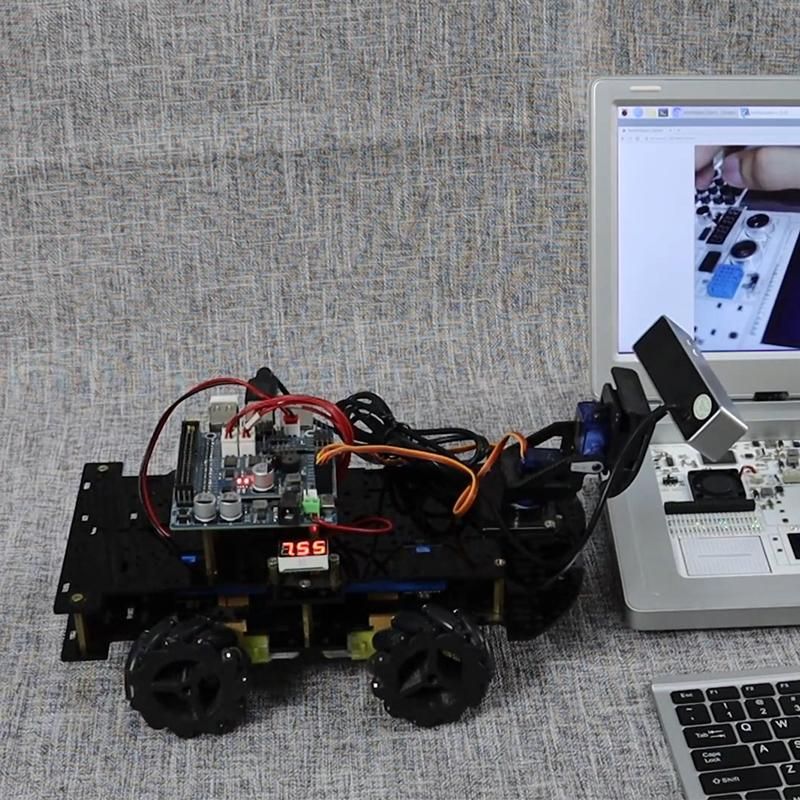

With a Ready-to-use Raspberry Pi car, it’s easy to connect all these materials we prepared. Take a look at the final car(as shown above)
You may have a different Raspberry Pi car from me, but they all have similar principles, and you can assemble a car of your imagination with just a little research. If you are not familiar with the car or the assembly, I suggest you buy a Ready-to-use Raspberry Pi car. The car comes with a driver board, Raspberry Pi, motor, power supply system, etc., which will greatly speed up The progress of the project. Okay, let's continue our greater works, programming to make the car have a “brain”!

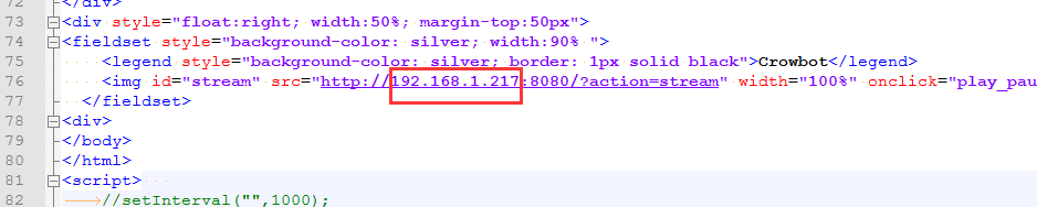

I plan to transfer the car’s video to a web page and use the CrowPi2 to visit this web page to see the video transferred from the car. Therefore, I need to create an index.html file.
Wait...! To make sure the car can access the web page, you need to turn on the wifi of the Raspberry Pi and connect it to a router(whether can access to the internet or not) so that the car and CrowPi2 in the same WLAN network.

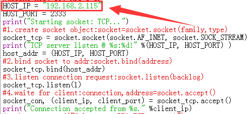

Okay, continue the work. Back to the index.html file, after connecting to a router and get an IP address, you need to modify the IP address in the index.html to car’s one(as the first picture shown):
Keep going. In order to load the index.html file, you will need a python script to achieve it. I create a python script named RPi_Server_Web.py to do so, the main part of the code is shown below (as the second picture shown):

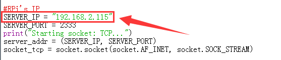

To transfer commands to the car, you need to “tell” the program the IP address of the car to communicate with. As shown in the following code, you need to change "SERVER_IP" to the IP address of your car(please check the first picture):
Then, programming for hardware that send commands to control the car. Three modules will be used on CrowPi2 to control the car. Listed as follows:

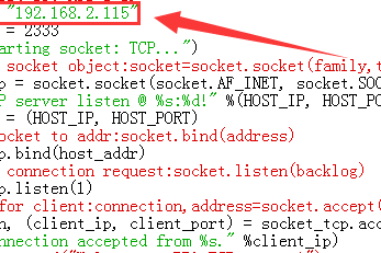

Similar to the CrowPi2 which act as the control side, in order to establish communication between the car and CrowPi2, you need to tell the program the IP address of the controlled side first, that is, the IP address of the car itself: please check the picture
After the communication is established, the next step is to programming for different received commands. Mainly for three parts:

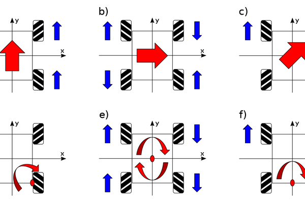

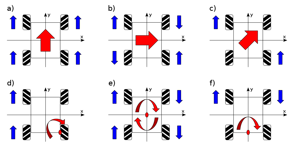

To achieve the car movement, you can define 5 functions for different movements. By setting up the motor, it’s easy to make the car move. As I am using the mecanum wheels, it’s necessary to learn mecanum wheel car movement principle, just like the third pictur shown below:
