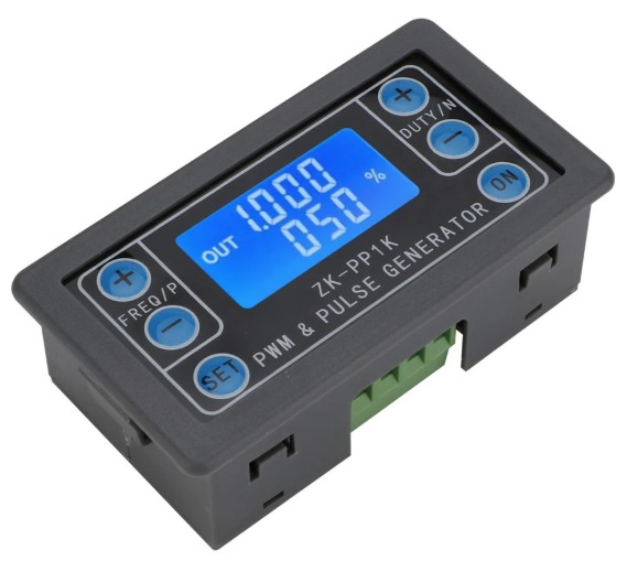

 - The heart of the driver circuit is inexpensive Square Wave Generator with adjustable frequency and duty cycle. This incredibly useful - I also call it magical - module is responsible for the stability and versatility of the entire circuit.
For the price of a few dollars we get a pulse generator with adjustable frequencies from 1Hz to 150kHz, and a duty cycle from 1 to 99%. It even has a small LCD display on which the selected values are displayed. You can notice that I use this module in a number of my previous projects. It can be powered by a voltage from 3 to 30V and the amplitude of the output signal is equal to the supply voltage.

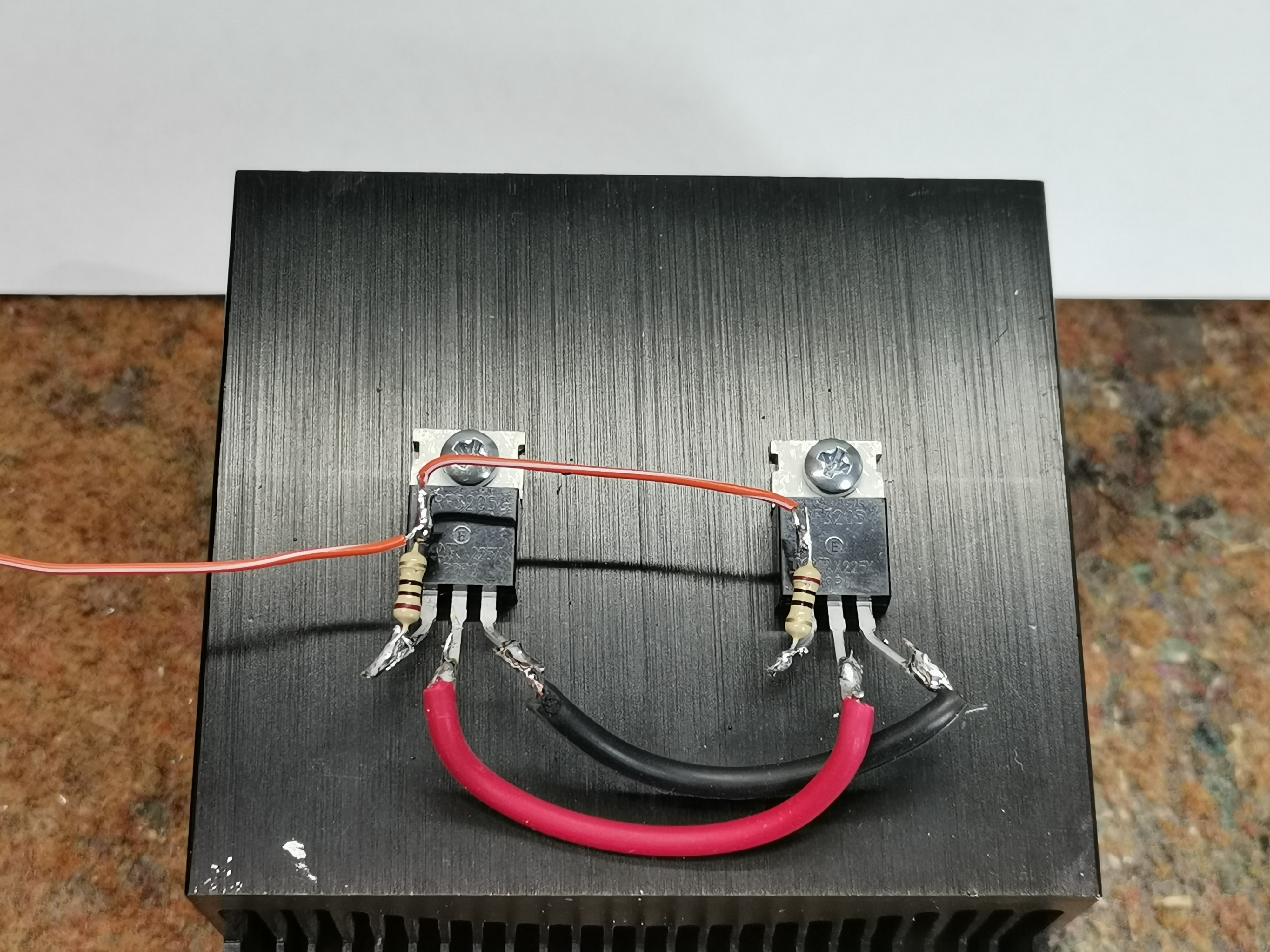

- Then we have two power MOSFETs type IRF3205 connected in parallel amd mounted on a large heatsink that provide power to the low-impedance primary of the HV Transformer.

- At the input side of the low-voltage source, there is an automatic fuse that trips in the event of a driver failure, most likely a burnout of the Mosfets.

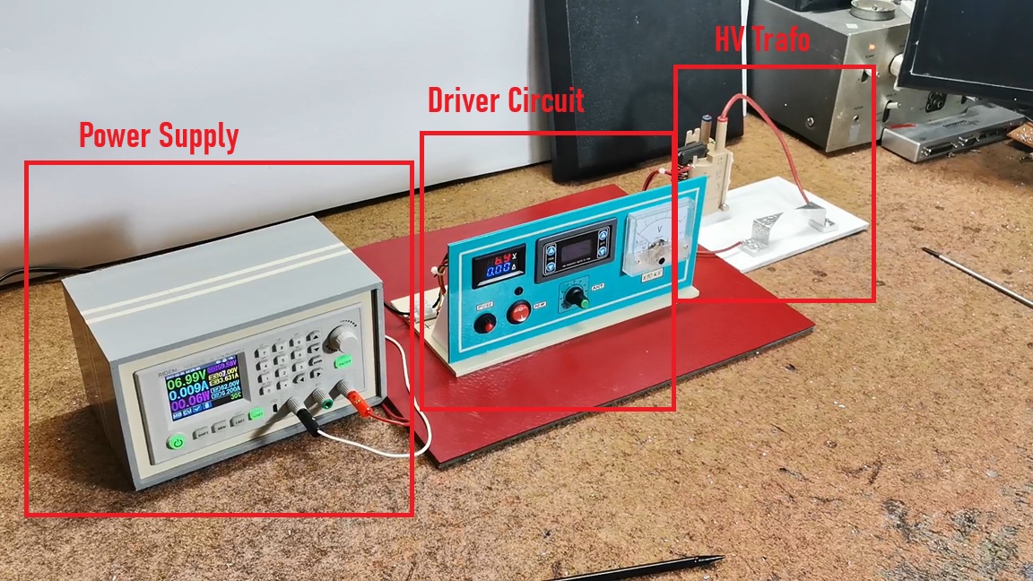

   Now let's see how the device works in real conditions. At the input, I initially bring 12V and a current limited to 2A. At the output, I connected a Flyback transformer from an old CRT monitor, on whose core I wound a primary consisting of 7 windings. Here we need to experiment because in different models of transformers the number of windings to achieve the highest efficiency is different.  Now we activate the power supply and a spark should appear on the secondary of the transformer. If there is no spark or it is very small, and the current does not exceed 2A (the protection does not turn on), we need to choose a different frequency and duty cycle of the generator. In fact, the duty cycle should be in the range of 30 to 45% and the frequency from 15 to 30 Kilohertz depending on the model of the HV transformer. In this particular case for this trafo, the hotspot for best efficiency is a frequency around 15KHz and a duty cycle of 36%.

- The first and simplest way is, as you probably guessed, by changing the input voltage to power the device. In this case, the generator parameters remain the same, the potentiometer is at maximum and only the input voltage changes. We will roughly approximate the voltage value by the length of the spark on the secondary of the transformer. A spark starts to be generated even at less than 6V, which is a sign of good tuning and efficiency of the entire system. With increasing the input voltage, the length of the generated spark, i.e. the HV voltage, also increases.
 If we have the opportunity, instead of a laboratory rectifier that contains a switching circuit and is sensitive to high-frequency parasitic signals, it is best to use a standard transformer with a classic rectifier on which we install a Variac. By regulating the primary voltage through the variac, we also control the value of the HV voltage.
 - The next, slightly more crude way to regulate is by changing the duty cycle value. In this case, we set the input voltage to the highest previously determined level, and change the duty cycle from 5% to about 40%.
 - And finally with a potentiometer at the output of the signal generator that changes the amplitude of the rectangular signal. By moving the potentiometer clockwise, the output high voltage increases proportionally.
