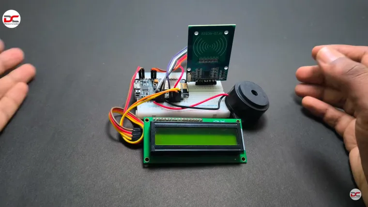

This system offers an automated attendance tracking solution by combining RFID technology with IoT capabilities—specifically, NodeMCU (ESP8266) for connectivity and Google Sheets for cloud-based record keeping. It enables real-time capture and tracking of attendance data.
You’ll learn how to: ✅ Connect an RFID-RC522 module to NodeMCU ✅ Display instructions on an LCD screen for smooth tag scanning ✅ Integrate your system with Google Sheets for instant updates ✅ Assign unique RFID cards or ID badges to each student or employee ✅ Keep attendance logs automatically stored in the cloud
Core Components
  • Hardware:
    • NodeMCU (ESP8266): Powers the system and handles Wi-Fi connectivity.
    • RFID Reader (e.g., MFRC522): Reads the unique ID from RFID cards or tags.
    • Optional elements often include buzzers, LCDs, or LEDs for user feedback.
  • Software & Connectivity:
    • Programming via the Arduino IDE using relevant libraries (e.g., MFRC522).
    • Google Sheets API enables real-time data upload to a spreadsheet
System Workflow
  1. Initialization: Hardware is set up and NodeMCU connects to Wi-Fi.
  2. RFID Scan: User presents RFID tag/card; the reader captures the UID.

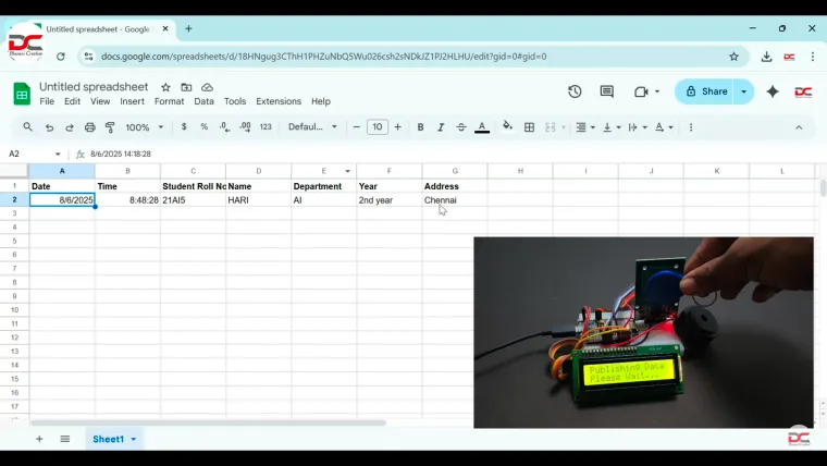

  3. Data Transmission: NodeMCU sends this UID (and possibly other details) to Google Sheets.
  4. Real-Time Update: Google Sheets receives and logs the attendance instantly.
  5. Feedback Mechanism: A buzzer or display may confirm the scan.
