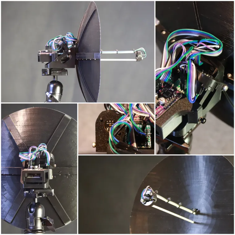

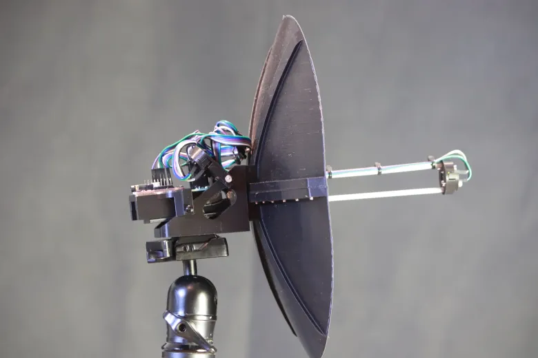

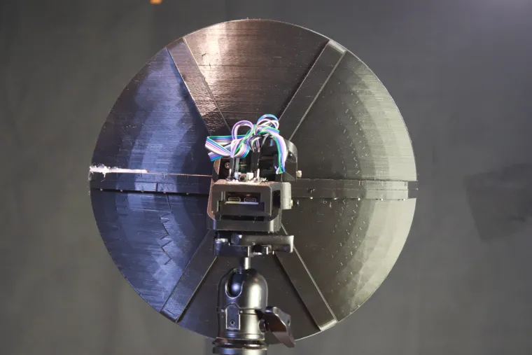

This project implements a real-time NLMS adaptive filter on an ESP32, within the framework of a 3D-printed acoustic parabola. The goal is to improve the signal-to-noise ratio of a MEMS microphone placed at the focal point of the parabola by subtracting ambient noise measured by a second MEMS microphone positioned outside the focus.

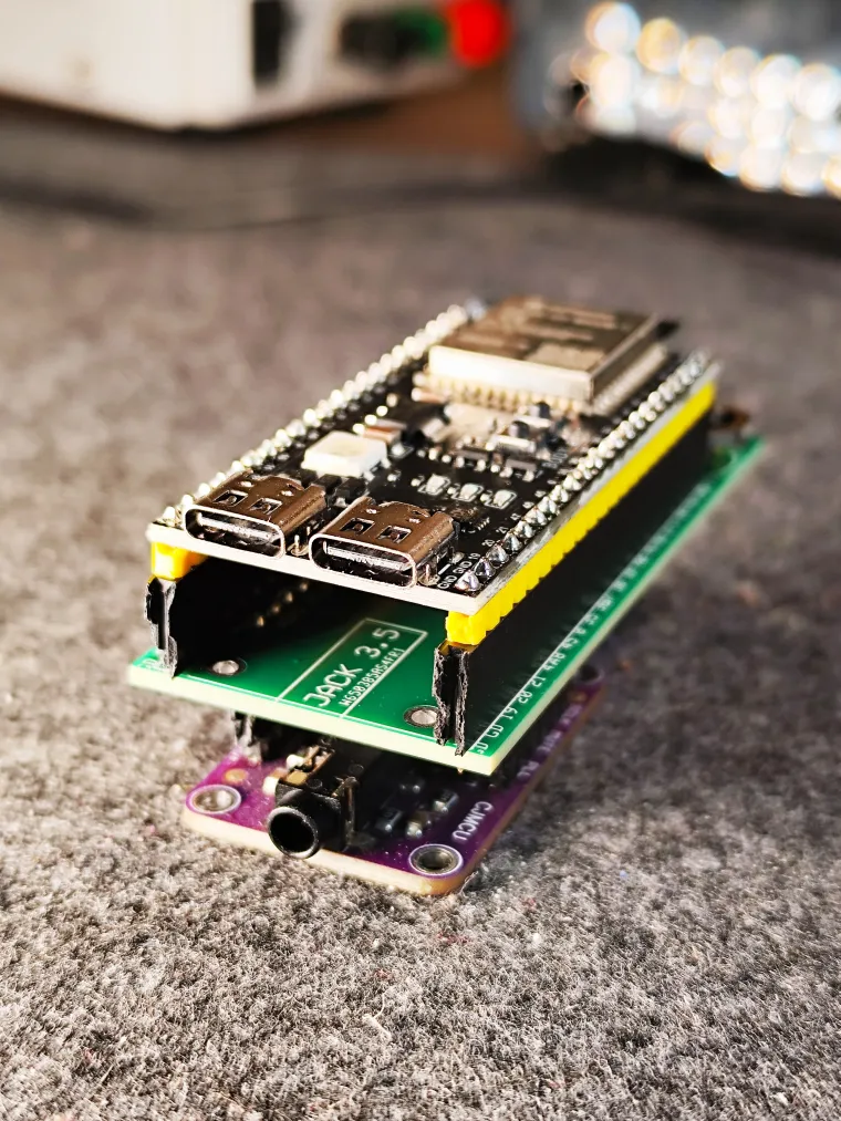

The microphones used are INMP441 MEMS digital microphones, connected via I2S to the ESP32. Both channels of the ESP32’s I2S peripheral are used to capture the signals simultaneously with stereo. Audio is decoded with a UDA1334.
The signal processing is based on a Normalized Least Mean Square (NLMS). The algorithm dynamically adjusts the coefficients of a FIR filter to minimize the mean squared error between the focused microphone signal and the reference noise signal. DSP functions from Espressif are used as much as possible. The implementation uses double buffering.

The idea is to suppress part of the noise captured by the focused microphone using a second microphone placed off-axis. The parabola provides a passive acoustic gain estimated at around 20 dB. The INMP441 microphone used here has a sensitivity of -26 dBFS, which theoretically allows for a decent range. In practice, the system has been mainly tested indoors, during filter development — and I never really took the time to try it outdoors.
Hardware Architecture
  • ESP32 DevKit (Xtensa LX6, dual-core, running FreeRTOS)
  • Two INMP441 digital microphones connected via I2S
    • Focus mic: captures signal + noise
    • Reference mic: captures mostly noise
  • Audio output: UDA1334 DAC connected to the second I2S port
  • RGB LED on the ESP32 dev board used to display real-time SNR
  • 3D-printed parabola, with STL files included in the repository
