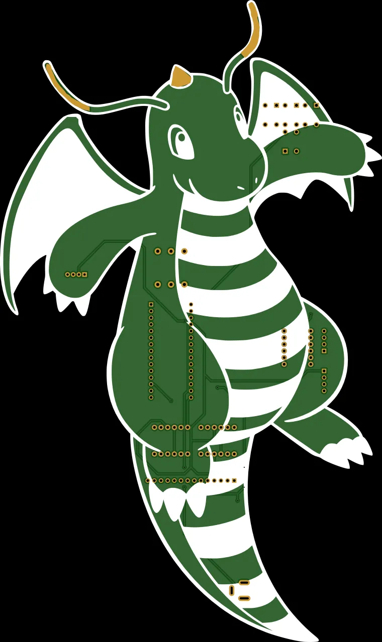

Step 1: Designing and soldering the Dragonite-inspired PCB
Before prototyping my Dragonite-inspired PCB design, I tested all connections and wiring with Nicla Vision and Arduino Nano. Then, I checked the data transfer processes between Nicla Vision and the web application hosted on LattePanda 3 Delta.
Then, I designed my Dragonite-inspired PCB by utilizing KiCad. As mentioned earlier, I wanted to design my PCB based on Dragonite since it was the first Pokémon that made me afraid of a water attack out of nowhere, despite being a Dragon/Flying type Pokémon :)
First of all, by utilizing a TS100 soldering iron, I attached headers (female), pushbuttons (6x6), resistors (220Ω), a 5mm common anode RGB LED, and a power jack to the PCB.
📌 Component list on the PCB:
A1 (Headers for Arduino Nano)
Nicla1 (Headers for Nicla Vision)
mmWave1 (Headers for 60GHz mmWave Module)
S1 (Headers for ILI9341 TFT LCD Screen)
L1, L2, L3 (Headers for Bi-Directional Logic Level Converter)
K1, K2, K3, K4 (6x6 Pushbutton)
D1 (5mm Common Anode RGB LED)
R1, R2, R3 (220Ω Resistor)
J1 (Power Jack)

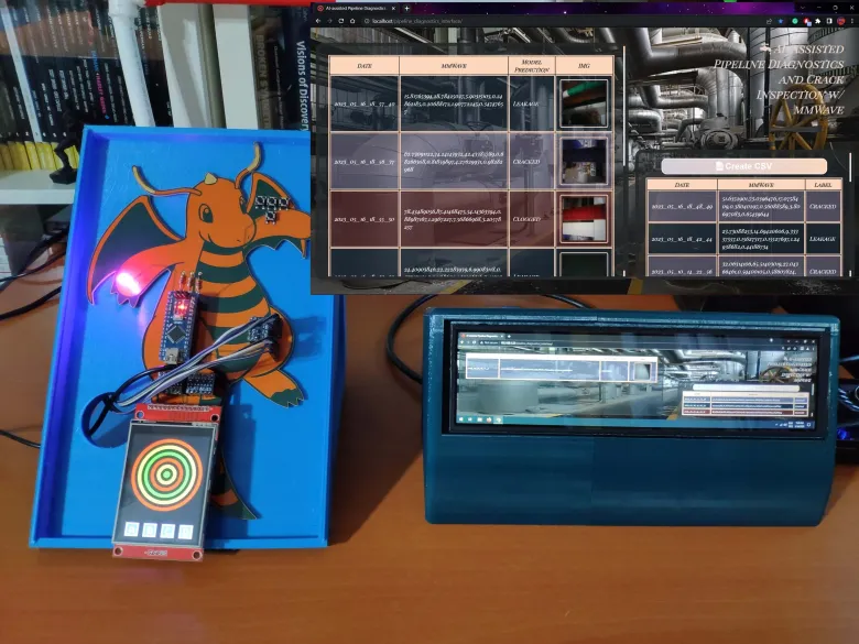

Step 2.2: Creating a LattePanda Deck to display the web application
Since I decided to utilize the web application to display the collected data parameters, generate the pre-formatted CSV file from the stored data records in the database, and show the model detection results with the captured images of the deformed pipes, I wanted to create a unique apparatus to inspect the web application.
Since I host this web application on my LattePanda 3 Delta, I decided to design a unique and compact LattePanda Deck compatible with not only LattePanda but also any single-board computer supporting HDMI.
I decided to employ Elecrow's 8.8" (1920*480) high-resolution IPS monitor as the screen of my LattePanda Deck. Thanks to its converter board, this monitor can be powered via a USB port and works without installing any drivers. Therefore, it is a compact plug-and-play monitor for LattePanda 3 Delta, providing high resolution and up to 60Hz refresh rate.
Due to the fact that I wanted to build a sturdy and easy-to-use deck, I designed a two-part case covering the screen frame and providing a slot for the converter board. To avoid overexposure to dust and provide room for cable management, I added a mountable back cover adorned with the brand logo.
I designed the two-part case and its mountable back cover in Autodesk Fusion 360. You can download their STL files below.
Then, I sliced all 3D models (STL files) in Ultimaker Cura.
After printing all deck parts (models) with my Anycubic Kobra 2 3D Printer, I affixed the two-part case together via the hot glue gun.
Then, I fastened the Elecrow's IPS monitor to the case covering the screen frame and inserted the converter board into its slot.
After attaching the required cables to the converter board, I fixed the mountable back cover via M3 screws.
After connecting the converter board to LattePanda 3 Delta via its USB and HDMI ports, LattePanda recognizes the IPS monitor automatically.

Step 3.3: Generating data samples and displaying real-time model detection results transferred by Nicla Vision
After setting the web application on LattePanda 3 Delta 864:
🚿🔎📲 The web application (update_server.php) saves the mmWave data parameters with the selected class transferred by Nicla Vision via an HTTP GET request to the entries MySQL database table.
/pipeline_diagnostics_interface/update_server.php?data=OK&mmWave=32.06314106, 65.51403019, 27.04366461, 0.59400105, 0.58607824, 5.429632, 0.81743312&class=Cracked
🚿🔎📲 When Nicla Vision transmits raw image buffer (RGB565), model detection results, and inference data parameters via an HTTP POST request with URL query parameters, the web application (update_server.php) stores the received information in the detections MySQL database table. Then, the application converts the received raw image buffer to a JPG file by executing the rgb565_converter.py file via the terminal.
python "C:\Users\kutlu\New E\xampp\htdocs\pipeline_diagnostics_interface\detections\rgb565_converter.py"
🚿🔎📲 On the web application interface (index.php), the application displays the concurrent list of data records saved in the entries database table as an HTML table.
🚿🔎📲 When the user clicks the HTML button (Create CSV), the application opens a confirmation window to generate and download a CSV file (data_records.csv) consisting of the data records saved in the entries database table as samples.
🚿🔎📲 Also, on the application interface, the application shows the concurrent list of model detection results with the captured images of the deformed pipes to inform the user of the latest diagnosed pipeline defects.
🚿🔎📲 The web application updates its interface every 5 seconds automatically via the jQuery script to display the latest stored information in the MariaDB database on LattePanda 3 Delta.
🚿🔎📲 For each pipeline diagnostic class (label), the web application changes the row color in the HTML tables to clarify and emphasize the collected mmWave data parameters and the model detection results:
  • Leakage ➜ Dark Blue
  • Cracked ➜ Violet
  • Clogged ➜ Red
🚿🔎📲 When the user hovers the cursor over the image frames, the web application highlights the selected frame.
🚿🔎📲 If Nicla Vision has not transferred any information yet, the web application notifies the user through the HTML tables.

Step 8: Running the model on Nicla Vision to diagnose pipeline defects and transferring model results w/ captured images of the deformed pipes via POST requests
My Edge Impulse neural network model predicts possibilities of labels (pipeline diagnostic classes) for the given features buffer as an array of 3 numbers. They represent the model's "confidence" that the given features buffer corresponds to each of the three different pipeline diagnostic classes [0 - 2], as shown in Step 6:
  • 0 — Clogged
  • 1 — Cracked
  • 2 — Leakage
After executing the AI_assisted_Pipeline_Diagnostics_run_model.ino file on Nicla Vision:
🚿🔎📲 If the control button (D) connected to Arduino Nano is pressed, it adds the Run command to the recently extracted mmWave data parameters, transfers the given information to Nicla Vision via serial communication, and turns the RGB LED to cyan.
🚿🔎📲 Then, it switches the interface button (D) color to cyan and shows the simple radar indicator visualizing the extracted mmWave data parameters on the ILI9341 TFT LCD screen.
🚿🔎📲 After Nicla Vision receives the mmWave data parameters with the Run command, it runs an inference with the Edge Impulse neural network model by applying the received mmWave data parameters to diagnose pipeline defects and captures an image of the deformed pipe with the built-in GC2145 camera.
🚿🔎📲 Then, it transfers the applied mmWave data parameters, the model detection results, and the captured image of the deformed pipe (raw image buffer) as a TXT file to the web application via an HTTP POST request with URL query parameters.
🚿🔎📲 Also, Nicla Vision prints notifications and model detection results on the serial monitor for debugging.
As far as my experiments go, the device diagnoses pipeline defects demonstrated by my custom pipeline system precisely, captures images of deformed pipes, and communicates with the web application flawlessly :)
