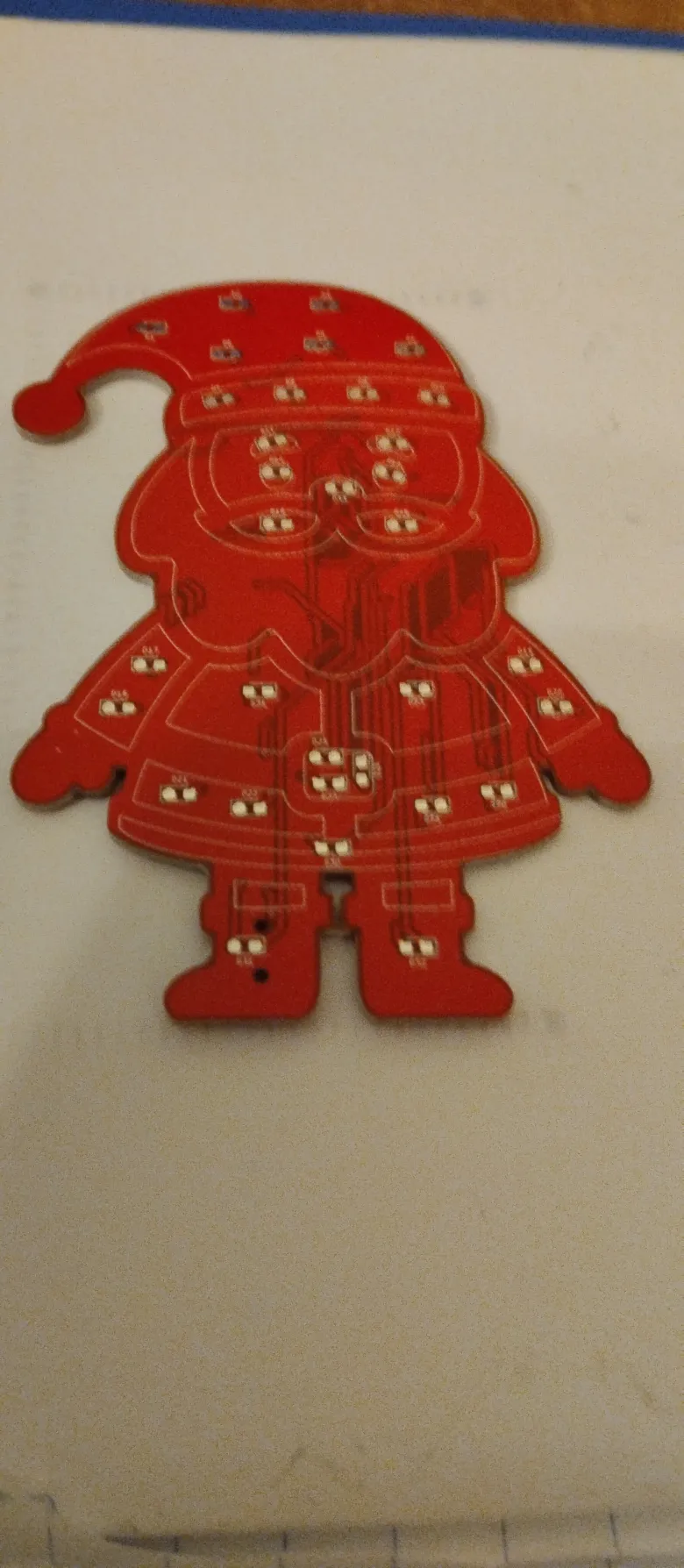

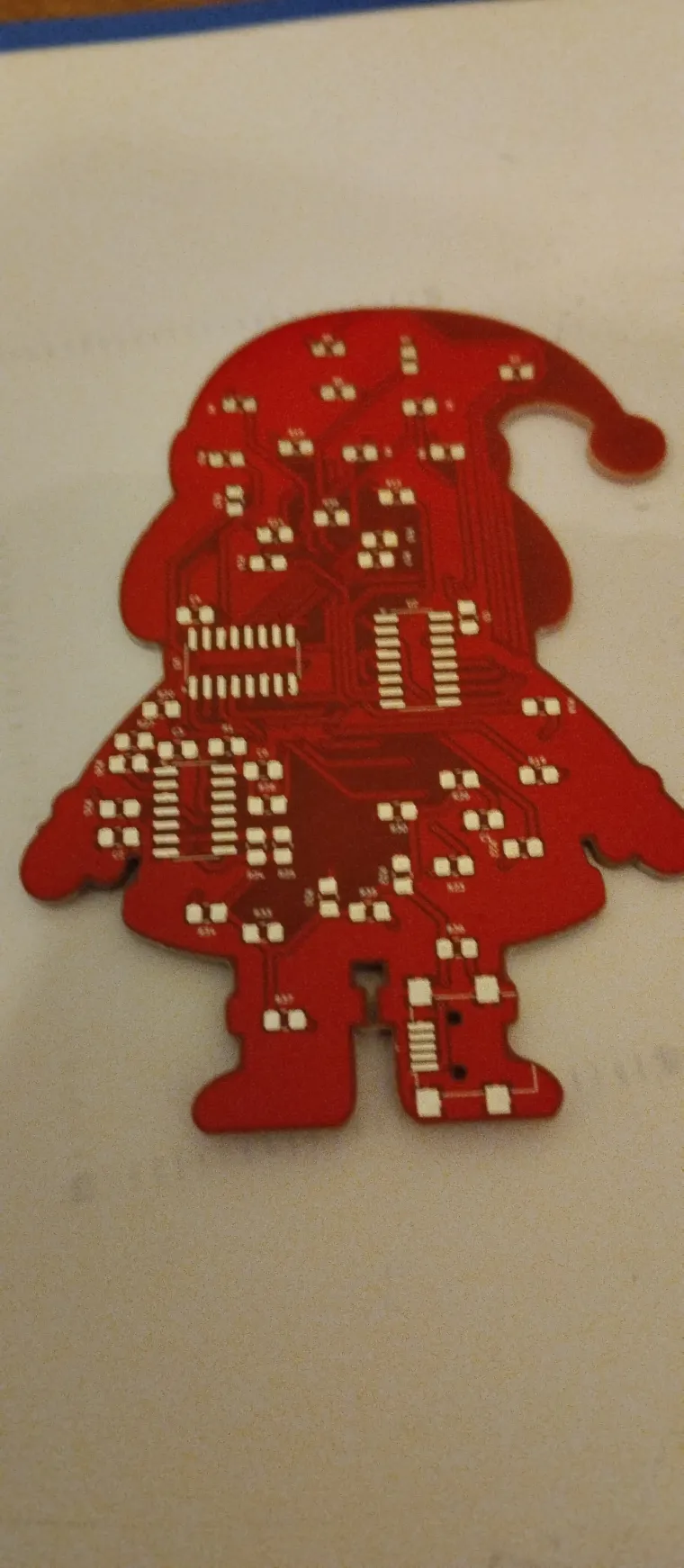

Due to Christmas celebrations elecrow make an offer for PCB with Christmas theme. So i decide to made ta santa clauss with some led lighting. The leds should flickering at a low frequency about 10 Hz. The problem is that  i haven't yet receive the components to test the circuit yet. The design made in kicad Version 8.0.7.

  • R24,R25 and R26,R27 Should be installed only 1 per pair. The second resistor exist only in case you need to change to a custom frequency. According to Texas instrument datasheet for the 5volt supply the oscillation frequency should be about 10-20Hz.
