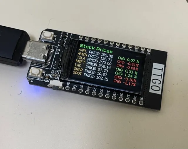

TTGO Stocks Monitor
TTGO Stocks Monitor
Simple way to monitor stocks using the TTGO board TTGO_stocks
PlatformIO Build
Please install first PlatformIO open source ecosystem for IoT development compatible with Arduino IDE and its command line tools (Windows, MacOs and Linux).
Configure
Set your Wifi crendentials and API key in the configuration file: platformio.ini or export your configuration via environment variables like this:
export PIO_WIFI_SSID="your-wifi-ssid"
export PIO_WIFI_PASSWORD="your-wifi-password"
export FINHUB_API_KEY="your-api-key"
Firmware upload
For compiling and uploading the firmware via USB cable, you only need execute the next command in the root directory:
pio run --target upload
