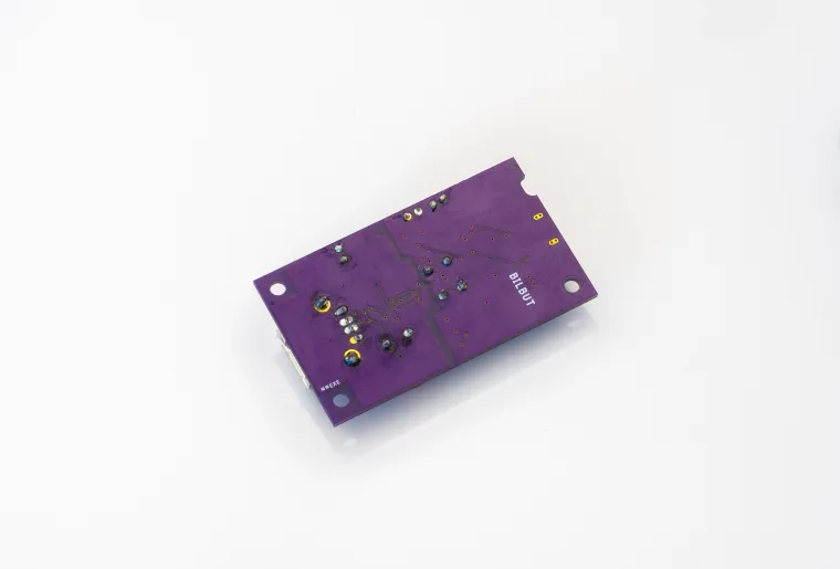

USB KILLER DETECTOR
SELL SHEET
UBS Kill is a pen-testing device that looks like a regular USB flash drive. When these USB flash drives are connected into a USB port of your personal computer, then the 5V found in the USB port is converted into about 220 Volts. Needless to say that the computer can be physically damaged in seconds, resulting in the spending of money and resources to replace broken parts.
Key Features:
- Detects these flash drives in seconds.
- Fits in your hand and pocket.
- Relatively low manufacturing costs.
- Universally compatible with almost any micro-USB charger.
- Use it prior to connect an unknown flash drive to your valuable hardware.
- Confidently proceed as usual upon a negative result.
