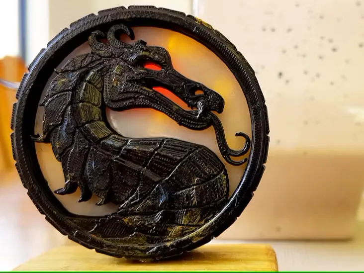

3D Printed Breathing IC555 LED Trophy
This project features a custom 3D-printed 'Mortal Kombat' trophy shell paired with a basic NE555 timer circuit in 'astable mode'
This project features a custom 3D-printed 'Mortal Kombat' trophy shell paired with a basic NE555 timer circuit in 'astable mode', producing a smooth 'breathing' LED effect—mimicking the gentle pulse of a living light.

Alright, it's time for me to put everything together! First, let’s glue the plastic cutout to the back of the front bit.
Once that’s done, I added aluminum foil to the back section to boost the reflection inside the box.
Next, let's solder a wire from the breakout board to the USB-C charging port. Then, let's attach all the five LEDs to the circuit board, including a red LED on the 5V input for the dragon’s eye. Once everything’s in place, I carefully hot-glue each LED to the back of the unit.
Once that was all set, I superglued the top part to the bottom part. Finally, I mounted the whole assembly on a wooden base to complete the setup.
Final Demo
So, this is how my final setup looks like.
