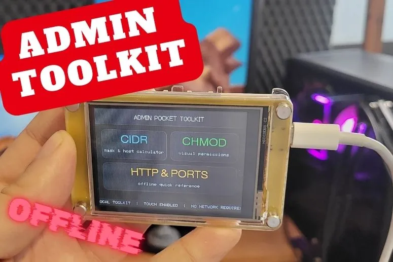

Admin Pocket Toolkit Offline on ESP32
I turned an ESP32 Bitcoin miner into a practical Pocket Admin Toolkit. After running for more than 100 days, my original Bitcoin mining experiment became something much more useful: a fully offline touchscreen toolkit for Linux, networking, and system administration. Everything runs directly on the ESP32. No Wi-Fi. No cloud. No accounts. No API keys. Just fast, offline tools that are always available. Features • CIDR & subnet calculator • Visual Linux chmod calculator • HTTP status code reference • Common network ports reference This is only version 1, and I already have ideas for many more features.
Overview
Admin Pocket Toolkit Offline transforms the Elecrow ESP32 Miner LCD into a portable toolkit for system administrators, DevOps engineers, cloud engineers, and IT professionals.
The device was originally designed as a standalone Bitcoin miner, but thanks to the flexibility of the ESP32 platform, I repurposed it into a completely different product: a handheld offline utility that provides everyday administration tools without requiring a laptop or an Internet connection.
Unlike web-based calculators, this version runs entirely on the ESP32 microcontroller and is optimized for the 2.8-inch touchscreen display. It is based on the Elecrow ESP32 Miner LCD development board, which features an ESP32 processor, touchscreen, Wi-Fi, Bluetooth, SD card support and is fully compatible with Arduino IDE, PlatformIO and LVGL.

This project demonstrates that inexpensive ESP32 hardware can become a practical productivity device rather than being limited to its original purpose.
How it works
The firmware is written in C++ using Arduino Framework and PlatformIO.
The graphical interface is built with LVGL and optimized for the 2.8-inch touchscreen.
Every calculation is performed locally on the ESP32.
No cloud services.
No backend.
No user accounts.
No telemetry.
No Internet connection is required.
Current Features
✔ CIDR Calculator
✔ chmod Calculator
✔ Cron Expression Generator
✔ Unix Timestamp Converter
More tools are planned in future releases.
How to build the project
Step 1
Flash the firmware onto the Elecrow ESP32 Miner LCD board.
Step 2
Connect the device using the USB-C cable.
Step 3
The application starts automatically after boot.
Step 4
Navigate between tools using the touchscreen interface.
Step 5
Perform calculations locally without any network connectivity.
