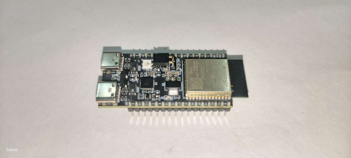

  • ESP32-C6

    1*ESP32C6 DEVKIT

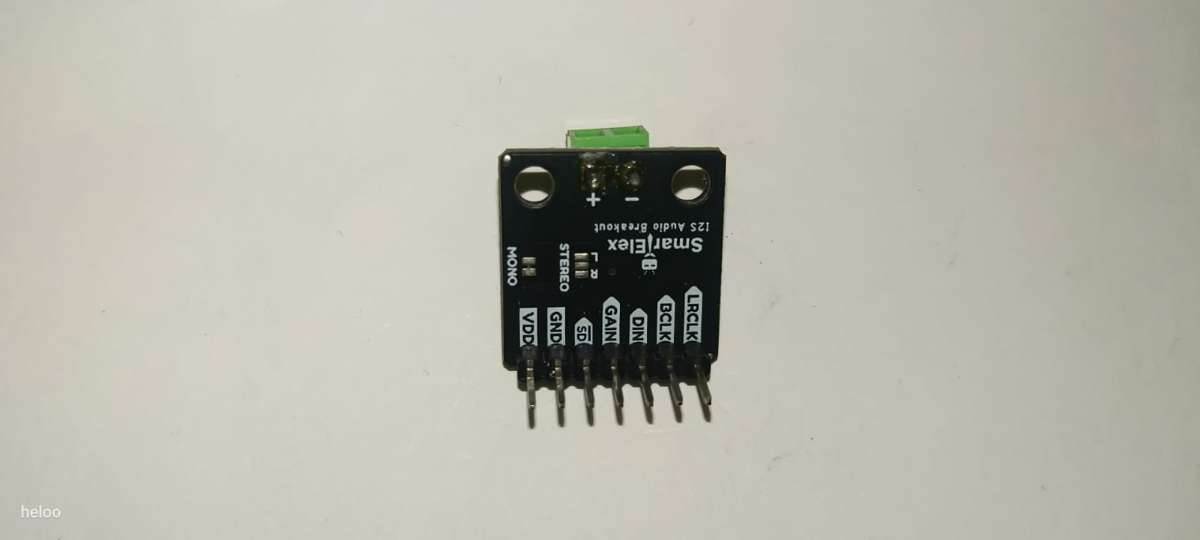

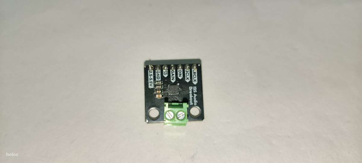

  2. 1*MAX98357A AMPLIFIER

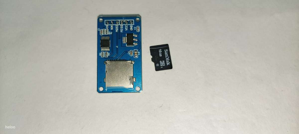

  3. 1*8 GB SD CARD with its module

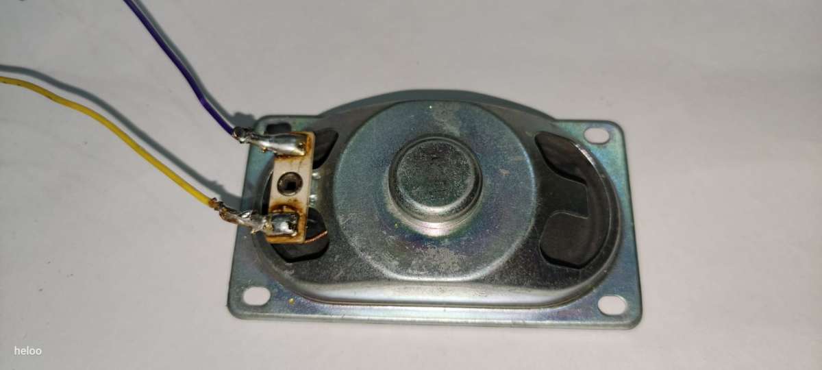

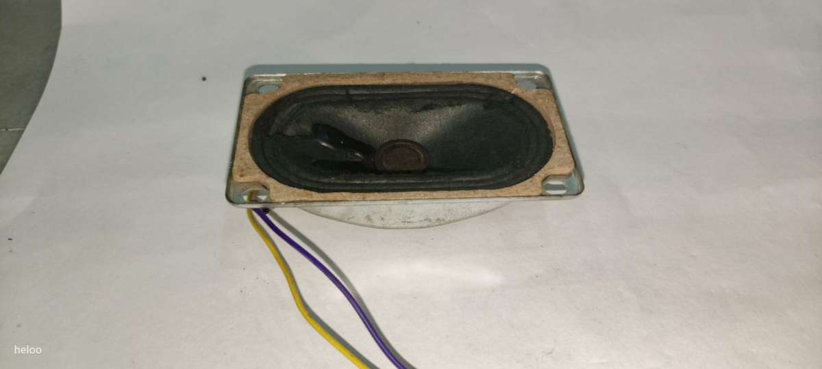

  6. 1* 1W 8OHM SPEAKER

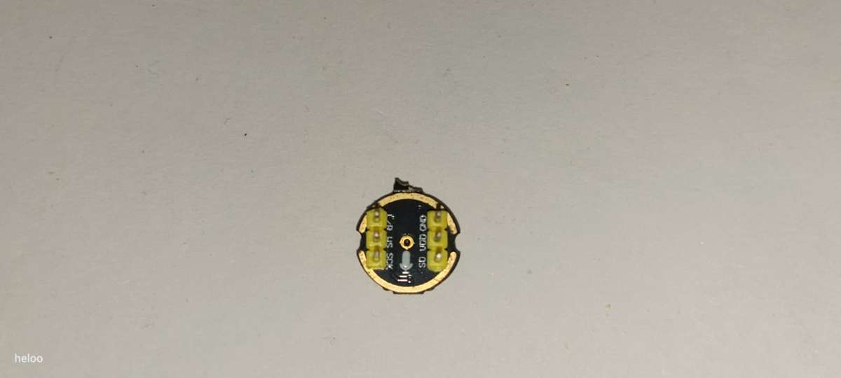

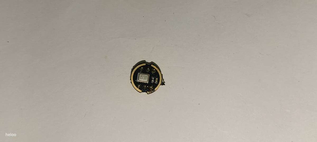

  7. 1*INMP441 MIC MEMS

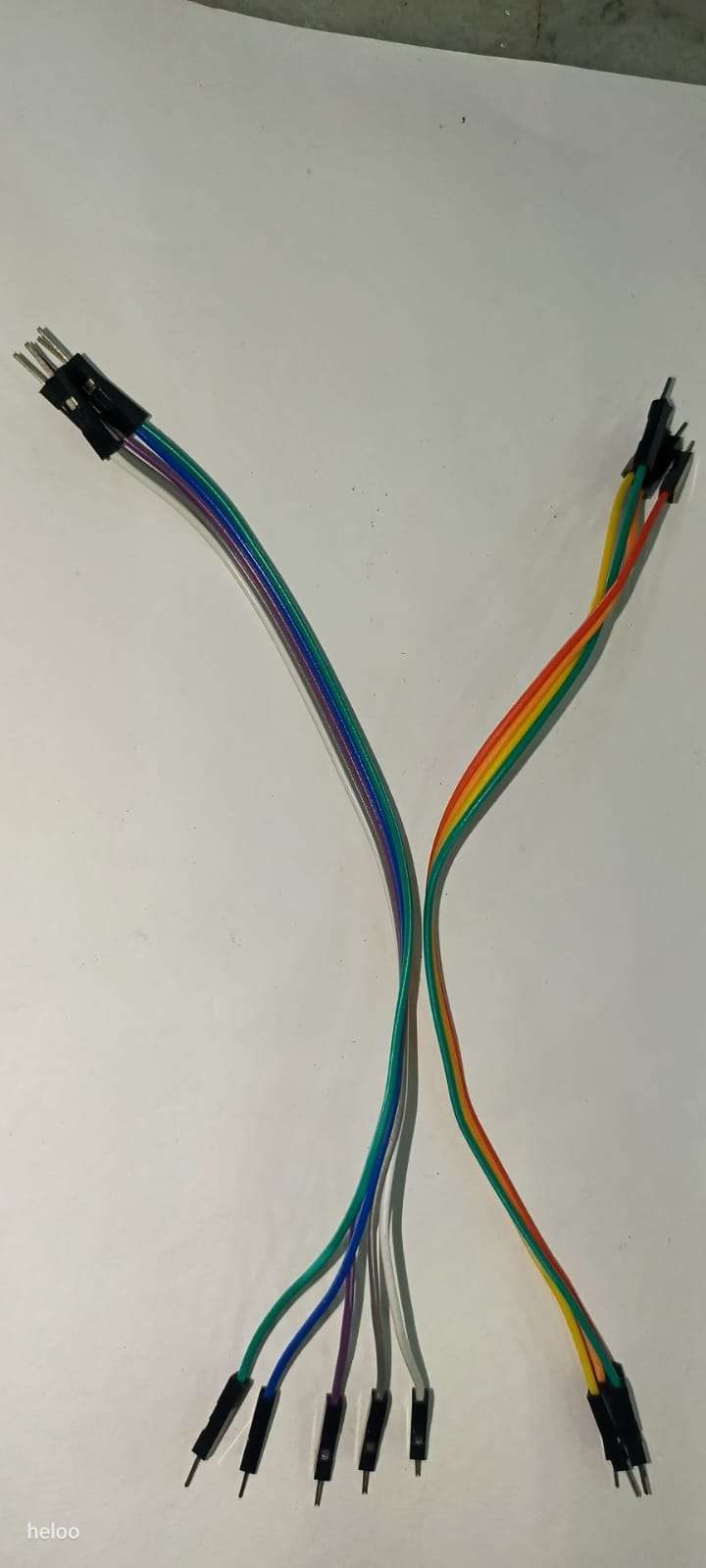

    2*MALE TO MALE JUMPER WIRE

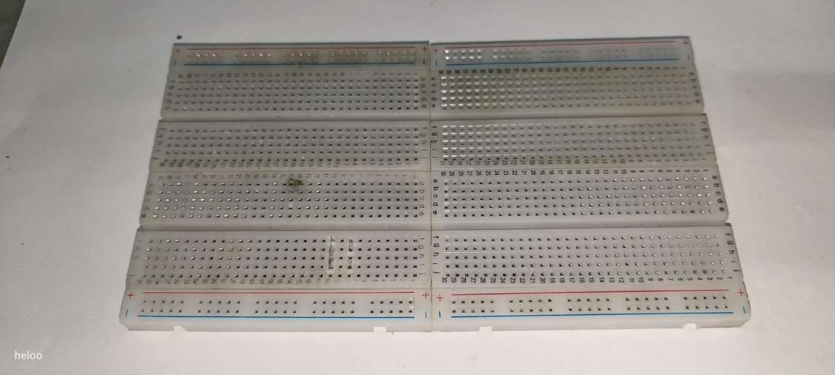

  8. 1*BREADBOARD

    INMP441 (Microphone Input):
    VDD  -> 3.3V
    GND  -> GND
    SD   -> GPIO 2
    WS   -> GPIO 3
    SCK  -> GPIO 4
    L/R  -> GND
    MAX98357A (Speaker Output):
    VIN  -> 3.3V or 5V
    GND  -> GND
    DIN  -> GPIO 22
    BCLK -> GPIO 21
    LRC  -> GPIO 20
    SD Card (SPI):
    VCC  -> 3.3V
    GND  -> GND
    MISO -> GPIO 5
    MOSI -> GPIO 6
    SCK  -> GPIO 7
    CS   -> GPIO 10
