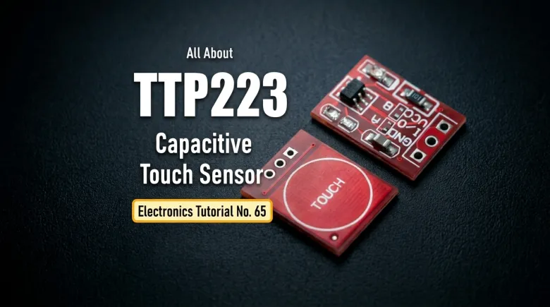

⚡Under The Microscope
This is the bottom of the module which carries the primary TTP223 IC. Both module and chip bear the same name TTP223. Then we have the 3 Pins VCC, Output and GND. These two solder joints labeled A and B - can be used to switch bet 4 diff modes, which I will explain in a moment.

The Front of the module has the circular or rectangular copper area, often with a fingerprint-like icon, which is the sensing surface you touch to activate the switch.
