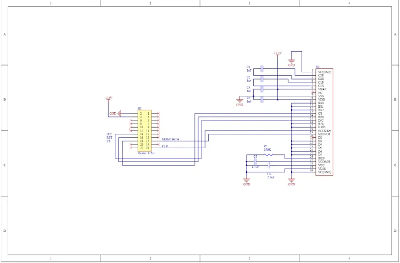

Guide for code at: http://guy.carpenter.id.au/gaugette/2014/01/28/controlling-an-adafruit-spi-oled-with-a-beaglebone-black/ and https://learn.adafruit.com/ssd1306-oled-displays-with-raspberry-pi-and-beaglebone-black/wiring
More details and code: https://github.com/mike-rankin/BeagleBoneBlack_3.3V_SPI_Oled.  This is GitHub account: https://github.com/mike-rankin where you will explore more excellent projects. He is a good DIY maker who designs custom ESP32 IoT projects using Altium Designer, Arduino IDE and Fusion360. Welcome everyone to follow.
