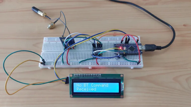

Controller Wiring
The controller setup consists of an Arduino Nano, an RYLR999 module, a voltage level shifter, and an I2C LCD display.
The RYLR999 module communicates with the Arduino using UART serial communication. Since the Arduino Nano operates at 5V logic levels and the RYLR999 module uses 3.3V logic, a bidirectional voltage level shifter is necessary to safely interface both devices.
The VDD pin of the RYLR999 module is connected to the 5V output of the Arduino Nano, while the GND pin connects to the common ground.
For LoRa communication, the TXD_LoRa pin of the module is connected to the LV2 pin of the level shifter, and the corresponding high-voltage output connects to the RX pin of the Arduino Nano. Similarly, the TX pin of the Arduino is routed through another level-shifter channel and connected to the RXD_LoRa pin of the module.
The BLE_TX pin of the Arduino connects through the voltage level shifter to the RXD_BLE pin of the RYLR999 module, while the BLE_RX pin connects through the level shifter to the TXD_BLE pin of the module.
The voltage level shifter itself requires both voltage references to function correctly. Therefore:
-HV pin connects to Arduino 5V
-LV pin connects to Arduino 3.3V
A 16×2 LCD with an I2C interface is connected to the Arduino for real-time monitoring.
The LCD connections are simple:
-VCC → Arduino 5V
-GND → Arduino GND
-SDA → Arduino A4
-SCL → Arduino A5
The LCD displays:
-System initialization messages
-BLE command reception
-LoRa transmission status
-Confirmation responses from the target node
This makes system debugging significantly easier.

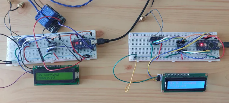

Target Wiring
The target setup is very similar to the controller setup, except that BLE communication is not required here.
The RYLR999 module continuously listens for incoming LoRa messages and forwards received data to the Arduino Nano.
The LoRa TX and RX lines again pass through the bidirectional voltage level shifter before connecting to the Arduino serial pins.
The target node also includes a relay module used for appliance control.
The relay module is powered directly from the Arduino Nano:
-Relay VCC → Arduino 5V
-Relay GND → Arduino GND
The relay input pins are connected to digital output pins of the Arduino:
-D11 controls the bulb
-D12 controls the fan
When the Arduino receives a valid command, it activates the appropriate relay channel.
For the AC bulb, the relay switches the live wire of the AC mains supply. The AC source line is connected to the common terminal of the relay, while the normally open terminal connects to the bulb.
When the relay activates, the contacts close and allow AC current to flow to the bulb.
For the DC fan, the relay is connected in series with the positive 12V power line. Activating the relay completes the circuit and powers the fan.
The target setup also includes a 16×2 I2C LCD connected using the same A4 and A5 I2C pins of the Arduino.
This LCD displays:
-Received LoRa commands
-Relay activation status
-System response messages
⚠️ Since the system switches 240V AC loads, proper electrical safety precautions must always be followed while wiring the relay circuit.
