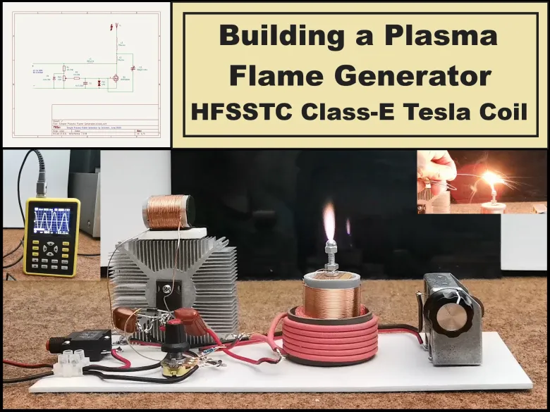

 Plasma flame generator is a device that utilizes the high-frequency, high-voltage output of a Tesla coil to create a continuous plasma discharge that resembles a flame. These "plasma flames" are formed by ionizing the air around the Tesla coil's discharge point. This Tesla Coil is based on a Class-E RF power amplifier that’s tuned to oscillate at around 11MHz, and generates about 150kV output voltage. The main advantages of this types of HFSSTC are that it can be powered from a low-voltage DC supply, it doesn’t make much noise and you don’t need to deal with high-voltage primary power supplies.  An interesting property of high-frequency, high-voltage output is its ability to produce a flame discharge, in which the ionised air (plasma) takes on the appearance of a candle flame.

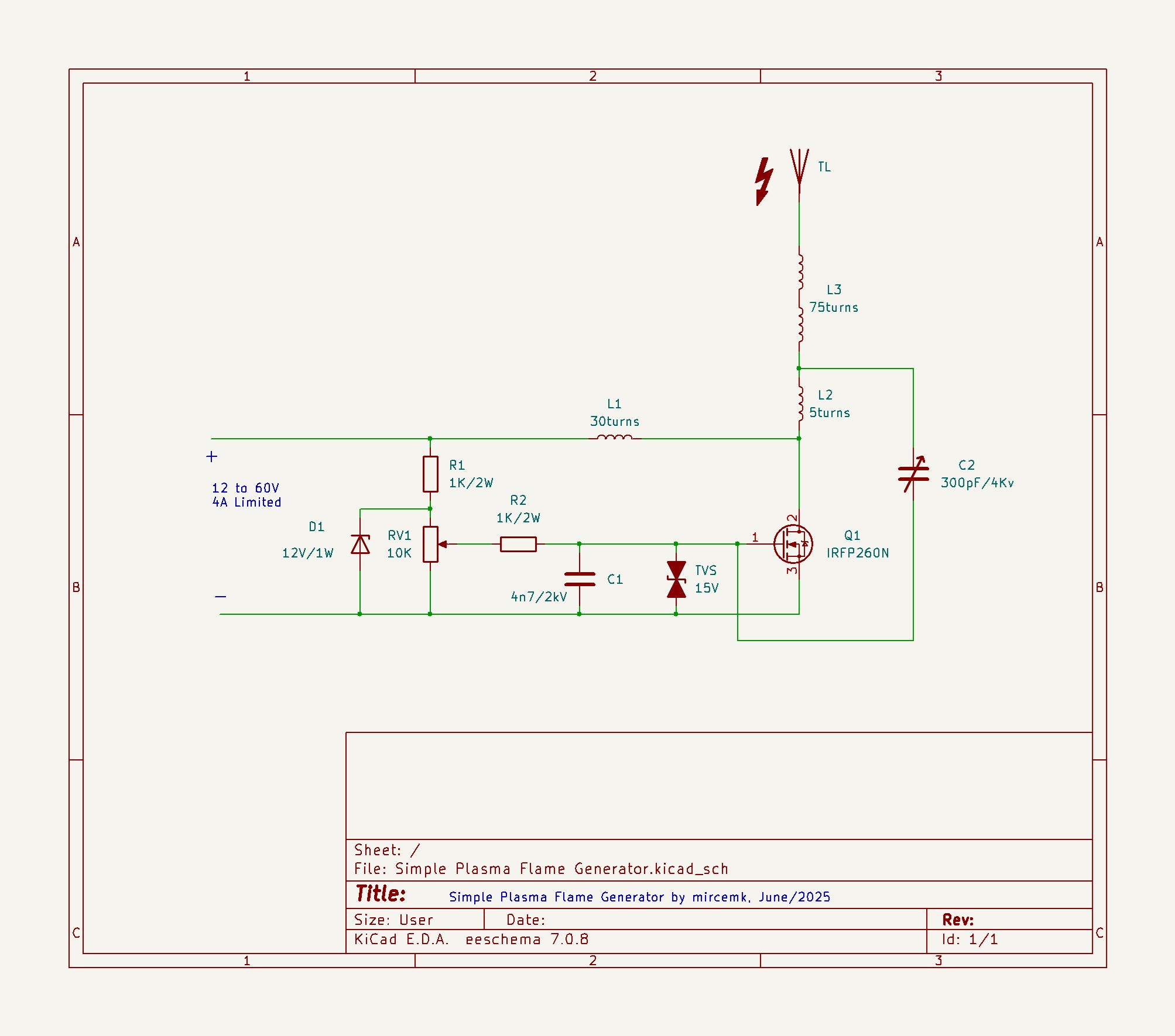

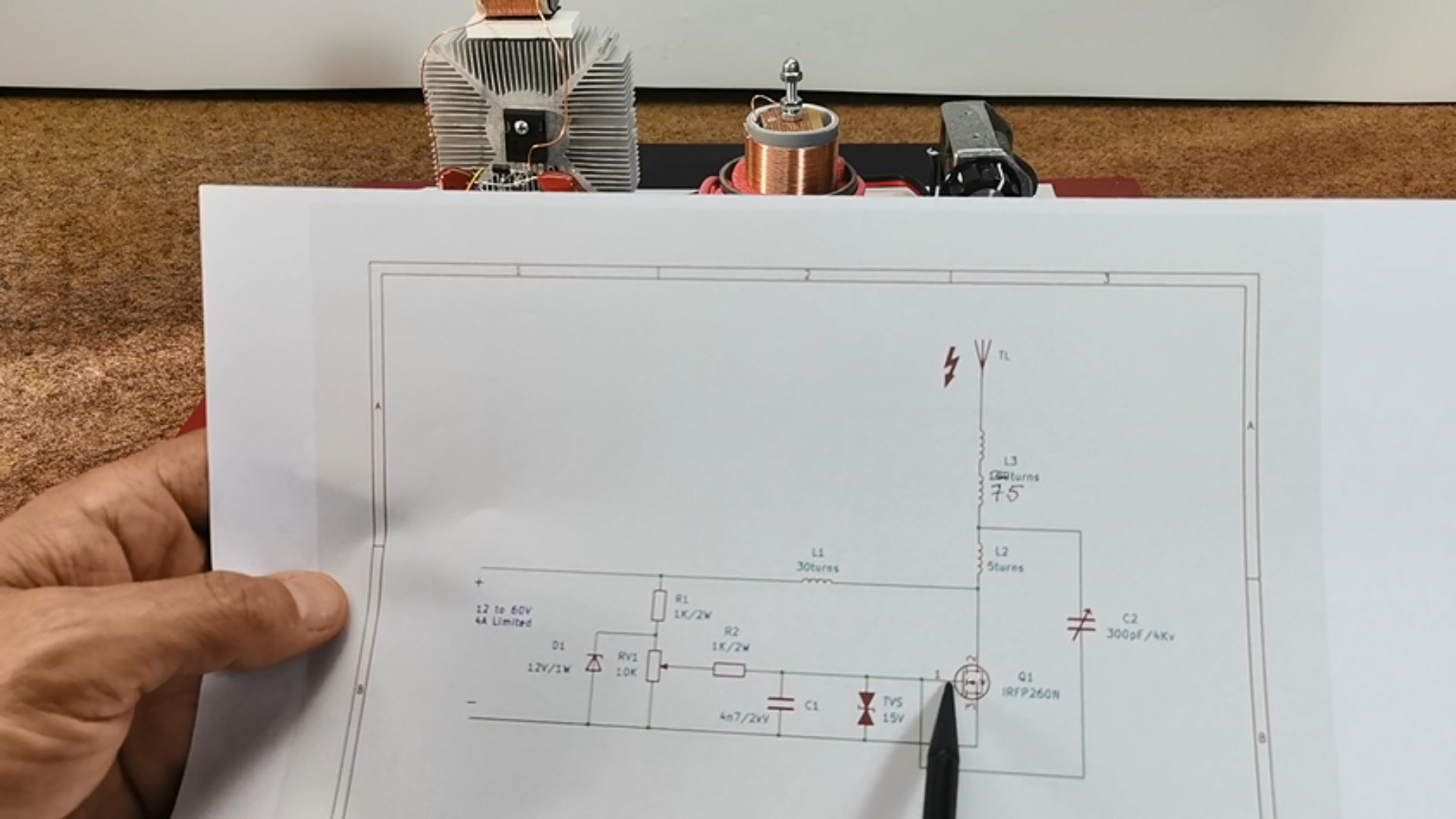

The heart of the circuit is the LC oscillator formed by L2 (2.4μH) and C2 (150pF). The values of these components determine the oscillator’s frequency. In this case, around 11MHz. The voltage divider formed by VR1 and its 1kohm series resistor generates a 5-10V signal at the gate of IRFP260N Mosfet to start the circuit oscillating. The MOSFET should be mounted on a relatively massive heat sink for efficient dissipation of the generated heat. Feedback via capacitor C2 triggers and sustains the oscillation.
 ZD and TVS both aim to prevent the voltage at the gate from exceeding the gate-source voltage specification of the device. L1 have 30 turns of 0.5mm diameter enamelled copper wire on a cylindrical former with diameter of 2.5cm. The primary coil (L2) consists of five to six turns of 1.5mm diameter enamelled copper wire wound on a 5cm diameter former. Instead of a 150pF/4kV capacitor, I used a variable capacitor from an old tube radio, so I can make fine adjustments very easily. For the value of the variable capacitor of 150pF and the primary inductance of 2.4μH gives a frequency of approximately 11MHz. The secondary contains approximately 75 turns of 0.5mm diameter enamelled copper wire wound on a 30mm PVC pipe. An M4 x 12mm stainless steel bolt and a brass acorn nut is used as the breakout point or “top load”.

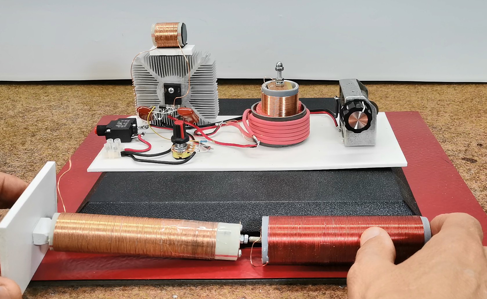

  During the testing of the device I experimented with several types of secondary coils, with the oscillation frequency of the circuit ranging from 6.5 to 8 MHz. I got the best results with this small coil with 75 turns and I use it in the final version.

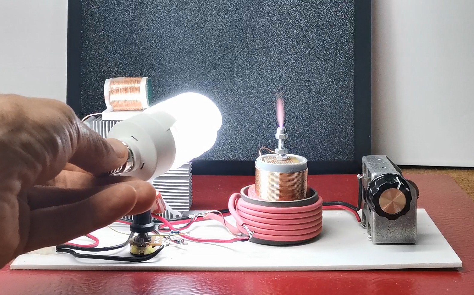

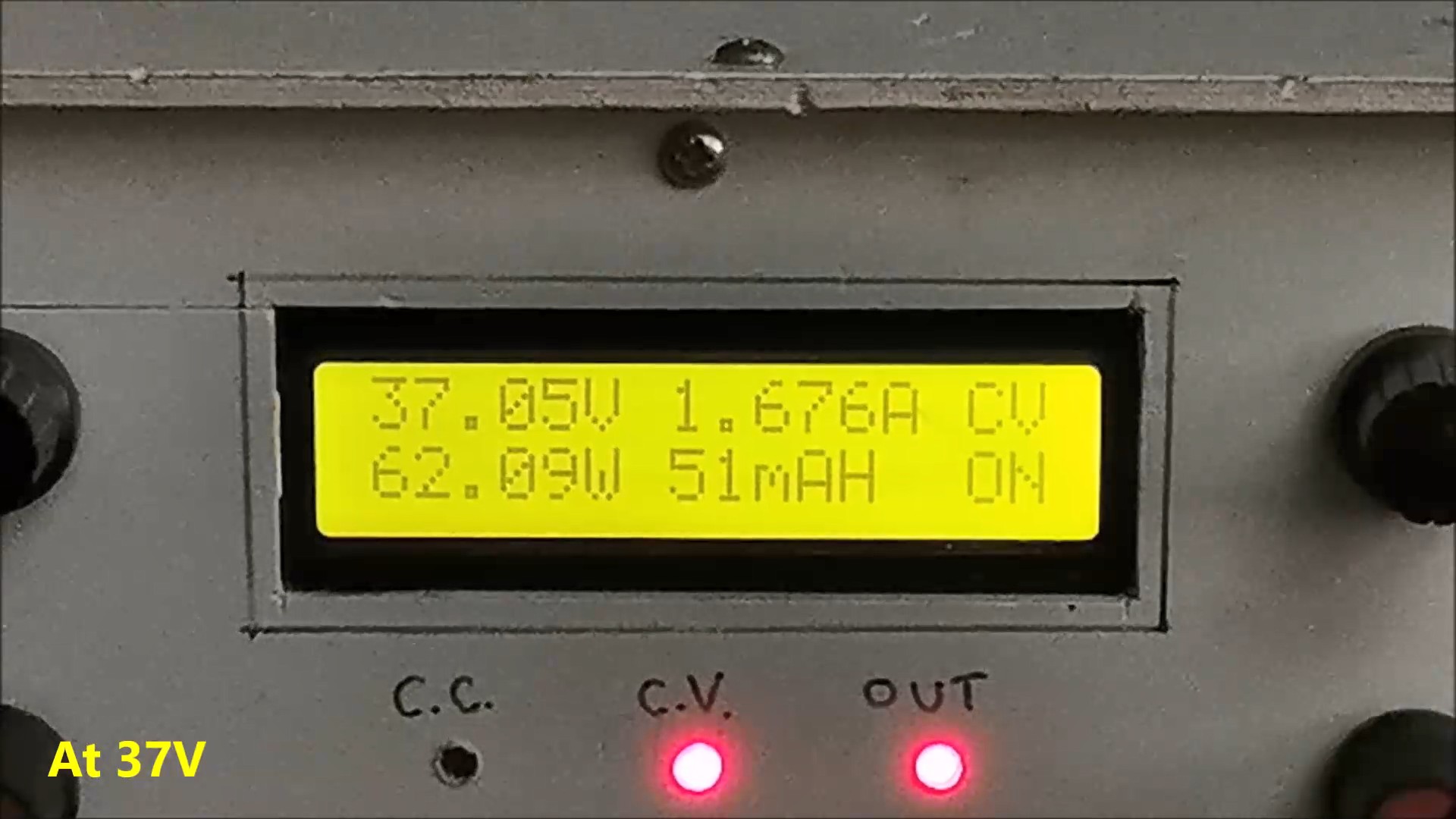

  We set the voltage of the power supply to about 10-12V, and the current is limited to 1A. We set the potentiometer in the far left position and if the circuit has no errors, the current should be approximately 0. We place a CFL bulb close to the secondary coil and gradually turn the potentiometer.
 At a certain point, the bulb should light up, which is a sign that the circuit is oscillating and we can continue with further tuning. Also, if the bulb does not light up at half turn of the potentiometer, we should try to set the variable capacitor in the desired position to oscillate the circuit. To avoid unwanted damage by burning the Mosfet, we should continue testing by gradually increasing the voltage, limiting the current to around 2A. We try to get a stable plasma flame by tapping the topload tip with an insulated screwdriver. In this particular case, the lowest voltage at which the plasma flame was formed is 36V and it works quite stably at 40V and a current of about 1.8 Ampere.

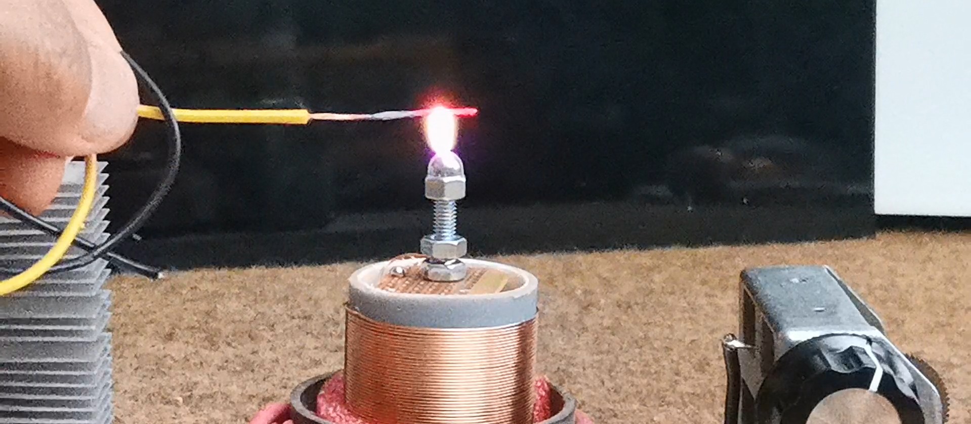

 With these parameters, the device can work for a long time without the risk of damage to any of the elements (most often the mosfet). In the following, I will demonstrate the generation process and the functioning of the Plasma Flame Generator, as well as evidence of the extremely high temperature of the plasma which almost instantly melts metals, such as solder wire and copper.
