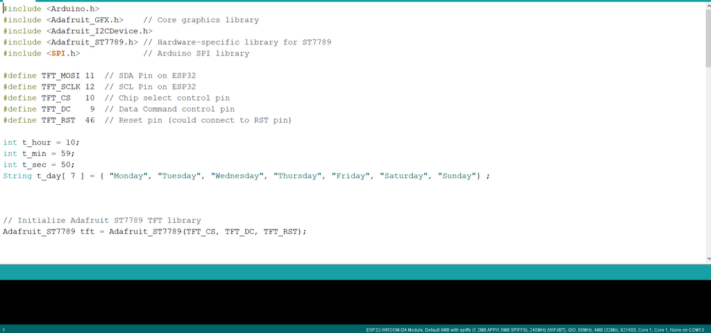

  • Perform the initialization Settings

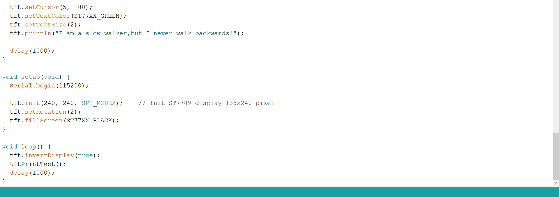

  • Set the screen display content
