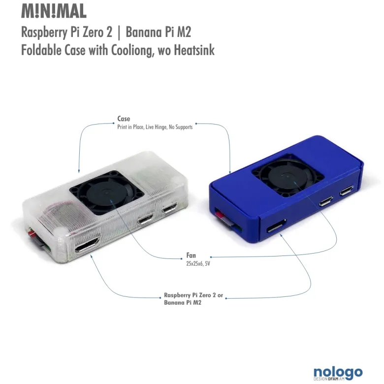

This is the reduced to the max case / housing / sleeve for the Raspberry Pi Zero (2 W) in the version with cooling (we have another model that is prepared without cooling), less is hard to imagine. A foldable print in place housing with live hinge that is less than 2mm bigger than the Raspberry itself. All interfaces are accessible and the board itself is covered and protected. There is a clip in for a 25mm fan without screws. Above that it prints as one piece, the assembly is easy and no tools or screws are needed. Just print (in less than one hour / less than half an hour input shaping) and use…
Construction
The case itself has a wall thickness of 0.8mm, optimized for printing with 0.4mm nozzles. The live hinges are exactly one layer (with a layer height of 0.2 mm) high and all openings can easily be bridged with standard cooling settings. All corners and edges (as far as possible) have rounded with fillets clipped at 35° to avoid any overhangs that would need supports.

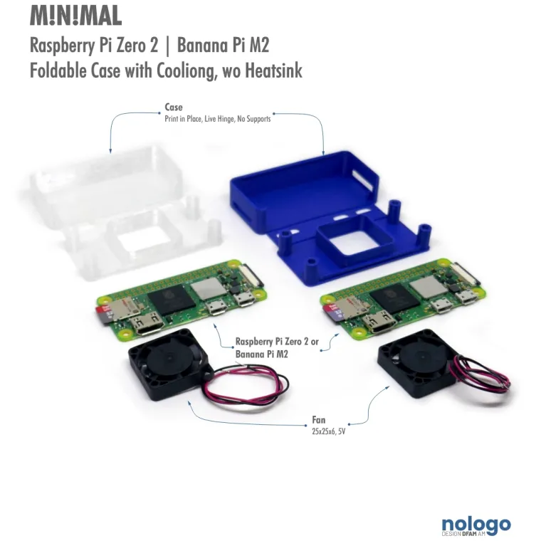

Assembly
First you need to connect the fan (material link below) to the Raspberry, probably by soldering the cables to the board. Please note that the cables have to be connected from the top (see pics) and that the soldering spot on the bottom side is as small as possible. There is a little hole in the case below the pins but since everything is minimized there is not a lot of space… Then click the fan in place, stow the cable and place the Raspberry in the case, fold the top and click in place. Needs a little attention with the hinge side pins, which need to be place and inserted first.
