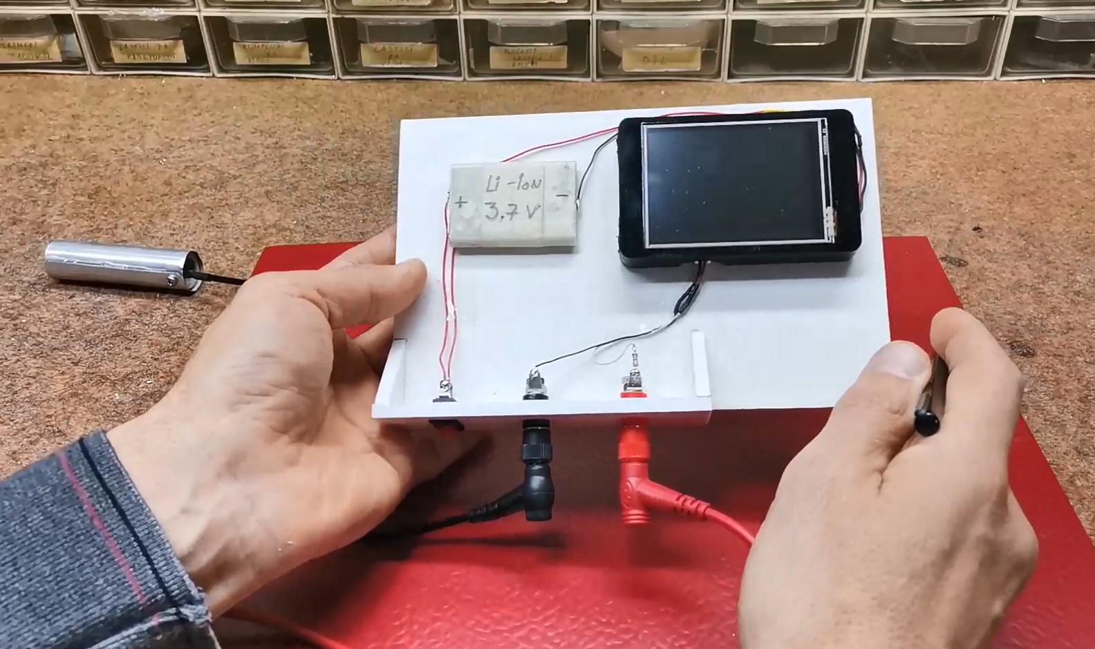

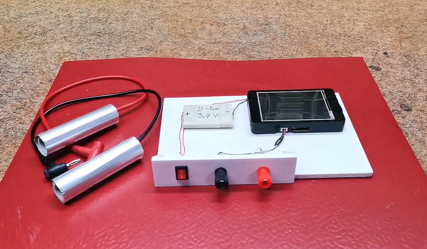

   To better understand the functioning and composition of such a device, I first made a simple functional prototype on a small plastic board. Only a few components are needed to make a fully functional device:
  - CrowPanel 2.4"-ESP32 HMI Dispaly
  - 3.7V Lithium Battery
  - Small Switch
  - Protective resistor 10 Ohm
  - Two metal electrodes through which the therapy is applied
  A lithium battery is connected to the appropriate battery connector via this small switch. The type (capacity) of the battery is not critical and any shape and capacity can be used. Of course, we need to pay attention to the polarity. The electrodes are connected to the audio output of the HMI displaymodule via a protective resistor. The electrodes can be metal rods made of stainless steel, or for example aluminum cylinders as in my case. Also, for this purpose can serve laminated pertinax boards used for making PCBs. I made assembled test device from PVC material based on the appearance of several similar commercial devices.

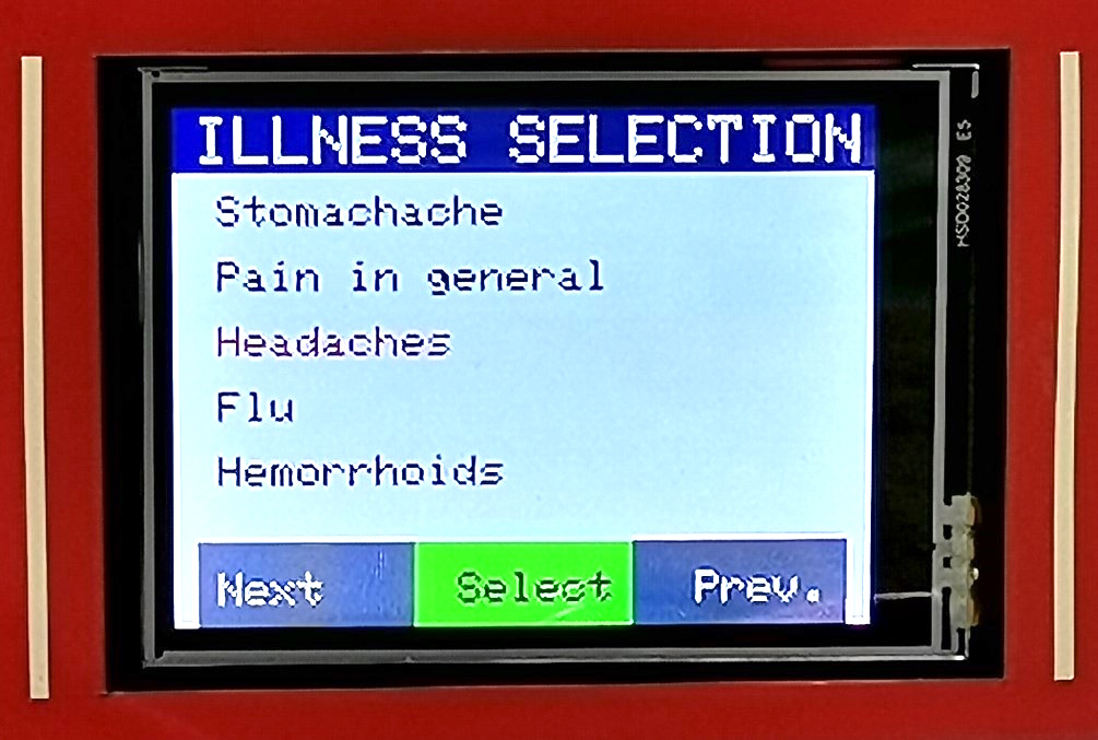

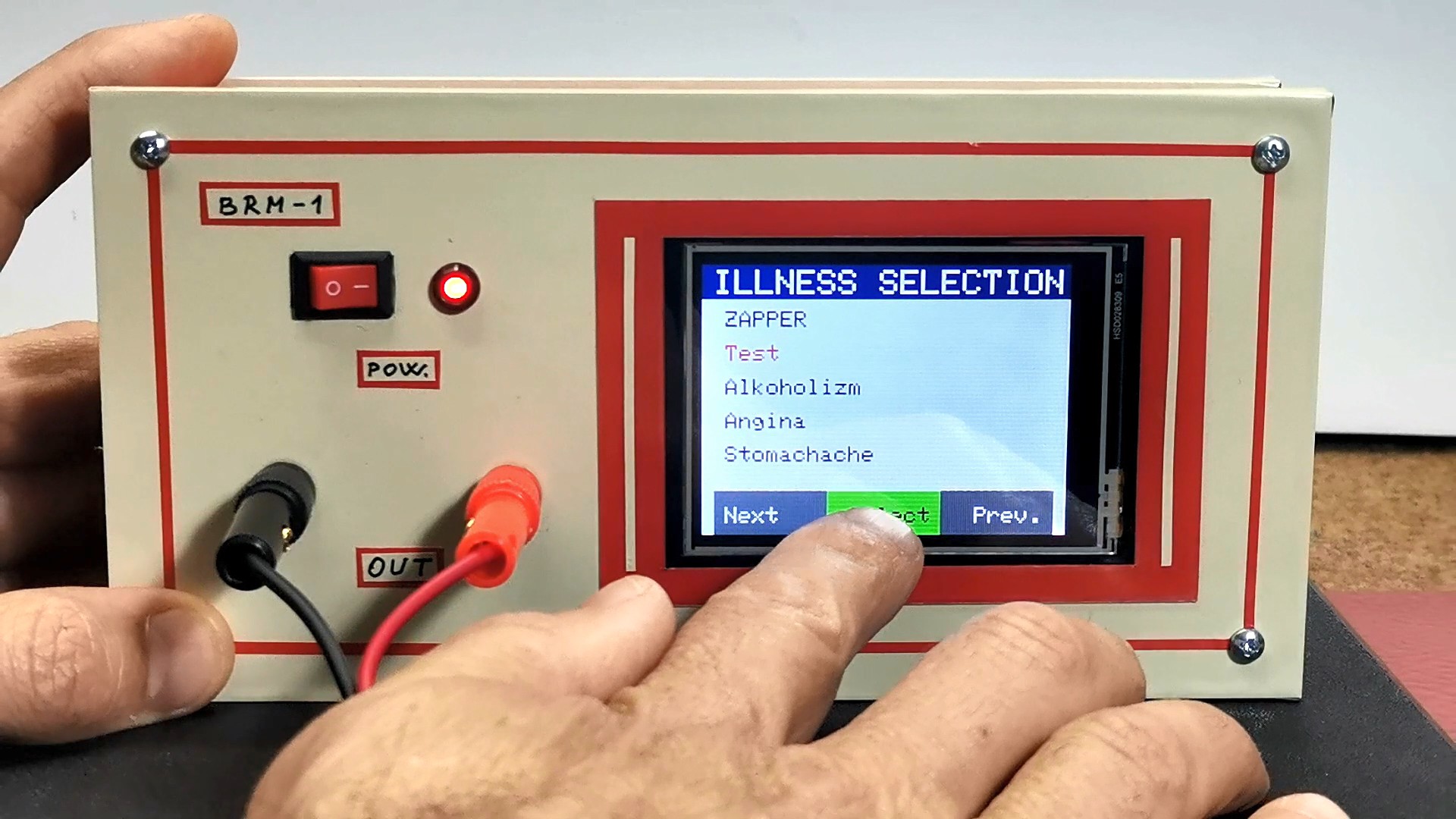

When turning on the device, the initial information screen appears, and according to the indicated information, by touching the screen anywhere, we enter the "ILNESS SELECTION" menu to select the disease we want to treat. Here we have two buttons "PREV" and "NEXT" with which we can move through the diseases.

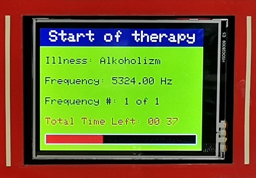

As you can see, the selected disease, the current frequency, and the total number of frequencies for the selected disease are marked here. At the bottom, there is a progress bar on which the elapsed time of the entire therapy is graphically presented. We have the same information in the last information line where the remaining time for therapy is displayed.

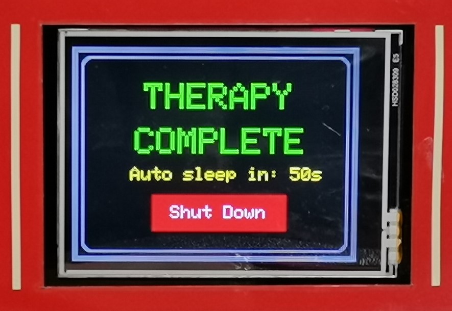

 After the therapy is completed, the last screen automatically appears, informing us that the therapy is over, under which information is a red button to turn off the device.
If we do not turn off the device manually within one minute, the auto sleep option will be activated, so as not to waste the battery.
 When turning off, the device does not turn off completely, but goes into a so-called deep sleep mode, during which the consumption is almost zero. In case we have started a long therapy unnecessarily by mistake, we can stop it by double-clicking on the upper half of the screen, which will put the device into deep sleep mode again.
  From a hardware point of view, as you can see it's extremely simple. The display device is connected to a 3.7V lithium battery, a power button, and two electrodes through which the therapy is applied. The battery is connected to the appropriate place, and on the board there is an electronic circuit that regulates its charging when the device is connected to an external source via a UCB-C connector.  And, the electrodes are connected to the appropriate place, which actually represents the output of the D-class amplifier. To protect the amplifier output from short-circuiting the electrodes, a resistor with a value of 10 Ohms is connected in series to the output of one electrode. Double-sided laminated pertinax boards can be used for electrodes with an indication that the copper must not be varnished or insulated in any way. There is no problem if they darken (oxidize) because even then the conductivity remains. Alternatively, you can make your own electrodes from thin aluminum sheet rolled around a plastic tube, as in this case. The multifunctionality and practicality of this device actually lies in the fact that we can very easily enter, edit, and delete frequencies or sequences ourselves through a simple user-friendly web interface. Now let me explain to you what what I said earlier means practically. We need a PC or laptop with the ability to connect to a Wi-Fi network. We turn on the device and search for the Wi-Fi network with the name: "ESP32-RIFE-AP" and connect to it with the password: 12345678. This is actually the Wi-Fi network generated by this small device. Now we open Google Chrome or any other web browser and in the address field we enter 192.168.4.1 and press enter.

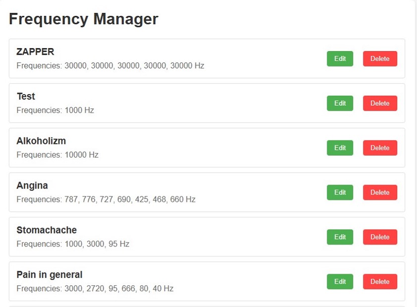

 The "Frequency Manager" web interface appears on the screen through which we can wirelessly enter information into the device. At the beginning of the screen we can see the already entered diseases, in our case only the "ZAPPER" function. Under the name of the disease we can see the number and value of the frequencies. Here we have 5 times 30 kHz, meaning "ZAPPER" therapy lasting 5 minutes. Then comes the screen for entering a new disease. We enter the name, with a note that special characters are not allowed. And now the most important part, the places for entering frequencies. As we can see, there are a total of ten fields in which we can enter different frequencies. A curiosity is the fact that we can also enter frequencies with great accuracy (two decimal places), so this device can also successfully simulate a Schumann Resonance frequency generator by entering frequencies with a value of 7.83 Hz. At the end we have the Add Disease button with which we confirm the previously entered information. Now we can see this change on the device screen. Next, let's enter a few more examples. They all appeared on the device display. In case we make a mistake in one of the frequencies when entering, or we have information about a different sequence, we can edit each previously entered disease by pressing the "EDIT" button on the right side of the disease. After editing, we press the "UPDATE DISEASE" button, or "CANCEL". As we can also see next to each disease, to the right of the "EDIT" button there is also a red "DELETE" button with which we can completely delete the disease. All these changes are currently transmitted to the device via the Wi-Fi network. The same procedure for setting up the device can also be performed with a tablet or smartphone.

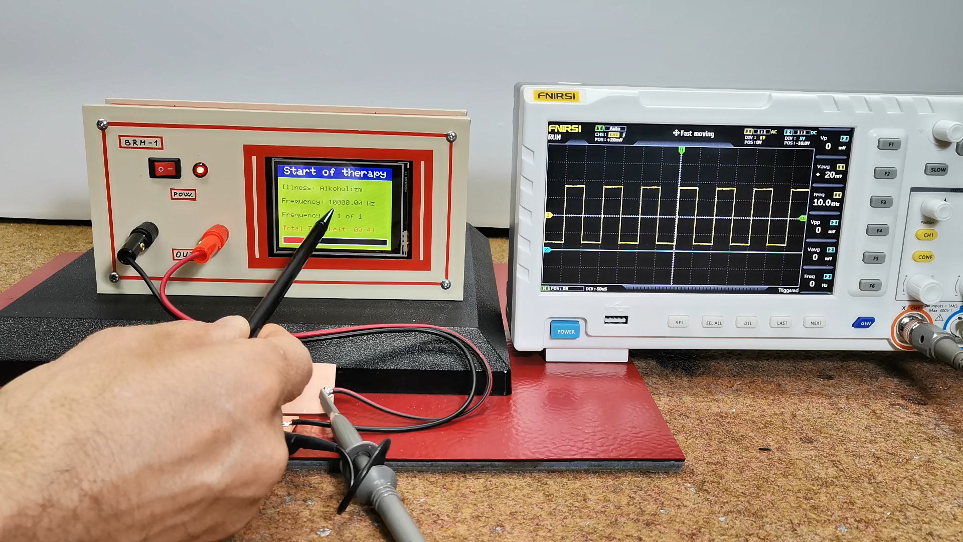

  And now, perhaps the most important part, let's check whether the signal generated at the output corresponds to the description so far. This is actually proof whether the device works from an electronic point of view. I have no knowledge to comment on the effects in a medical sense. For this purpose I will use an Oscilloscope, where the signal should have a rectangular shape and the frequency should be identical to the one we read on the device. Let me just mention that certain small deviations may occur due to the tolerance of the oscilloscope.
