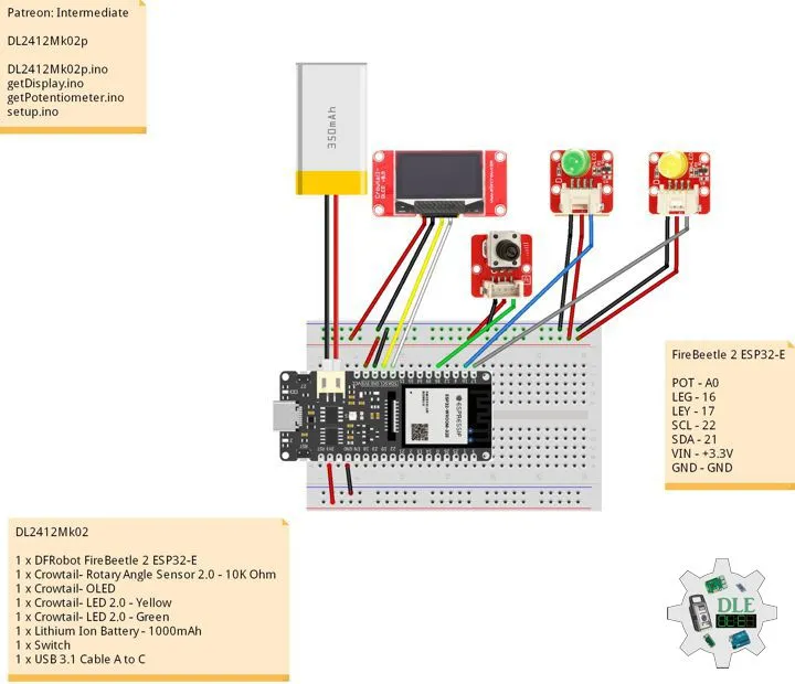

DL2412Mk02
1 x DFRobot FireBeetle 2 ESP32-E
1 x Crowtail- Rotary Angle Sensor 2.0 - 10K Ohm
1 x Crowtail- OLED
1 x Crowtail- LED 2.0 - Yellow
1 x Crowtail- LED 2.0 - Green
1 x Switch
1 x USB 3.1 Cable A to C
POT - A0
LEG - 16
LEY - 17
SCL - 22
SDA - 21
VIN - +3.3V
GND - GND
