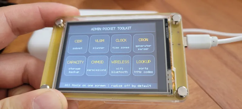

Pocket Admin Toolkit v2
Pocket Admin Toolkit v2 turns a small 2.8-inch ESP32 touchscreen into a practical toolbox for Linux, networking and everyday system administration.
The first version started as a simple experiment: instead of leaving an ESP32 Bitcoin miner running without much practical use, I turned it into a compact admin toolkit.
Version 2 expands that idea with more tools, a cleaner interface and wireless diagnostics.
What is included?
Pocket Admin Toolkit v2 contains eight main tools:
  • CIDR Calculator — subnet, broadcast, host range, mask and available hosts
  • VLSM Planner — quickly divide a network into smaller subnets
  • World Clock / Time Converter — compare selected time zones offline
  • Cron Generator & Parser — create and understand cron expressions
  • Capacity Planner — estimate storage and backup requirements
  • chmod Calculator — visual Linux permissions calculator
  • Wireless Scanner — scan nearby Wi-Fi networks and BLE devices
  • Quick Reference — common HTTP status codes and TCP/UDP ports
The idea is simple: get quick answers directly from a small device without opening another browser tab, searching documentation or reaching for a laptop.

The project is built with C++ using the Arduino framework and PlatformIO and runs on the Elecrow 2.8-inch ESP32 CrowPanel.
Hardware
  • Elecrow CrowPanel 2.8-inch ESP32 display
  • ESP32-WROOM-32
  • 320 × 240 touchscreen
  • Wi-Fi and Bluetooth Low Energy
  • USB-C cable for programming
