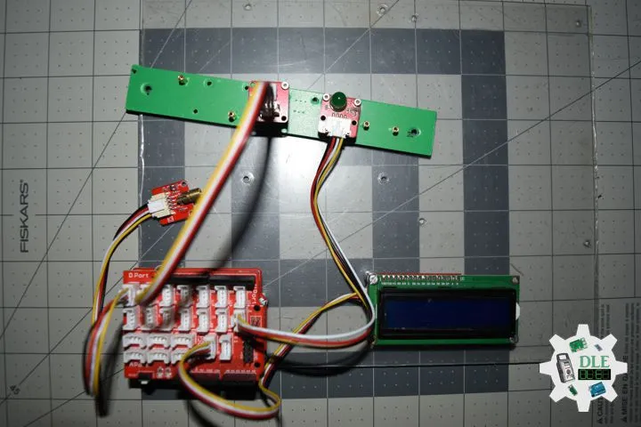

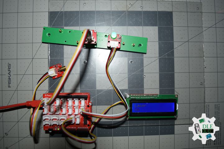

Crowtail - Laser Pointer 2.0
A change of Laser Pointer is that we make it compatible with Crowtail base board, you can use it more easier than before. This laser pointer or laser pen is a small handheld device with a laser diode emitting a very narrow coherent low-powered laser beam of visible light, it is frequently used in lecture halls and demonstrations to point at topics of interest on a presentation board. In a school setting, they have become ubiquitous, and they are very useful teaching aids. Please note that DO NOT Point this module to eyes directly, It may cause some blindness, glare and afterimages. Application Idea: Pointing, Industrial and research use, Leisure and entertainment, Etc...
-Supply voltage: 5 Volt
-Power: 5mW
-Wavelength: 650nm
DL2507Mk02
1 x Crowduino Uno - SD
1 x Crowtail - Base Shield
1 x Crowtail - I2C LCD
1 x Crowtail - Laser Pointer 2.0
1 x Crowtail - Switch
1 x Crowtail - LED(Green)
1 x USB Battery Pack
1 x USB Mini-B Cable

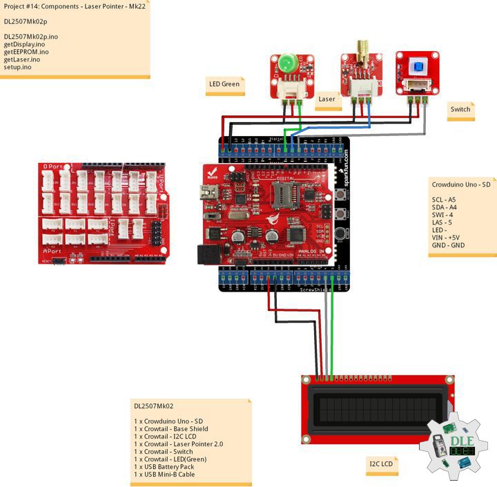

Crowduino Uno - SD
SCL - A5
SDA - A4
SWI - 4
LAS - 5
LED - 6
VIN - +5V
GND - GND
DL2507Mk02p
DL2507Mk02p.ino
getDisplay.ino
getEEPROM.ino
getLaser.ino
setup.ino
