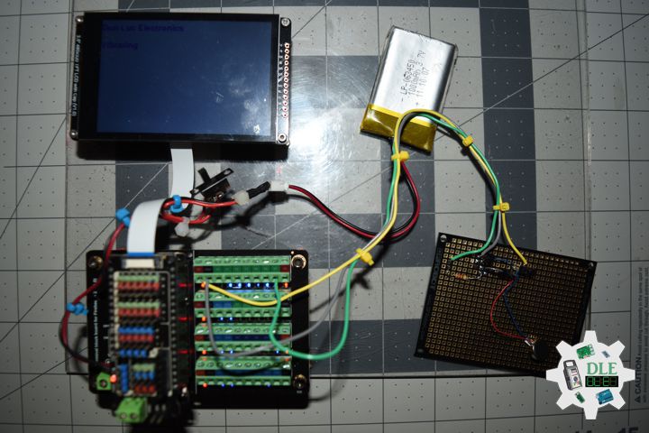

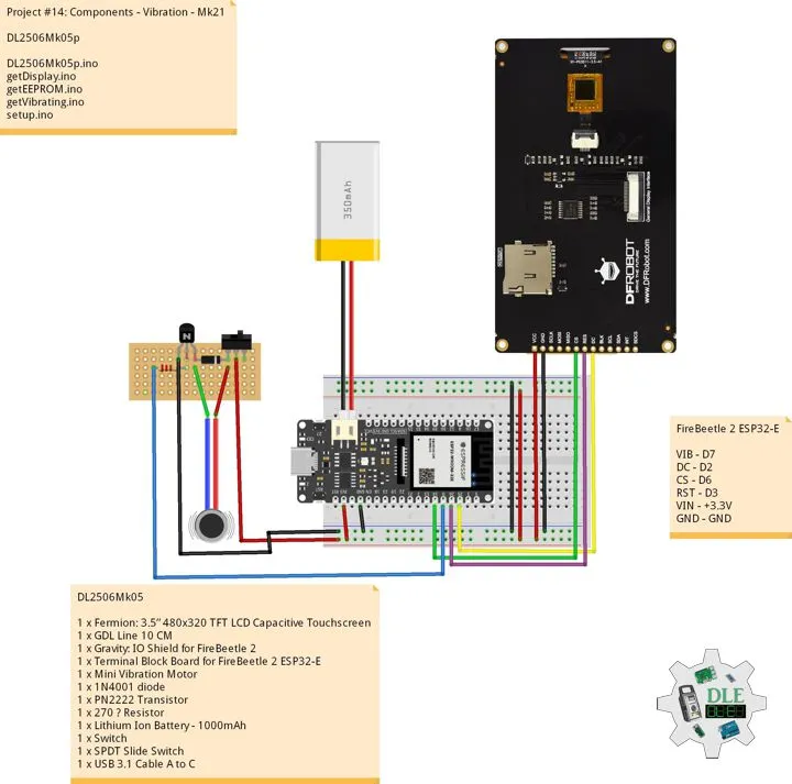

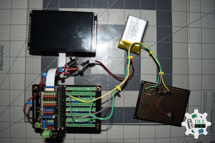

Mini Vibration Motor
Just as small as a fingernail, this 10*2.7mm mini vibration motor features a strong vibration, low noise, easy to embed, and long lifespan. Powered by voltage from 1.5V to 4.2V, it will vibrate once powered on, and the higher the voltage is, the faster the vibration frequency will be. It is widely applicable to projects like mobile phones, watches, facial massager, electric toys, etc.
DL2506Mk05
1 x DFRobot FireBeetle 2 ESP32-E
1 x Fermion: 3.5” 480x320 TFT LCD Capacitive Touchscreen
1 x GDL Line 10 CM
1 x Gravity: IO Shield for FireBeetle 2
1 x Terminal Block Board for FireBeetle 2 ESP32-E
1 x Mini Vibration Motor
1 x 1N4001 diode
1 x PN2222 Transistor
1 x 270 Ohm Resistor
1 x Switch
1 x SPDT Slide Switch
1 x USB 3.1 Cable A to C
VIB - D7
DC - D2
CS - D6
RST - D3
VIN - +3.3V
GND - GND
DL2506Mk05p
DL2506Mk05p.ino
getDisplay.ino
getEEPROM.ino
getVibrating.ino
setup.ino
