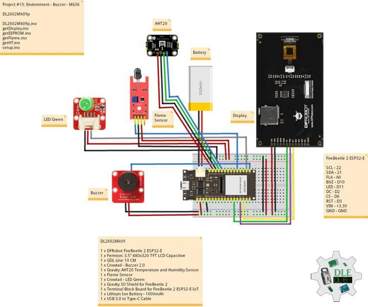

Crowtail - Buzzer 2.0
The buzzer module is for making sound in your project. It sounds when activated by a logic HIGH signal. Connect the buzzer to any of the D (digital) ports of you can easily make it sounds with setting the related ports to logic HIGH. The buzzer module can be also connected to an analog pluse-width modulation (PWM) output to generate various of tones.
DL2602Mk09
1 x DFRobot FireBeetle 2 ESP32-E
1 x Fermion: 3.5” 480x320 TFT LCD Capacitive
1 x GDL Line 10 CM
1 x Crowtail - Buzzer 2.0
1 x Gravity: AHT20 Temperature and Humidity Sensor
1 x Flame Sensor
1 x Crowtail - LED Green
1 x Gravity: IO Shield for FireBeetle 2
1 x Terminal Block Board for FireBeetle 2 ESP32-E IoT
1 x USB 3.0 to Type-C Cable
