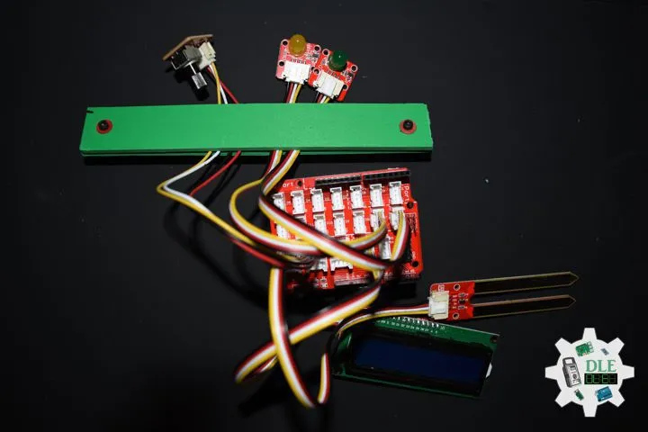

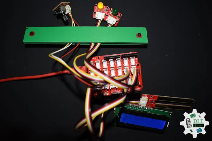

rowtail - Rotary Angle Sensor 2.0
This rotary angle sensor may also be known as potentiometer that produces analog output between 0 and 3.3-5 Volt. The angular range is 300 degrees with a linear change in value. The resistance value is 10k ohms, perfect for Arduino use. Some applications like smart light control, volume control, only you can not think of things, no impossible things.

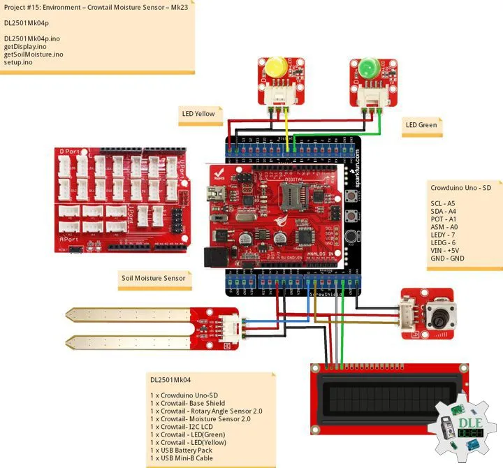

DL2501Mk04
1 x Crowduino Uno - SD
1 x Crowtail - Base Shield
1 x Crowtail - Rotary Angle Sensor 2.0
1 x Crowtail - Moisture Sensor 2.0
1 x Crowtail - I2C LCD
1 x Crowtail - LED(Green)
1 x Crowtail - LED(Yellow)
1 x USB Battery Pack
1 x USB Mini-B Cable
Crowduino Uno - SD
SCL - A5
SDA - A4
POT - A1
ASM - A0
LEDY - 7
LEDG - 6
VIN - +5V
GND - GND
DL2501Mk04p
DL2501Mk04p.ino
getDisplay.ino
getSoilMoisture.ino
setup.ino
