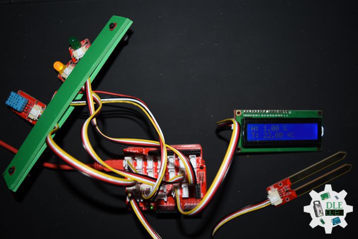

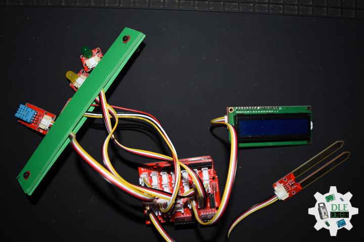

Crowtail - Temperature and Humidity Sensor 2.0
This module can help you detect the temperature and humidity of the environment of your house. The module contains a DHT11 Temperature and Humidity sensor that is a complex sensor with a calibrated digital signal out. It uses digital module acquisition technology and the temperature & humidity sensor technology. The sensor consists of a resistance-type moisture element and an NTC temperature measuring element. Because of the single-wire serial interface, it is easy to use the module.
-Work Voltage: 3.3 Volt ~ 5 Volt
-Measuring Range: Humidity: 20% - 90% RH
-Measuring Range: Temperature: 0 ~ 50 °C
-Signal Collecting Period: 2S
-Accuracy: Humidity: ±5% RH
-Accuracy: Temperature: ±2°C

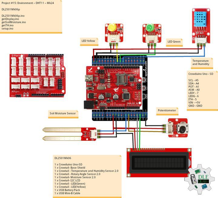

DL2501Mk06
1 x Crowduino Uno - SD
1 x Crowtail - Base Shield
1 x Crowtail - Temperature and Humidity Sensor 2.0
1 x Crowtail - Rotary Angle Sensor 2.0
1 x Crowtail - Moisture Sensor 2.0
1 x Crowtail - I2C LCD
1 x Crowtail - LED(Green)
1 x Crowtail - LED(Yellow)
1 x USB Battery Pack
1 x USB Mini-B Cable
Crowduino Uno - SD
SCL - A5
SDA - A4
POT - A1
ASM - A0
LEDY - 7
LEDG - 6
ITH - 5
VIN - +5V
GND - GND
DL2501Mk06p
DL2501Mk06p.ino
getDisplay.ino
getSoilMoisture.ino
getTH.ino
setup.ino
