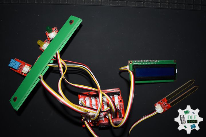

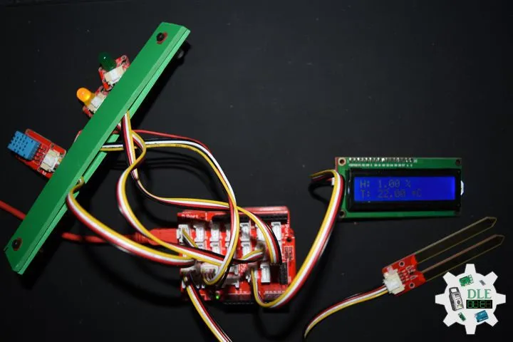

DL2501Mk08
1 x Crowduino Uno - SD
1 x Crowtail - Base Shield
1 x Crowtail - Temperature and Humidity Sensor 2.0
1 x Crowtail - Rotary Angle Sensor 2.0
1 x Crowtail - Moisture Sensor 2.0
1 x Crowtail - I2C LCD
1 x Crowtail - LED(Green)
1 x Crowtail - LED(Yellow)
1 x USB Battery Pack
1 x USB Mini-B Cable
Crowduino Uno - SD
SCL - A5
SDA - A4
POT - A1
ASM - A0
LEDY - 7
LEDG - 6
ITH - 5
VIN - +5V
GND - GND
DLE-EEPROM-UID-UnoMk001
DLE-EEPROM-UID-UnoMk001.ino
getEEPROM.ino
setup.ino
DL2501Mk08p
DL2501Mk08p.ino
getDisplay.ino
getEEPROM.ino
getSoilMoisture.ino
getTH.ino
setup.ino
