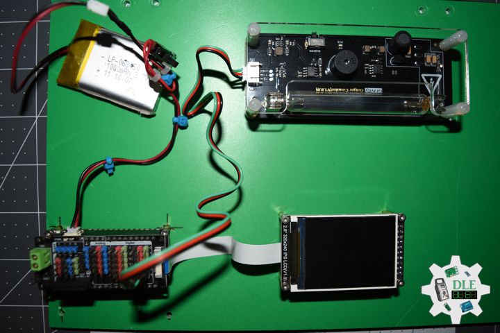

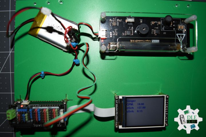

Gravity: Geiger Counter Module Ionizing Radiation Detector
Ionizing radiation, an invisible and intangible enemy, exists not only in nuclear power plant reactors. In fact, we are bombarded by radiation from the surrounding environment and outer space all the time, but fortunately our body is strong enough to resist the natural background radiation.
No active contact does not mean that high-energy ionizing radiation will not be encountered. Natural marble building materials, ore gems with different colors, and "negative ion powder" of unknown composition may contain different amounts of radioactive elements. With the use of a Geiger counter, these radioactive sources have nowhere to hide.
In addition, the Geiger counter is a good random number generator, and undetermined high-energy particle ionization events can provide enough random entropy to get you a truly random number, rather than a fixed random sequence based on a random algorithm.

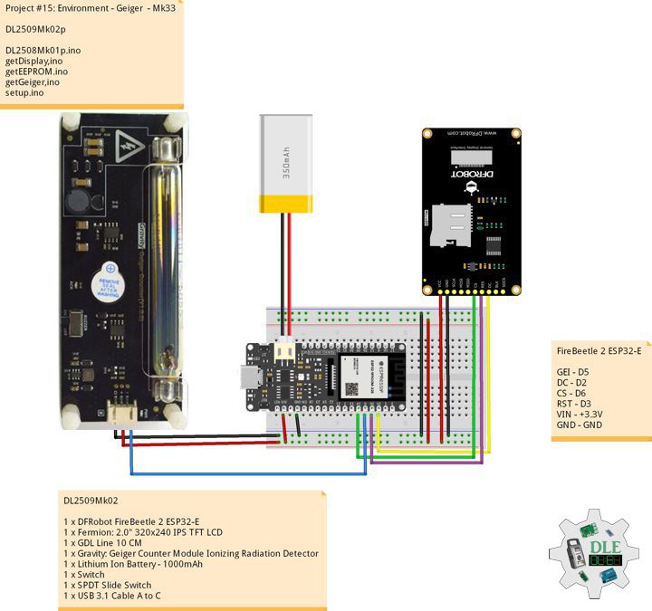

DL2509Mk02
1 x DFRobot FireBeetle 2 ESP32-E
1 x Fermion: 2.0" 320x240 IPS TFT LCD
1 x GDL Line 10 CM
1 x Gravity: IO Shield for FireBeetle 2
1 x Gravity: Geiger Counter Module Ionizing Radiation Detector
1 x Switch
1 x SPDT Slide Switch
1 x USB 3.1 Cable A to C
DL2509Mk02p
DL2508Mk01p.ino
getDisplay,ino
getEEPROM.ino
getGeiger,ino
setup.ino
