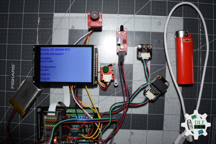

Gravity: I2C SD2405 RTC Module
This is an extremely accurate I2C Real Time Clock (RTC) with crystal compensation, inner chargeable battery. The SD2405AL is available in industrial temperature ranges. The SD2405AL is dual power supply system. When the primary power supply goes down to an assigned value or resumes from low power, the system can switch between the primary power supply and battery automatically. Even there is no external power, it can still work for 5~8 years, 1uA ultra-low power consumption (inner battery).
DL2603Mk04

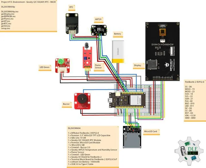

1 x DFRobot FireBeetle 2 ESP32-E
1 x Fermion: 3.5” 480x320 TFT LCD Capacitive
1 x GDL Line 10 CM
1 x Gravity: I2C SD2405 RTC Module
1 x Fermion: MicroSD Card Module
 1 x MicroSD 2 GB
1 x Crowtail - Buzzer 2.0
1 x Gravity: AHT20 Temperature and Humidity Sensor
1 x Flame Sensor
1 x Crowtail - LED Green
1 x Gravity: IO Shield for FireBeetle 2
1 x Terminal Block Board for FireBeetle 2 ESP32-E IoT
1 x USB 3.0 to Type-C Cable
DL2603Mk04p
DL2603Mk04p.ino
getDisplay.ino
getEEPROM.ino
getFlame.ino
getHT.ino
getRTC.ino
getSD.ino
setup.ino
