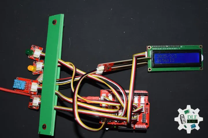

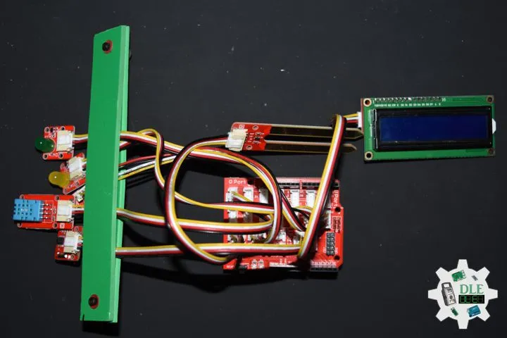

Crowtail - RTC 2.0
If you want to make your own electronic watch a RTC module is necessary to generate you the right time, with very low power consumption. This tiny RTC module is based on the clock chip DS1307 which communicates with microcontrollers with I2C protocol. The clock/calendar provides seconds, minutes, hours, day, date, month, and year information. The end of the month date is automatically adjusted for months with fewer than 31 days, including corrections for leap year. This module is really low power consumption, it can serves you more than a month with a CR1220 battery.

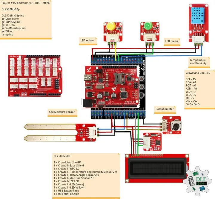

DL2502Mk02
1 x Crowduino Uno - SD
1 x Crowtail - Base Shield
1 x Crowtail - RTC 2.0
1 x Crowtail - Temperature and Humidity Sensor 2.0
1 x Crowtail - Rotary Angle Sensor 2.0
1 x Crowtail - Moisture Sensor 2.0
1 x Crowtail - I2C LCD
1 x Crowtail - LED(Green)
1 x Crowtail - LED(Yellow)
1 x USB Battery Pack
1 x USB Mini-B Cable
Crowduino Uno - SD
SCL - A5
SDA - A4
POT - A1
ASM - A0
LEDY - 7
LEDG - 6
ITH - 5
VIN - +5V
GND - GND
DL2502Mk02p
DL2502Mk02p.ino
getDisplay.ino
getEEPROM.ino
getRTC.ino
getSoilMoisture.ino
getTH.ino
setup.ino
