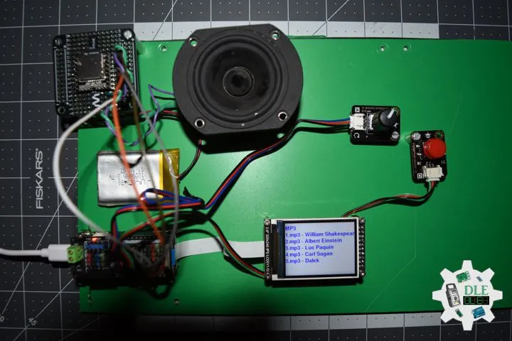

MP3
1.mp3 - William Shakespeare
2.mp3 - Albert Einstein
3.mp3 - Luc Paquin
4.mp3 - Carl Sagan
5.mp3 - Dalek

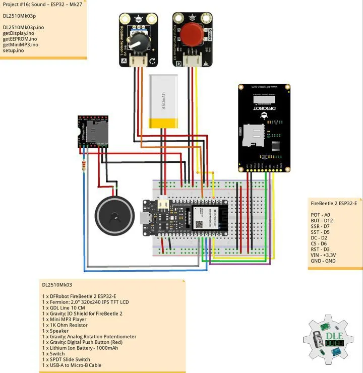

DL2510Mk03
1 x DFRobot FireBeetle 2 ESP32-E
1 x Fermion: 2.0" 320x240 IPS TFT LCD
1 x GDL Line 10 CM
1 x Gravity: IO Shield for FireBeetle 2
1 x Mini MP3 Player
1 x 1K Ohm Resistor
1 x Speaker
1 x Gravity: Analog Rotation Potentiometer
1 x Gravity: Digital Push Button (Red)
1 x Switch
1 x USB 3.0 to Type-C Cable
DL2510Mk03p
DL2510Mk03p.ino
getDisplay.ino
getEEPROM.ino
getMiniMP3.ino
setup.ino

Code
Schematic and Layout
