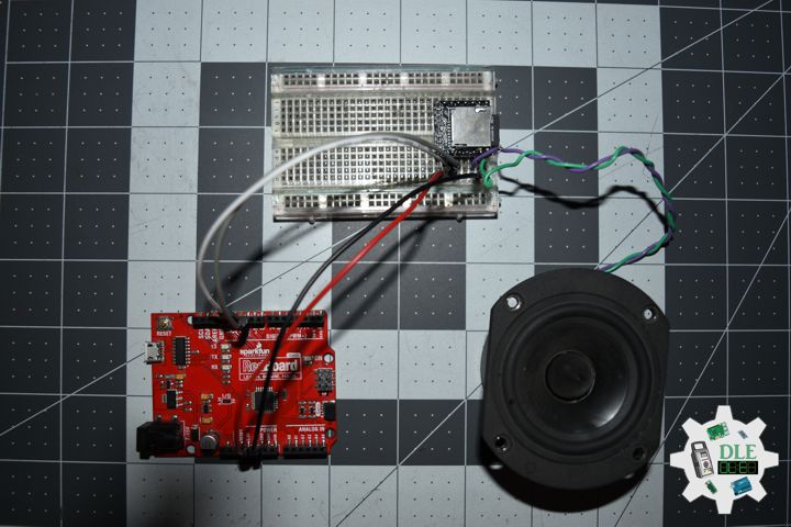

Mini MP3 Player  is a compact and inexpensive MP3 module that can be connected directly to the speaker. The module can be used alone with a battery power supply, speaker, and keypad, or through the serial port control, as the Arduino UNO compatible board or any microcontroller with a serial port module. The module itself perfectly integrated hardware decodes MP3, WAV, and WMA's. The software supports TF card drivers to support FAT16, FAT32 file systems. This can be done by the simple serial command that plays the specified music, as well as how to play music and other functions, easy to use, stable and reliable.

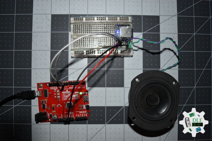

Play next MP3 every 8 second.
1.mp3 - William Shakespeare
2.mp3 - Albert Einstein
3.mp3 - Luc Paquin
4.mp3 - Carl Sagan
5.mp3 - Dalek
DL2510Mk02

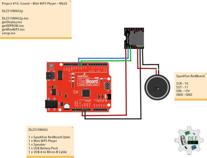

1 x SparkFun RedBoard Qwiic
1 x Mini MP3 Player
1 x Speaker
1 x USB Battery Pack
1 x USB-A to Micro-B Cable
DL2510Mk02p
DL2510Mk02p.ino
getEEPROM.ino
getMiniMP3.ino
setup.ino
