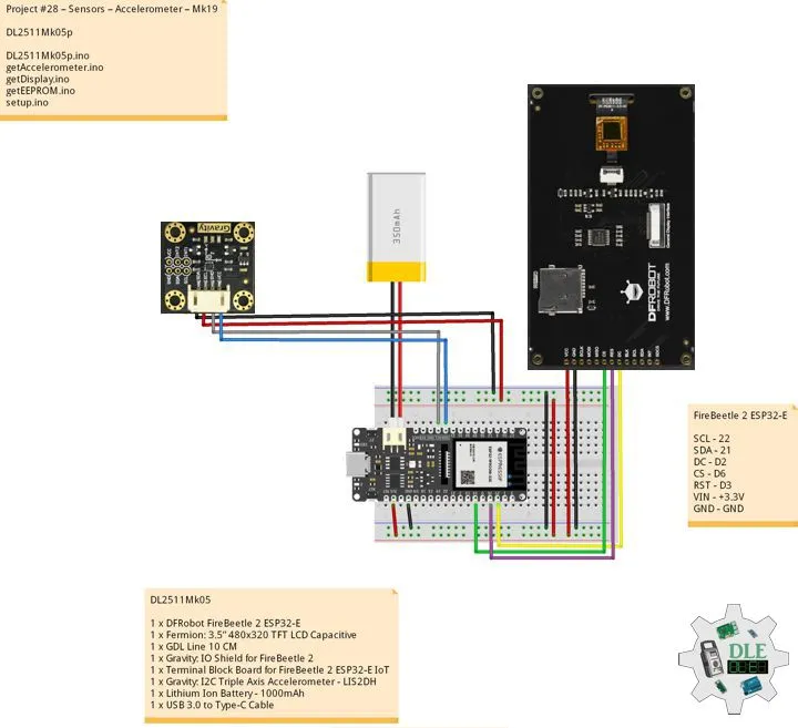

Gravity: I2C Triple Axis Accelerometer - LIS2DH
DFRobot presents the ultra low-power triple axis accelerometer. This device is based around a MEMS LIS2DH chip solution and has high-performance ultra-low power mode. The module is fitted with a Gravity I2C interface for easy plug and play integration in to your projects. The build in LDO power management chip gives you a wide range of input voltages, from 3.3 – 5 Volt. The on-board I2C level conversion also makes it compatible with 3.3 and 5 Volt  devices. Compared to traditional ADXL345, the LIS2DH accelerometer has advantages such as extra stability and more efficient power consumption.
DL2511Mk05
1 x DFRobot FireBeetle 2 ESP32-E
1 x Fermion: 3.5” 480x320 TFT LCD Capacitive
1 x GDL Line 10 CM
1 x Gravity: IO Shield for FireBeetle 2
1 x Terminal Block Board for FireBeetle 2 ESP32-E IoT
1 x Gravity: I2C Triple Axis Accelerometer - LIS2DH
1 x USB 3.0 to Type-C Cable
DL2511Mk05p
DL2511Mk05p.ino
getAccelerometer.ino
getDisplay.ino
getEEPROM.ino
setup.ino

Schematic and Layout
Project #28 – Sensors – Accelerometer – Mk19
