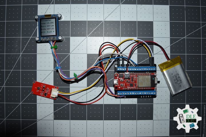

Hardware Components
  • SparkFun Thing Plus - ESP32 WROOM
    SparkFun
    X 1
  • Adafruit SHARP Memory Display Breakout - 1.3" 168x144 Monochrome
    Adafruit
    X 1
  • Crowtail - BMP180 Barometer
    Elecrow
    X 1 fenxiang
  • Terminal Block Breakout FeatherWing
    Adafruit
    X 1
  • Lithium Ion Battery - 1000mAh
    DFRobot
    X 1
  • Micro USB Cable
    DFRobot
    X 1

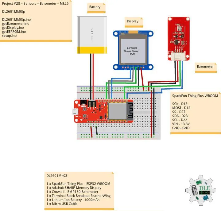

DL2601Mk03
1 x SparkFun Thing Plus - ESP32 WROOM
1 x Adafruit SHARP Memory Display
1 x Crowtail - BMP180 Barometer
1 x Terminal Block Breakout FeatherWing
1 x Micro USB Cable
DL2601Mk03p
DL2601Mk03p.ino
getBarometer.ino
getDisplay.ino
getEEPROM.ino
setup.ino
