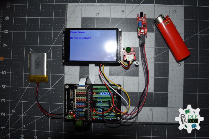

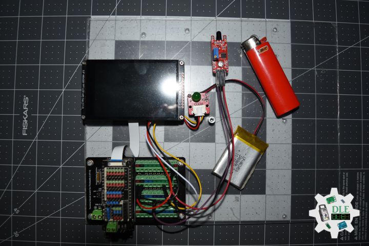

Flame Sensor
To prevent causalities or damages, it is necessary to detect the fire, so that warnings can be provided and even automatic fire suppression systems can be activated. There are multiple ways to detect a fire, like detecting temperature change, smoke detection, etc. In all of these, detecting temperature change would be more accurate, since some fires won’t even have detectable smoke. Even the temperature measurement is not too dependable since sometimes it’s too late when the change is detected. To overcome this, we can detect the thermal radiation instead of the temperature variation. The easiest and cheapest way to detect thermal radiation is to use a flame sensor.

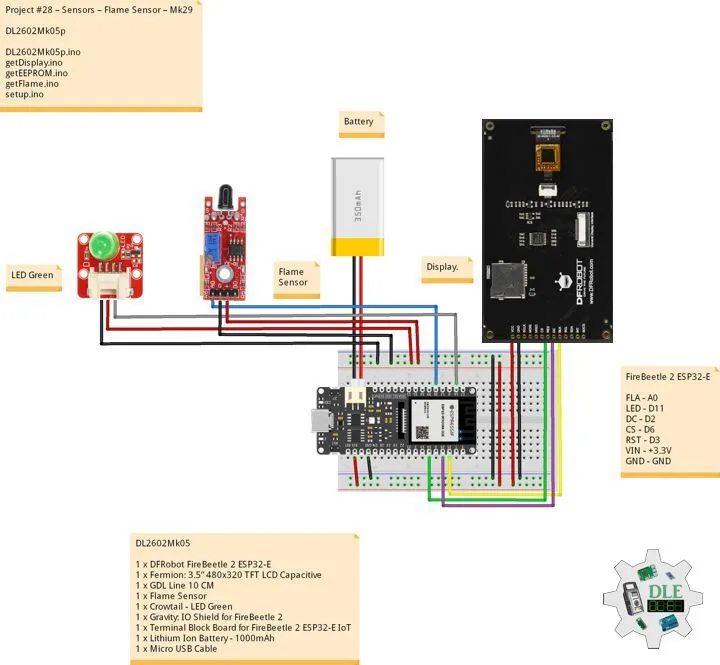

DL2602Mk05
1 x DFRobot FireBeetle 2 ESP32-E
1 x Fermion: 3.5” 480x320 TFT LCD Capacitive
1 x GDL Line 10 CM
1 x Flame Sensor
1 x Crowtail - LED Green
1 x Gravity: IO Shield for FireBeetle 2
1 x Terminal Block Board for FireBeetle 2 ESP32-E IoT
1 x USB 3.0 to Type-C Cable
DL2602Mk05p
DL2602Mk05p.ino
getDisplay.ino
getEEPROM.ino
getFlame.ino
setup.ino
