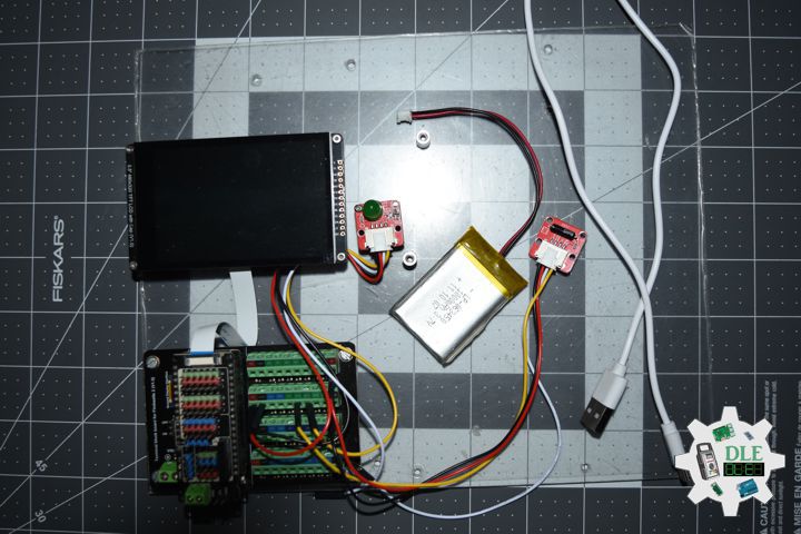

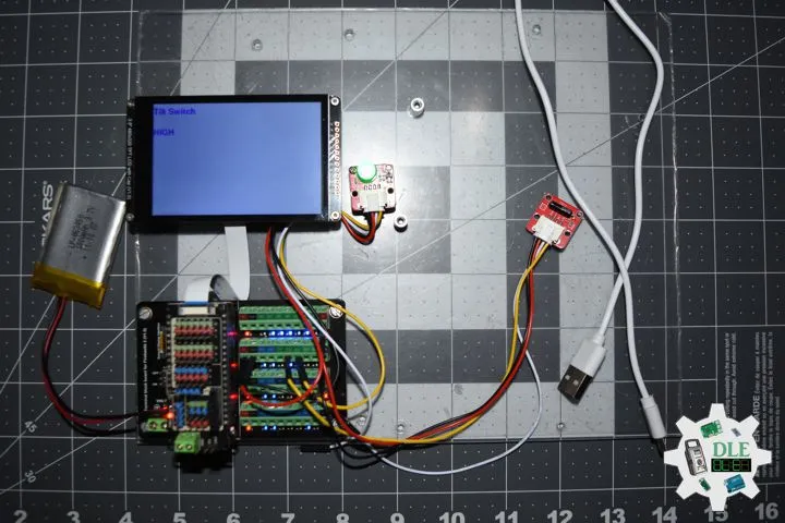

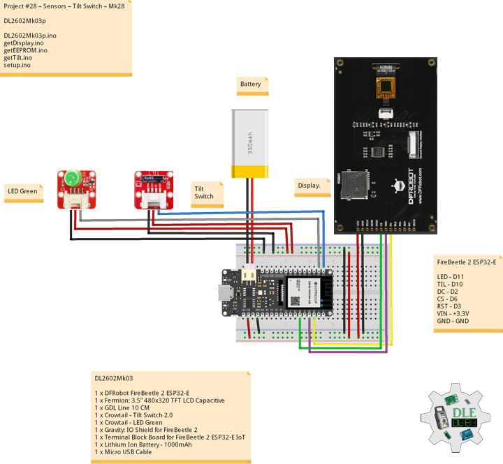

Crowtail - Tilt Switch 2.0
The Crowtail -  Tilt Switch is a sensor to detect the station of forwards. It outputs logic LOW in the Horizontal direction and logic HIHG in the vertical direction. Inside the tilt, switch is a pair of balls that make contact with the pins when in the case of vertical. Tilt the case over and the balls don't touch, thus not making a connection.
DL2602Mk03
1 x DFRobot FireBeetle 2 ESP32-E
1 x Fermion: 3.5” 480x320 TFT LCD Capacitive
1 x GDL Line 10 CM
1 x Crowtail - Tilt Switch 2.0
1 x Crowtail - LED Green
1 x Gravity: IO Shield for FireBeetle 2
1 x Terminal Block Board for FireBeetle 2 ESP32-E IoT
1 x USB 3.0 to Type-C Cable
DL2602Mk03p
DL2602Mk03p.ino
getDisplay.ino
getEEPROM.ino
getTilt.ino
setup.ino

Schematic and Layout
Project #28 – Sensors – Tilt Switch – Mk28
