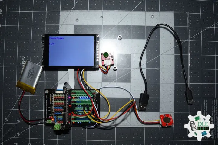

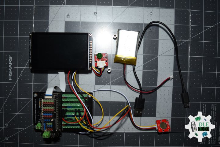

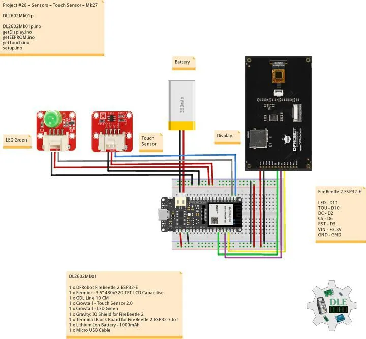

Crowtail - Touch Sensor 2.0
The touch sensor can detect the human touch by sensing the change of capacitance. Based on the touch IC TTP223-B, this module can detect a human finger in 0~3MM, that is, you can place this sensor under a non-metallic surface such as the glass or paper, with a thickness less than 3MM, this would be useful for applications that waterproof is needed, or you want to make the buttons secret.
DL2602Mk01
1 x DFRobot FireBeetle 2 ESP32-E
1 x Fermion: 3.5” 480x320 TFT LCD Capacitive
1 x GDL Line 10 CM
1 x Crowtail - Touch Sensor 2.0
1 x Crowtail - LED Green
1 x Gravity: IO Shield for FireBeetle 2
1 x Terminal Block Board for FireBeetle 2 ESP32-E IoT
1 x USB 3.0 to Type-C Cable
DL2602Mk01p
DL2602Mk01p.ino
getDisplay.ino
getEEPROM.ino
getTouch.ino
setup.ino
