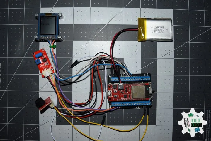

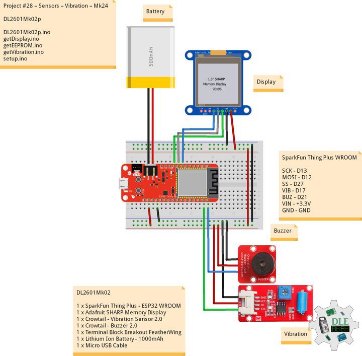

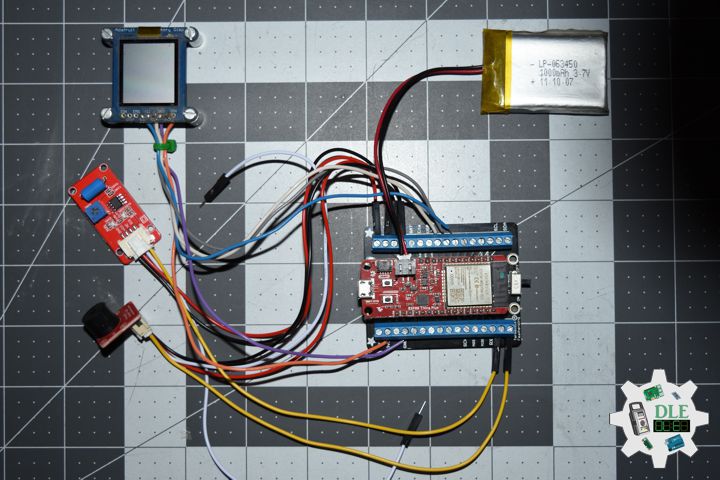

Crowtail - Vibration Sensor 2.0
The Crowtail - Vibration Sensor is Used to trigger the effect of various vibration with Normally closed type vibration sensor SW - 420. It is widely used to reported the theft alarm, intelligent car, earthquake alarm, motorcycle alarm, etc. This module is compared with the normally open type vibration sensor module, vibration trigger for longer periods of time, can drive the relay module .
Crowtail - Buzzer 2.0
The buzzer module is for making sound in your project. It sounds when activated by a logic HIGH signal. The buzzer module can be also connected to an analog pluse-width modulation (PWM) output to generate various of tones.
DL2601Mk02
1 x SparkFun Thing Plus - ESP32 WROOM
1 x Adafruit SHARP Memory Display
1 x Crowtail - Vibration Sensor 2.0
1 x Crowtail - Buzzer 2.0
1 x Terminal Block Breakout FeatherWing
1 x Micro USB Cable
DL2601Mk02p
DL2601Mk02p.ino
getDisplay.ino
getEEPROM.ino
getVibration.ino
setup.ino
