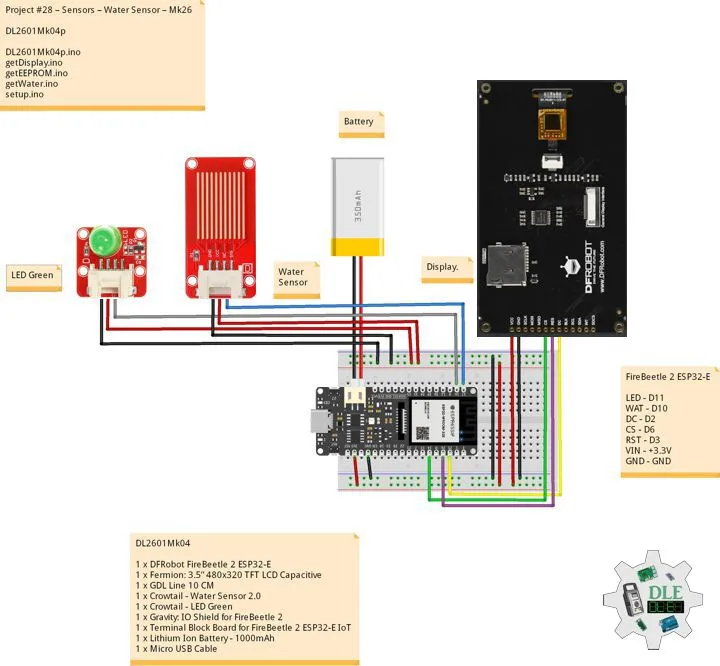

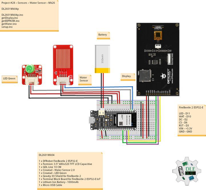

Crowtail - Water Sensor 2.0
The water sensor detects the presence of water using a series of exposed, grounded traces, including the sensor traces. These traces have a weak pull-up resistance of 1 M?. This resistance will raise the value of the sensor trace until a drop of water causes a short circuit between the sensor trace and the grounded trace. The amount of water-induced contact between the grounded and sensor traces can be detected using the digital I/O pins.
DL2601Mk04
1 x DFRobot FireBeetle 2 ESP32-E
1 x Fermion: 3.5” 480x320 TFT LCD Capacitive
1 x GDL Line 10 CM
1 x Crowtail - Water Sensor 2.0
1 x Crowtail - LED Green
1 x Gravity: IO Shield for FireBeetle 2
1 x Terminal Block Board for FireBeetle 2 ESP32-E IoT
1 x USB 3.0 to Type-C Cable
DL2601Mk04p
DL2601Mk04p.ino
getDisplay.ino
getEEPROM.ino
getWater.ino
setup.ino

Schematic and Layout
Project #28 – Sensors – Water Sensor – Mk26
