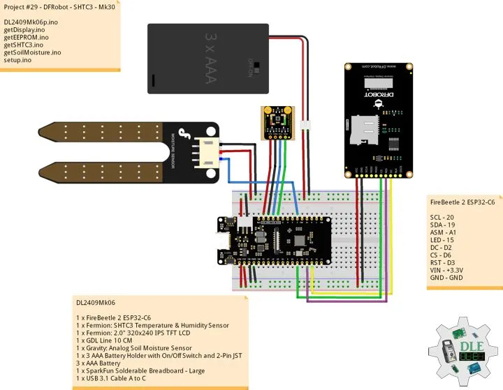

FireBeetle 2 ESP32-C6
SCL - 20
SDA - 19
ASM - A1
LED - 15
DC - D2
CS - D6
RST - D3
VIN - +3.3V
GND - GND
