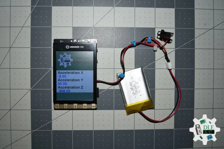

Triaxial Acceleration Sensor(SC7A20H)
The SC7A20 is an acceleration sensor IC, which features abundant functions, low power dissipation, small size, and precision measurement. It communicates with MCU through I²C/SPI interface, the acceleration measurement data can be accessed in interrupt mode or inquiry mode. INT1 and INT2 provide many auto-detected interrupt signals which are suitable to many motion detection fields, interrupt source include 6D/4D direction detection interrupt signal, free fall detection interrupt signal, sleep and wake up detection interrupt signal, and single/double click detection interrupt signal. A high-precision calibration module is available within the IC to accurately compensate the senor’s offset error and gain error. It has dynamically user selectable full scales of ±2G / ±4G / ±8G / ±16G and it is capable of measuring accelerations with output data rates from 1Hz to 400Hz.

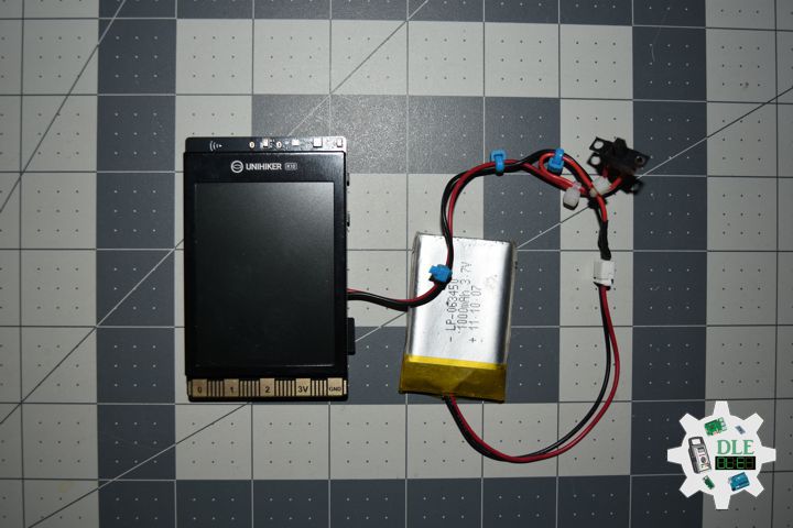

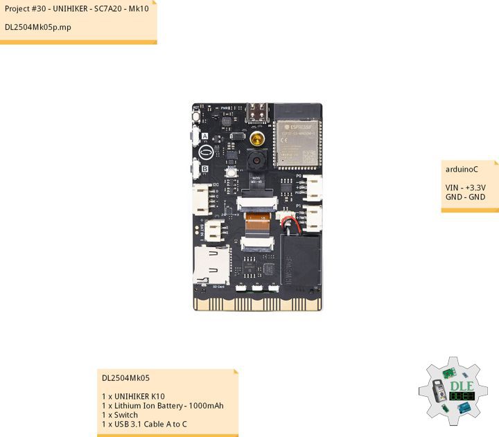

DL2504Mk05
1 x UNIHIKER K10
1 x Switch
1 x USB 3.1 Cable A to C
DL2504Mk05p
DL2504Mk05p.mp
