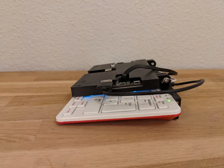

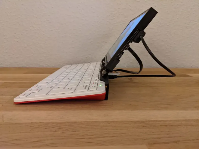

This project aims to give the option to attach a monitor bracket to the Raspberry Pi 400 without any modification to the Pi400.
I've found that the Kensington lock insert on the right side (viewed from the rear) will take a M3 screw inserted at an angle and give a good grip.
Step 1:

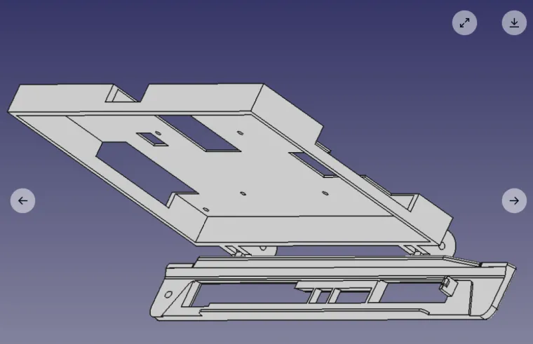

Slice and print the STL files.
Step 2:
Mount the display in the display casing using screws
Step 3:
Mount the rear bracket to the Pi400 using a long M3 screw to the Kensington lock hole
Step 4:
Join the hinges of the two printed parts using 25mm M3 screws and the wing nuts.
Adjust the screws with optional washers to maintain the hinge friction you prefer.
