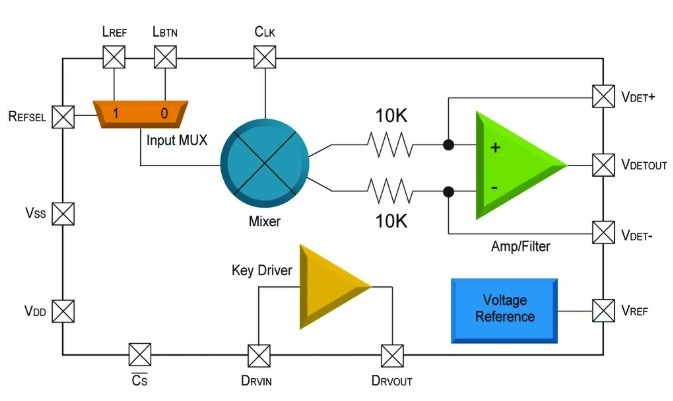

The idea was promoted long ago in the journal Funkamateur by Dr. Martin Ossmann and entitled "Circuit for Inductive Sensors as a Receiver Front End". While its primary purpose is measuring tiny changes in coil inductance for touch interfaces, its internal architecture—containing a high-frequency driver, multiplexer, mixer and synchronous detector—allows it to function as a low-frequency RF front end.

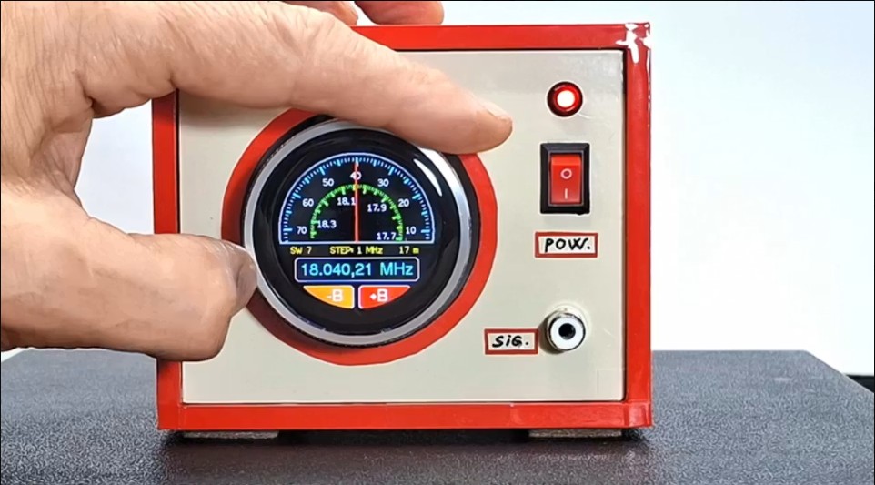

We only need a few passive components and an external oscillator to select the desired frequency. For this purpose, I use my VFO with a 1.28 inch circular display, the construction of which is described in one of my previous videos .

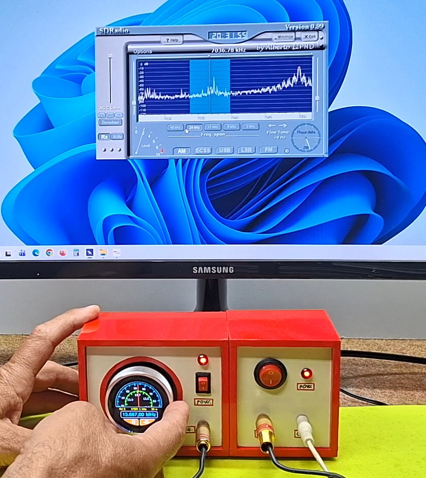

Otherwise, the output signal can be fed directly to an audio amplifier, thus obtaining a standalone direct conversion receiver. However, in the described way, I use this circuit as a front end of an SDR radio, and in this way, with PC software, can be performed demodulation of many different types of analog and digital radio signals.

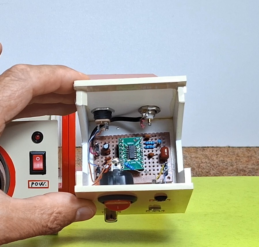

  Here is what the finished device looks like.

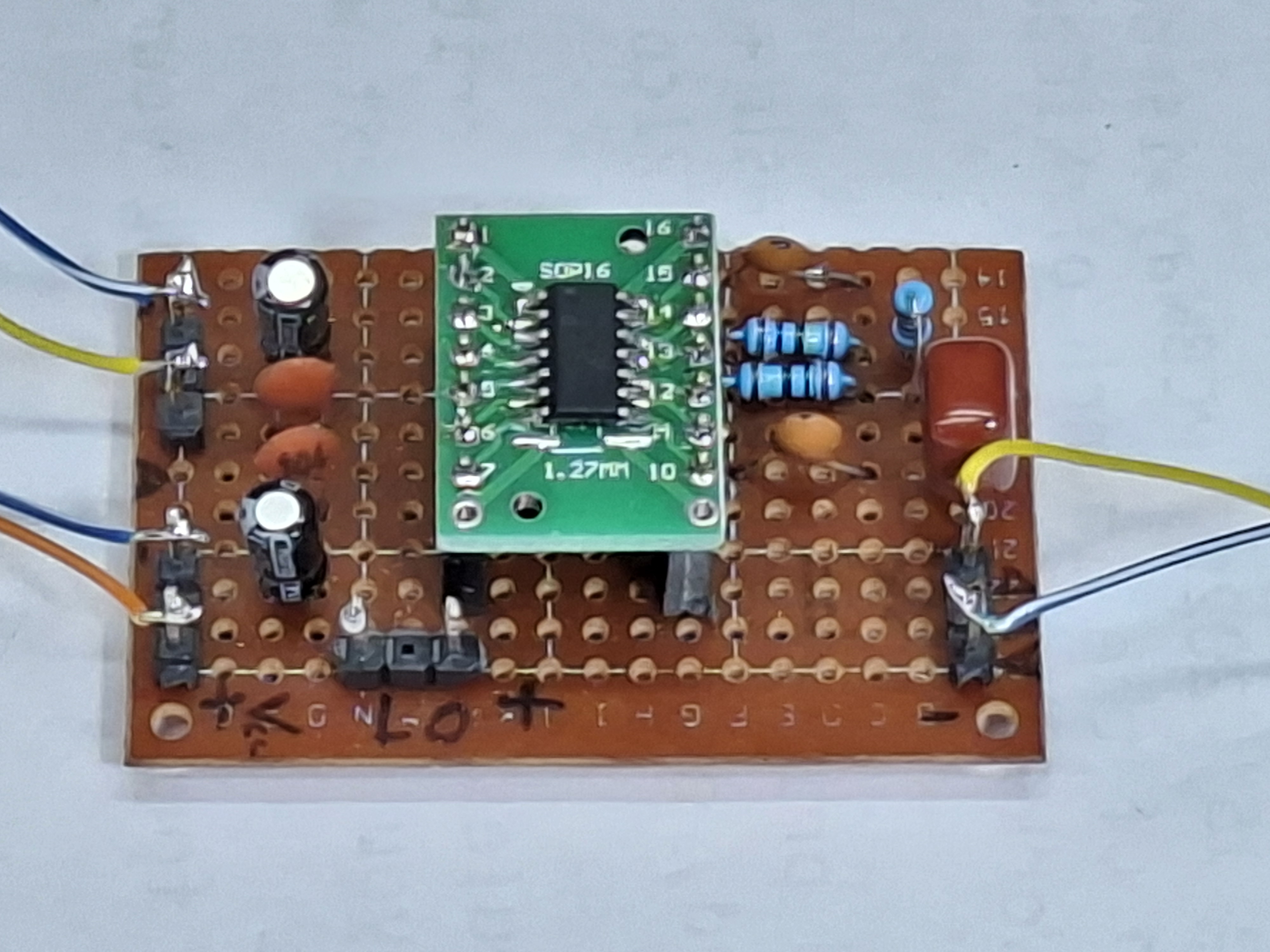

I mistakenly got an mcp2036 chip in a SOIC package, otherwise it is much simpler to make it with a chip in a DIP package. Here is the antenna connector, the VFO signal input, and the audio output. The other device is a Variable Frequency Oscillator.
  Now let's see how this SDR radio works in real conditions. For reception I will use my long wire antenna mounted on the roof of the house.
And finally a short conclusion. In this project I demonstrate an extremely simple Direct Conversion SDR Receiver based on the Microchip MCP2036 IC. With only a handful of passive components and an external VFO, this unusual circuit becomes a surprisingly capable SDR front-end covering frequencies up to approximately 10–15 MHz. The receiver is tested on several HF amateur and shortwave broadcast bands using SDR software running on a PC. Despite the simplicity of the circuit, the results are impressive and make this a fascinating experiment for every radio electronics enthusiast.
